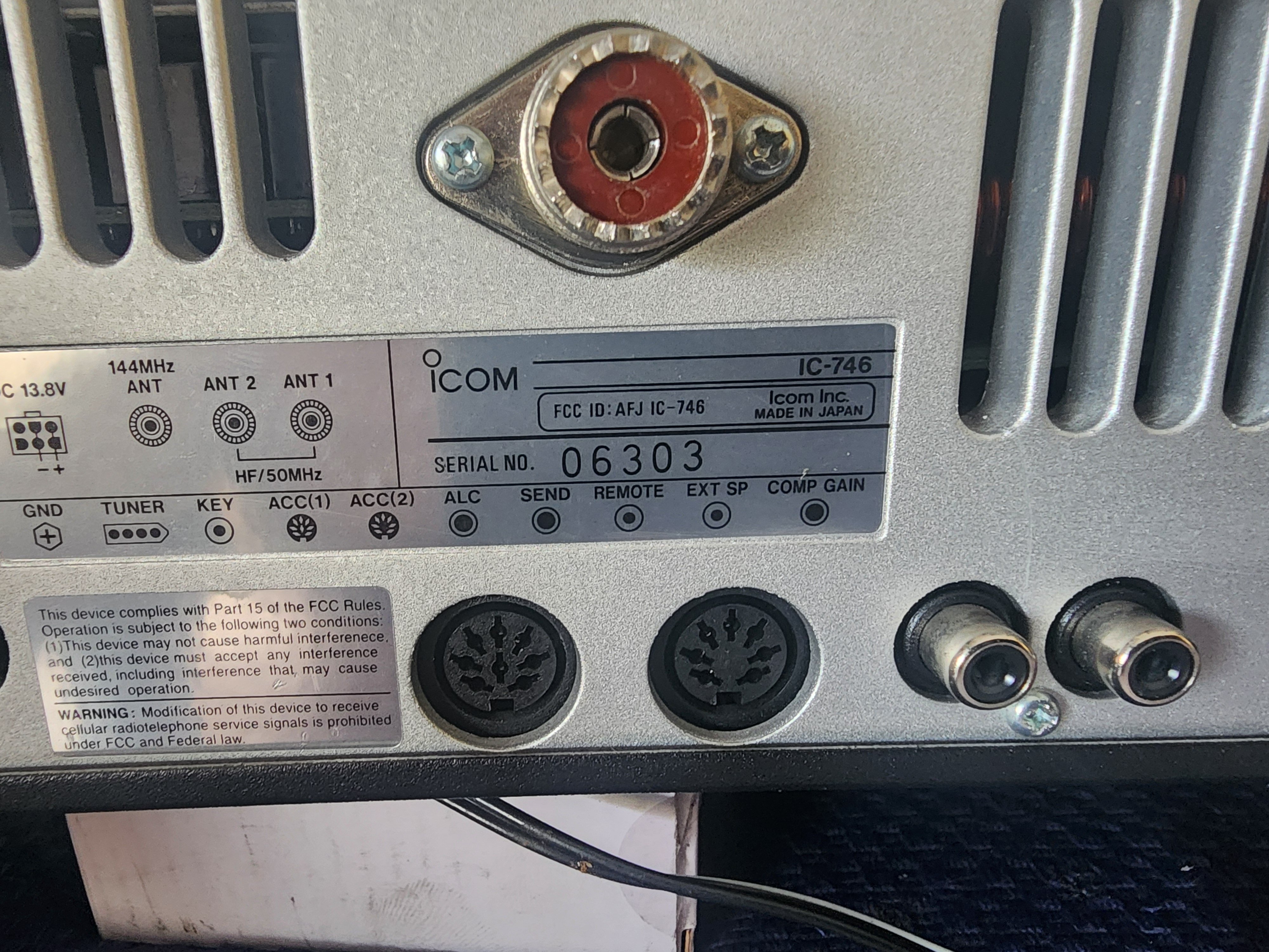

I'm picking up an Ameritron AL-811H, and I'm using an Icom IC-746 nonpro if I don't use the alc port, can i use the send RCA from the radio to amp relay port to key the amp ?? or would i need a foot switch for the amp

The radio's 'send' jack on the rear should be compatible with Ameritron amplifiers. The schematic shows a relay in the radio connected to the send jack. You should be good to go with just a patch cord with a RCA plug on each end.
Oddly enough the owner's manual fails to mention any limits on what you may switch using the send jack.
Yes i found a heavy-duty 90-degree RCA cable it's working radio is keying the amp thanks for the replies

Being of different brands has nothing to do with it. An Icom radio can key a Kenwood amp. A Kenwood radio can key a Yaesu amp. A foot switch is required when the radio does not have a send port such as when using an 11m radio with a ham amp. Some older tube type amps require either a slight mod or the use of a foot switch because the voltage/current required to key them is beyond the capabilities of the relay in the driving radio.

This is not the case. Send is nothing more than a key line to ground, when the radio is in TX. It is not brand specific. The only thing of concern, is the keying voltage of the amps T/R relay, which may exceed the T/R relay or send circuit of the radio, which s why there are amplifier buffers.
