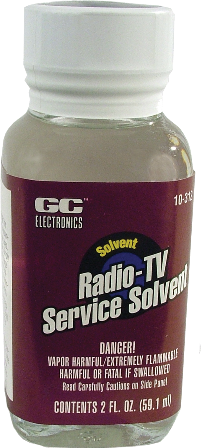

if it has a similar viscosity to dried liquid nails, (really hard almost like plastic) then it is the same "sonybond" material that has always been used in home electronics.
this is the stuff you need in order to remove it:
drip some of this stuff on to the glue and let it sit for a minute or so.
you will begin to be able to pick it off of parts once it gets gooey again.
be careful with this stuff or it will knock you out from the fumes.
also, it evaporates VERY quickly so be sure to keep the lid on tight.

Just came in today. No testing done on it yet, I spent my time doing up the fancy picture. The glue seems to have a similar consistency like commercial hot glue. I do have some GC solvent that I have used on HR2510 glue. We'll see how it works on Icom glue.
