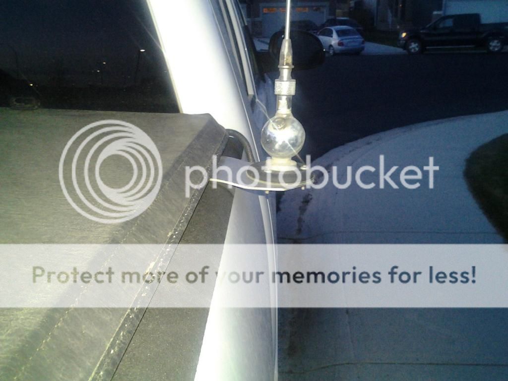

I have the 4foot Firestick going into a heavy duty mag mount with a spring between the mag and the antenna. Is there really that much of a difference between the Wilson and a Firestik?

I bought this Firestik at a local Truckstop and on the packaging it said it was rated to 1000 watts in big orange letters.
* Checked the receipt....its a Firestik II FS Series 1000 Watt 5/8 Wave Mobile Antenna.
