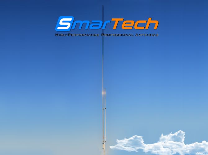

Drifter, I can't tell for sure, but that J-pole matching connection looks pretty conventional...a bit above the base IMO. Does not look like a gamma, if that is what you're suggesting.
The J-Pole looks to use some smart, effective brackets to Isolate the antenna form the mast however...and I like that feature.

it does have the coax shield connected to the long leg and its tapped up the stub at an elevated voltage point,
i see nothing smart about this j-pole,
its probably the worst of the commonly seen methods of building & feeding a j-pole,
their jazzy models would likely not look great if they included the coax tapped up the stub with braid connected to the long leg, even if the mast is isolated on plastic stauff clamps.

I’ll either continue making my own or I’ll buy from a time tested manufacture that takes pride in taking a few quality photos. This particular antenna is only interesting from a detective’s point of view, many potential buyers will shy away from their shoddy presentation. IMO they’re either deliberately trying to hide pertinent construction details or they need to at least find someone that isn’t so inept at taking photos.

Here is more details on the SmarTech J-pole.
https://www.antennas27.com/vertical-jpole
Reactions: Drifter
BK, here is my J-Pole over a Perfect Earth Ground that produces a similar pattern as SmarTech shows in the link I posted for them above. I maked their poor image with a big "X".
