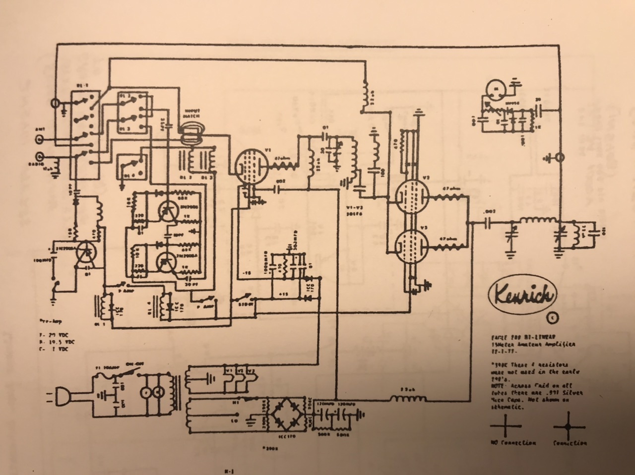

I'm pretty sure all of the Kenrich brand of amplifiers are a 2 driving 5 configuration. I have a bad copy of the Eagle 200 schematic that is drawn as a 1 driving 2 with a note that states it is actually a 2 driving 5 configuration. Never had one across my bench though. The bad schematic is very similar to the link below on the Eagle 500. Looks like the power supply is a bit different though(not as many rectifiers, not as many bleeders, etc). You may can get what you need from the link below.
http://www.cbtricks.com/Amp/kenrich/eagle_500/graphics/eagle_500_sch.pdf
I may could try to post a pic of the bad 200 schematic later.

Sometimes later never comes. Thought it best to do it now.
Here you go.
David
That's is a huge help. I'm restoring this one and need to know what diodes it uses. The ones in the amp are corroded and I can't see the markings.

The Eagle 500 schematic shows the rectifiers to be ICC-170's. I believe that is also what the Eagle 200 schematic shows.
I recently restored an Eagle 500 for a friend and used 1N5408 diodes in it. I did have to enlarge the holes through the circuit board with a pin vise drill to allow the larger legs to pass through. The 1N5408's can be had for cheap and was a "no brainer".

They are 2N2905A according to the Eagle 500. As best as I can tell the Eagle 200 schematic shows the same.
I used the metal (TO-19 or TO-39 type-I believe it is) since they guy that owns the one I worked on could not quite understand that it was built for a 4 watt drive. I believe the metal type is a bit
stronger/tougher/ more robust.
