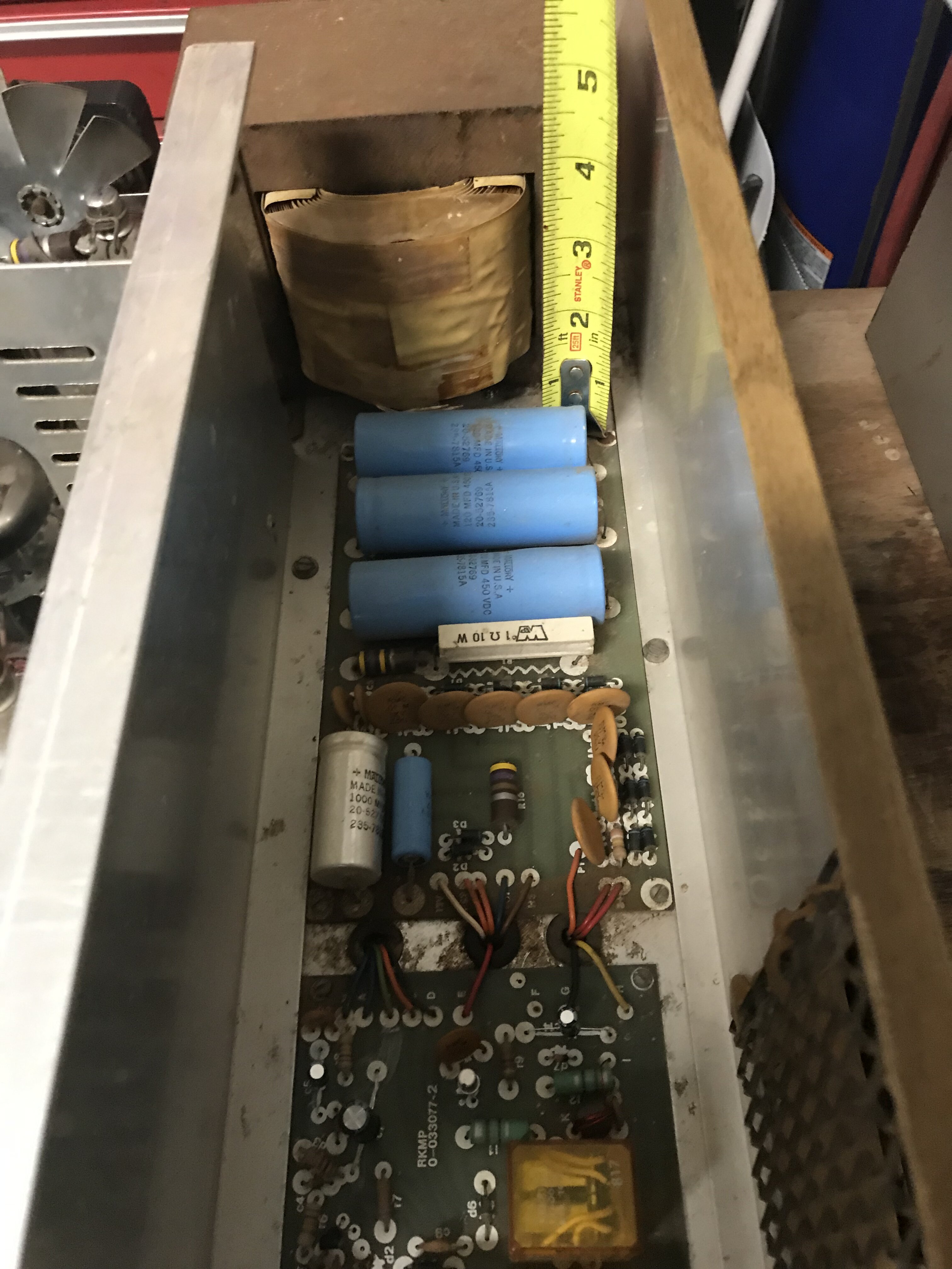

I have not been as diligent about taking pictures on this one as the others but nevertheless progress has been made. The Owner had previously purchased a "Refurb" kit from an online auction site and delivered the amplifier to a local CB shop for repair (same shop that had the Kris 600 SSB for 6 months). Anyway, the CB shop replaced 3 transistors in the amplifier and pronounced it done returning the amp and the unused parts of the kit to the owner. I can't recall if he said it ever worked when he got it back or not.
Below are a few pictures of how I received the amp.

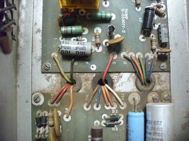

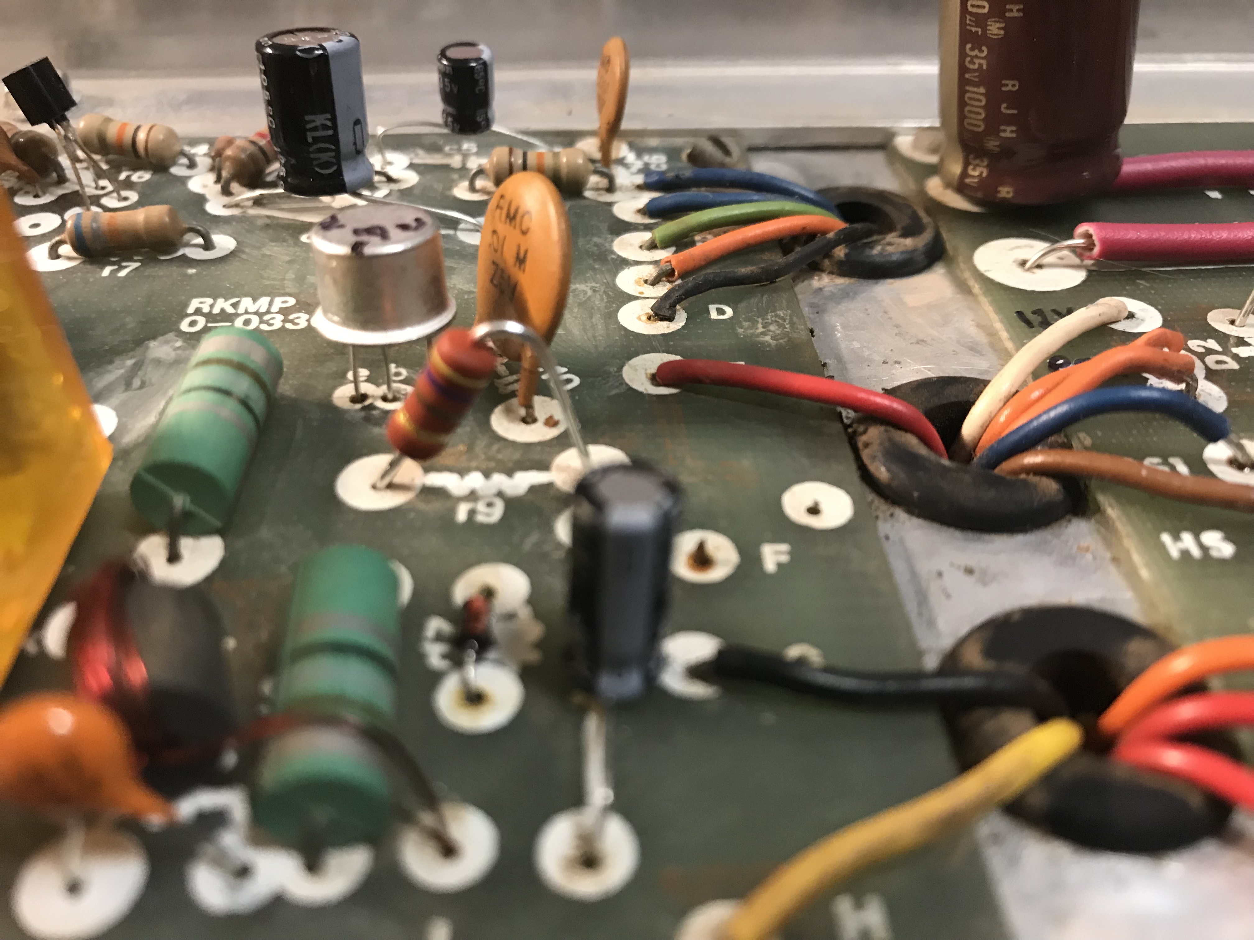

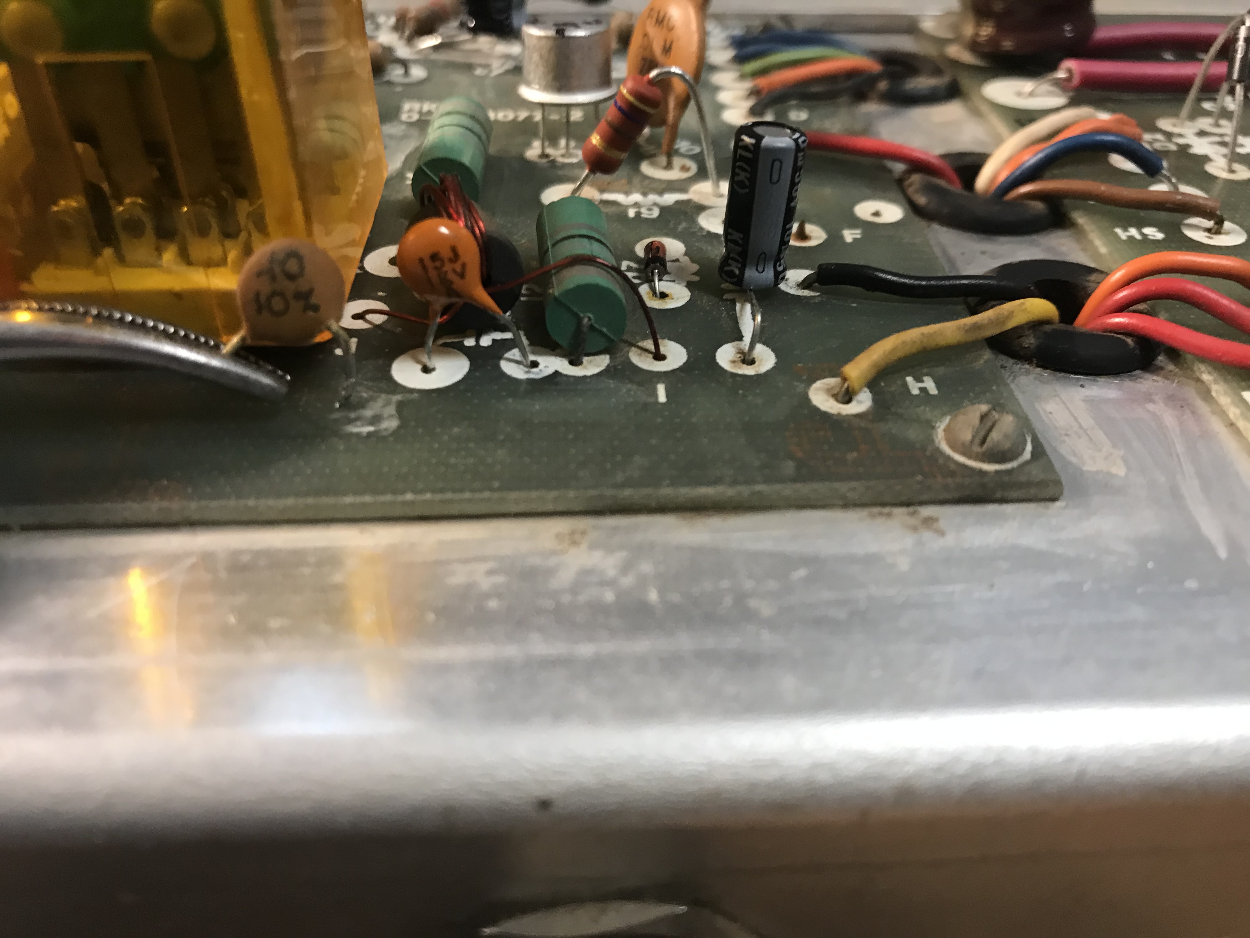

First the relay board with the 3 new transistors. (New but not adequate for the job in my opinion)
Parts of the Power supply board and the relay board. (Looks like original electrolytics to me)

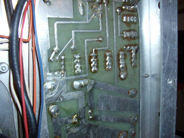

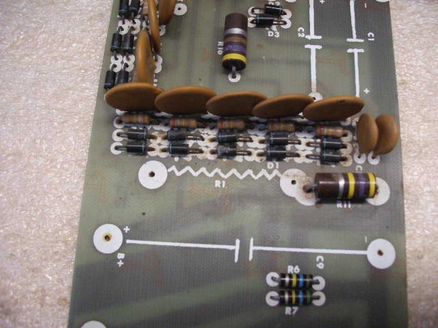

Below is a shot of the underside of the power supply board. Lots of crusty 40 year old flux present. I started cleaning off some of the flux on the left side of the board at this point.
Due to all the crustiness of the flux, I found it much easier to remove the entire board to finish this task.

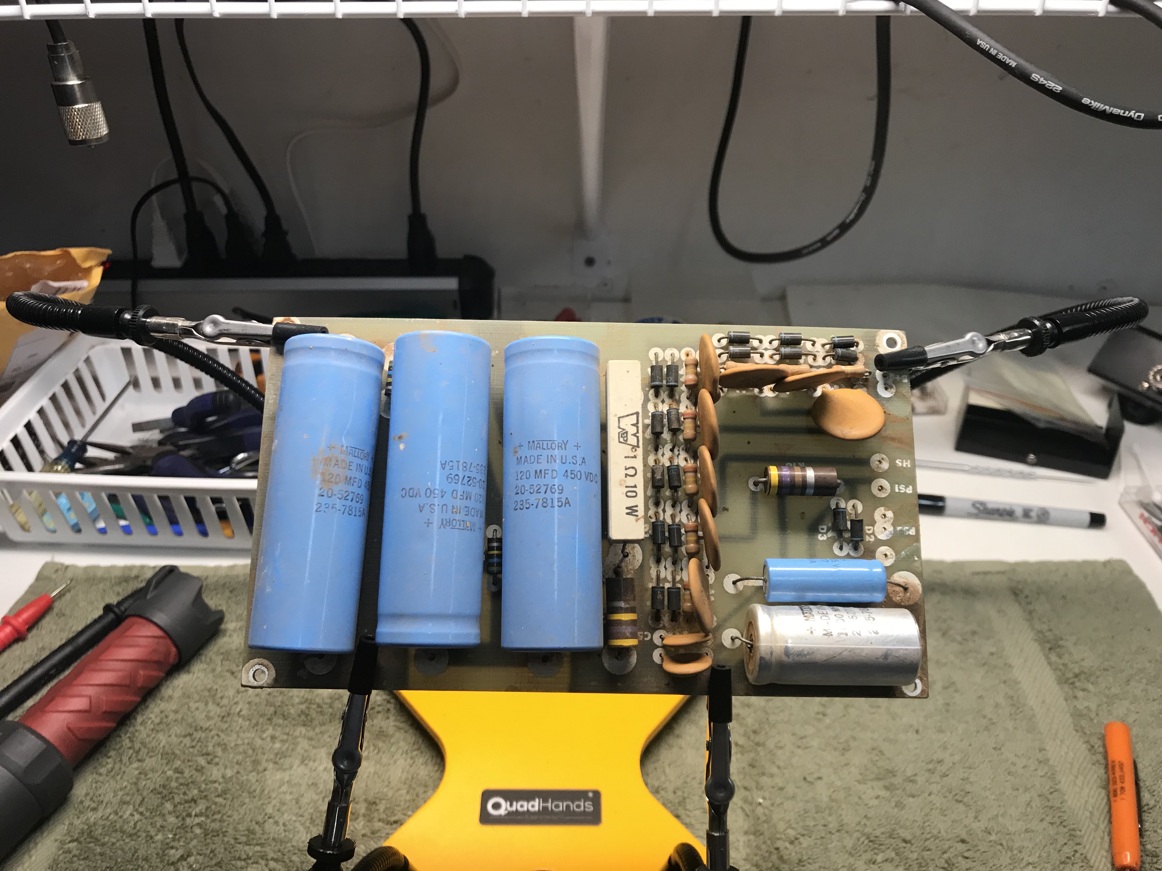

In this shot, I have removed the old electrolytics since there are new ones in the "Refurb" kit.
The original rectifiers are still on the board. They are ICC170's. I don't believe they are made anymore. The "Refurb" kit came with 8 new diodes. I'm wondering how the "Assembler" of the "Refurb" kit would decide which of the 16 diodes to replace and which to leave in the board? I know what I will do to solve this!

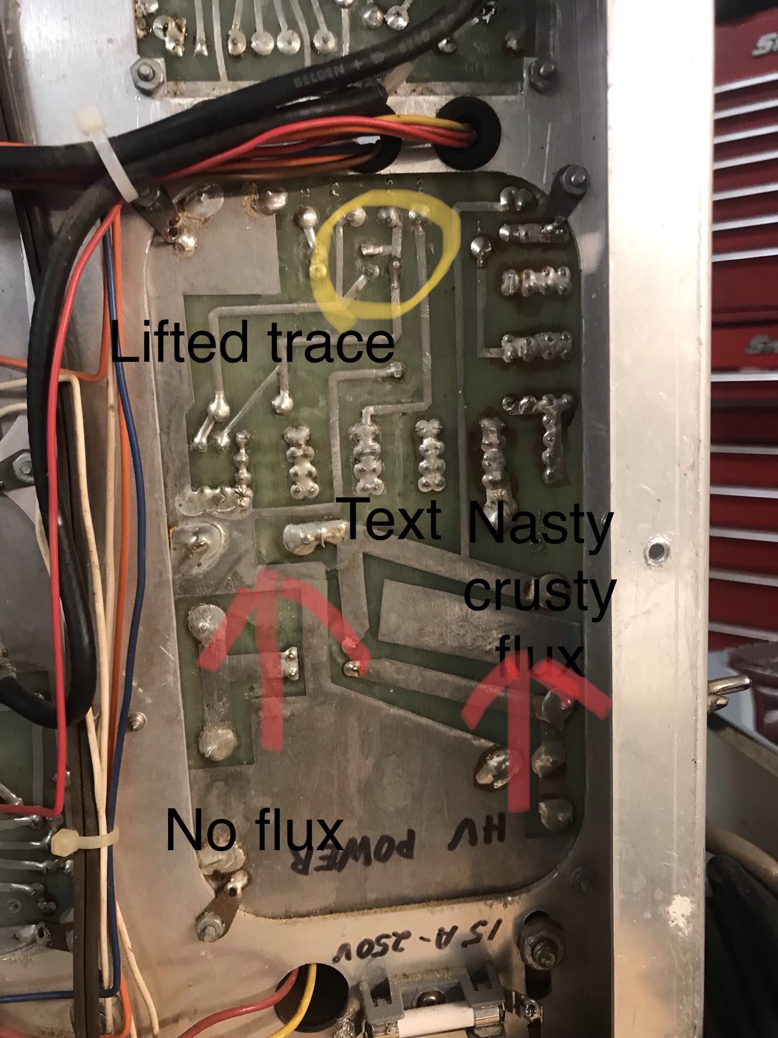

Below is a lifted trace on the 12vdc circuit. I believe this to a major factor in this unit not keying.
Top side of the rectifier/filter board before. The tape measure was me deciding weather or not to pull the board or struggle working in a cramped space.

Below is similar to 1 of the pictures already posted but shows more of the complete HV circuit board. May be a help to those that may have one of these amps with lifted or burned traces.

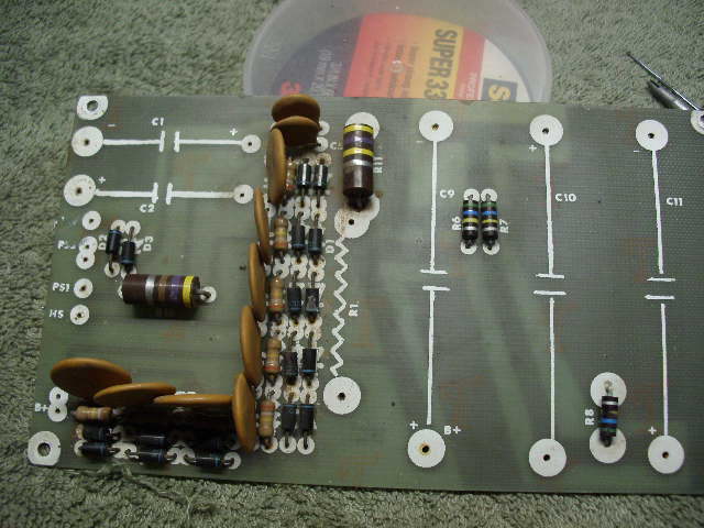

Filter/Rectifier board removed ready for re-work.
Old parts removed ready for new parts.
Back side of Filter/Rectifier board cleared of old caps, diodes and resistors.

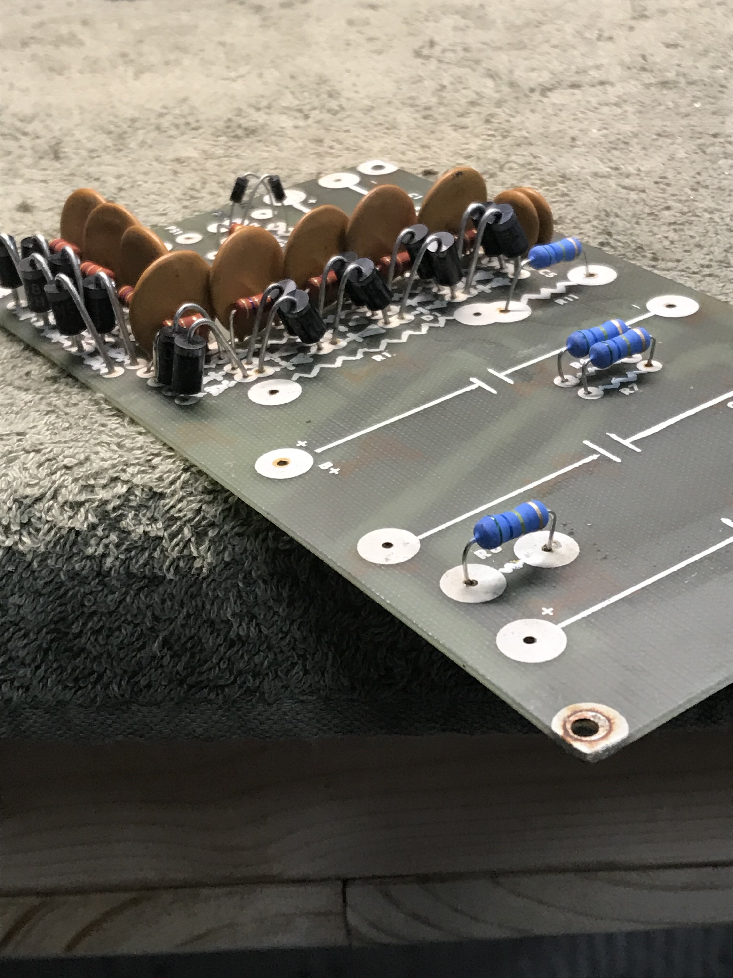

16 new 1N5408 diodes installed as well as new bleeder/equalizer resistors. The circuit board lead holes for the rectifiers had to be “reamed” with a pin vise drill as the 1N5408 leads are pretty chunky compared to the original ICC170’s. The diodes were too big to lay down flat on the board as well. My thoughts are that if there is some air between components and the circuit board they may run a little cooler.
New radial leaded caps installed. (From the “Refurb” kit) A drop of hot glue holds them down to the board. Also replaced were the diodes for the 12v circuit. I believe I used 1N4007’s here.(not included in the “Refurb” kit)

Below is the rebuilt rectifier/filter board installed back in the chassis.
A little badly needed cleaning of the chassis took place while the board was out.

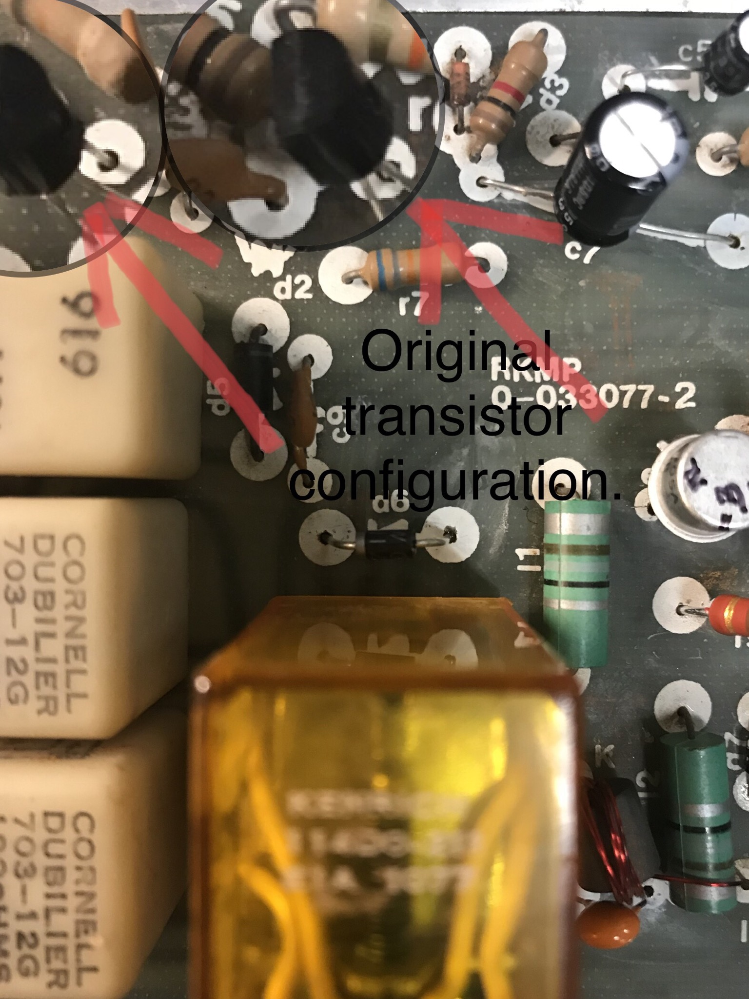

Next up the relay board was looked at for bad connections and sketchy work. I replaced the keying transistor with a 2N2905A metal type. Should hold up much better than the small plastic 2N2907 that was previously installed. The electrolytic capacitors on the relay board were replaced as well.
For good measure I replaced the 10pF RF “sniffer” cap and the suppression diodes across the relay coil with 1N914’s.

First a complete shot of the underside of the circuit boards.
Next the bottom of the tube sockets.
Below is the bottom of the relay board.

The keying circuit was working fine but when turning on the Preamp, the receive signal disappeared completely. Since the Preamp transistors were previously replaced, that is where I focused my inspection.
Below is how I received the amp.
The picture below shows the correct orientation of the Preamp transistors.
So after removing, testing and reinstalling the transistors, the Preamp worked as advertised. There is certainly controversy over the use of a Preamp but since it is part of the original circuit, I felt obliged to make it work.

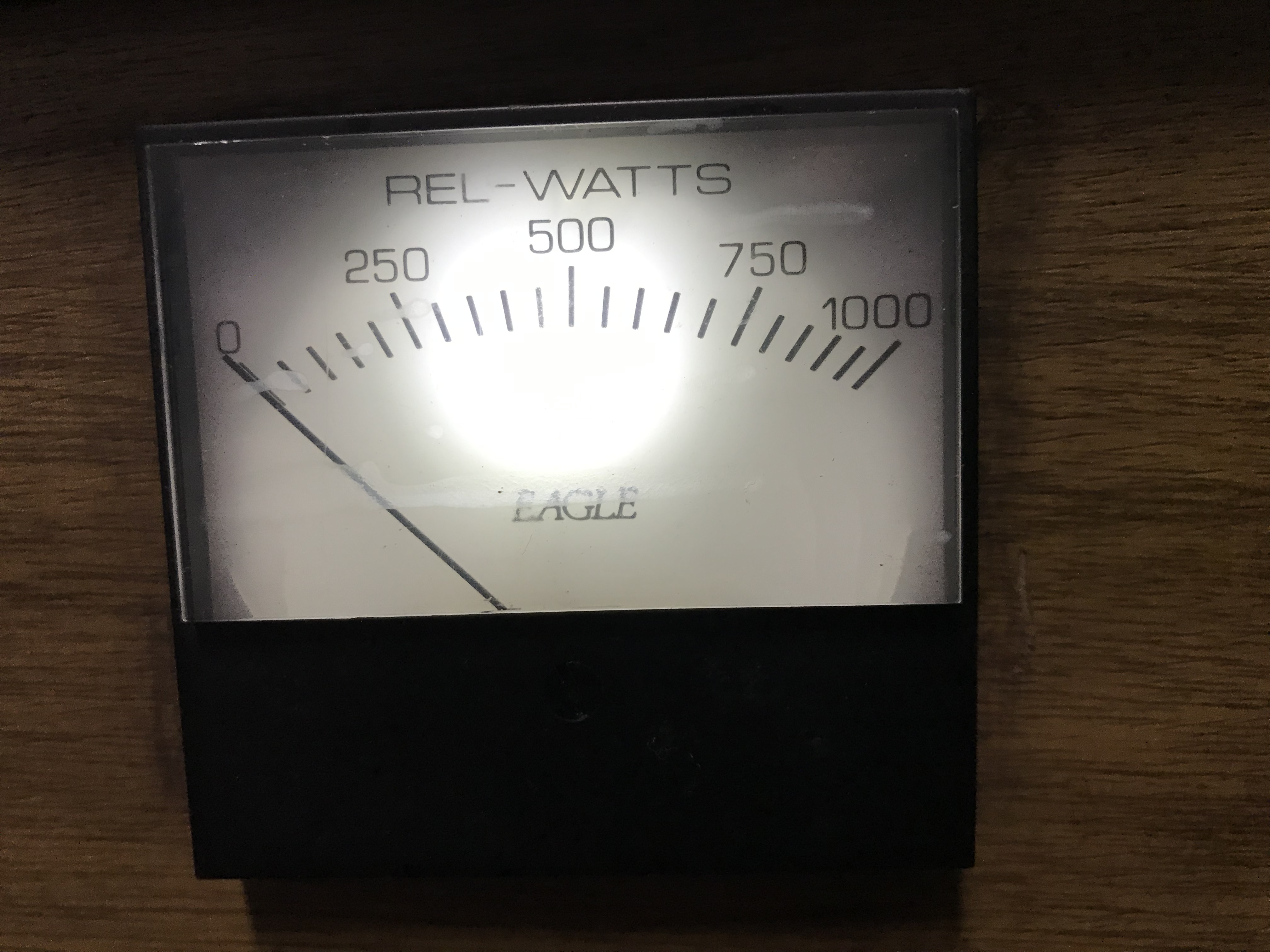

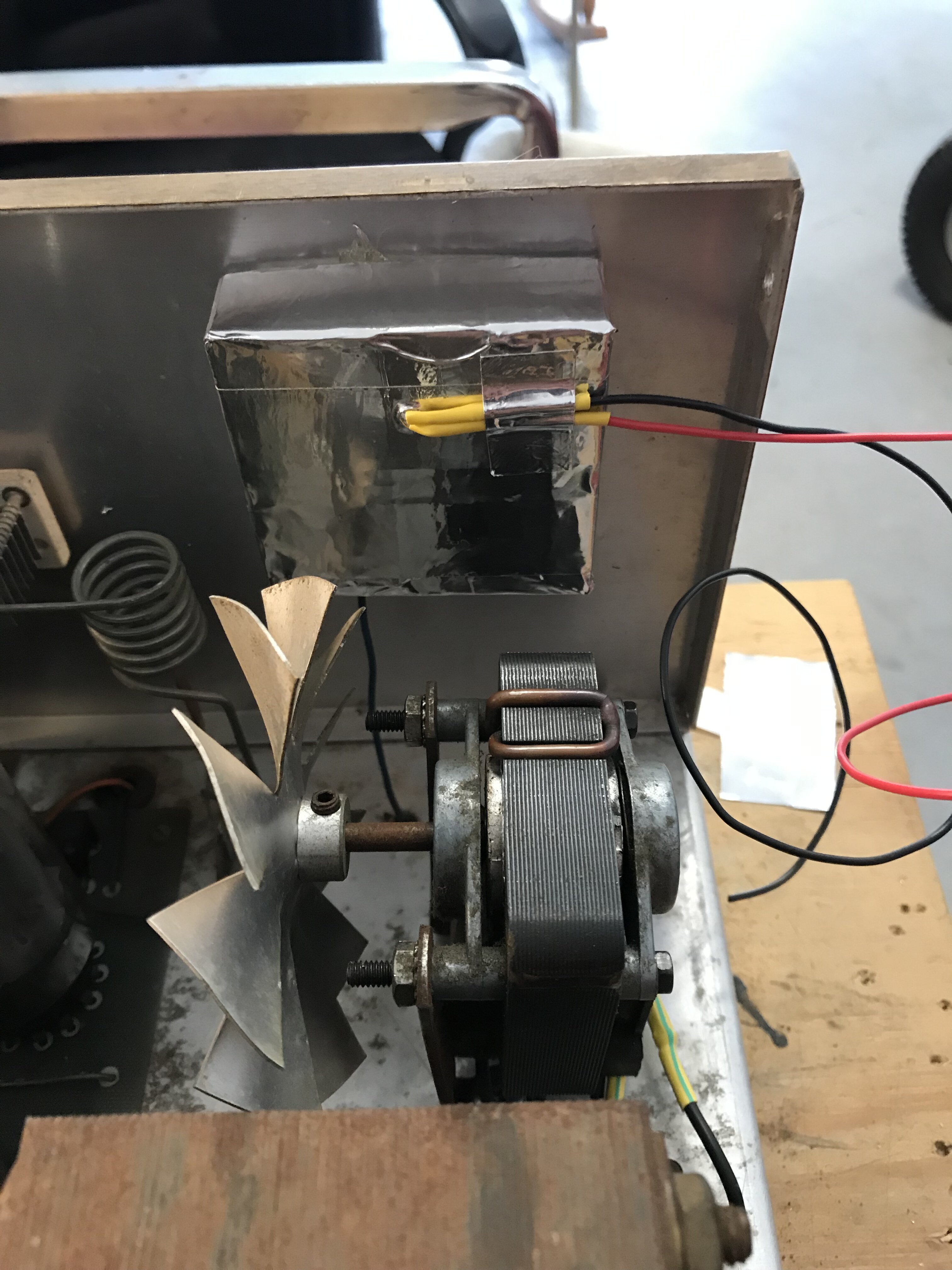

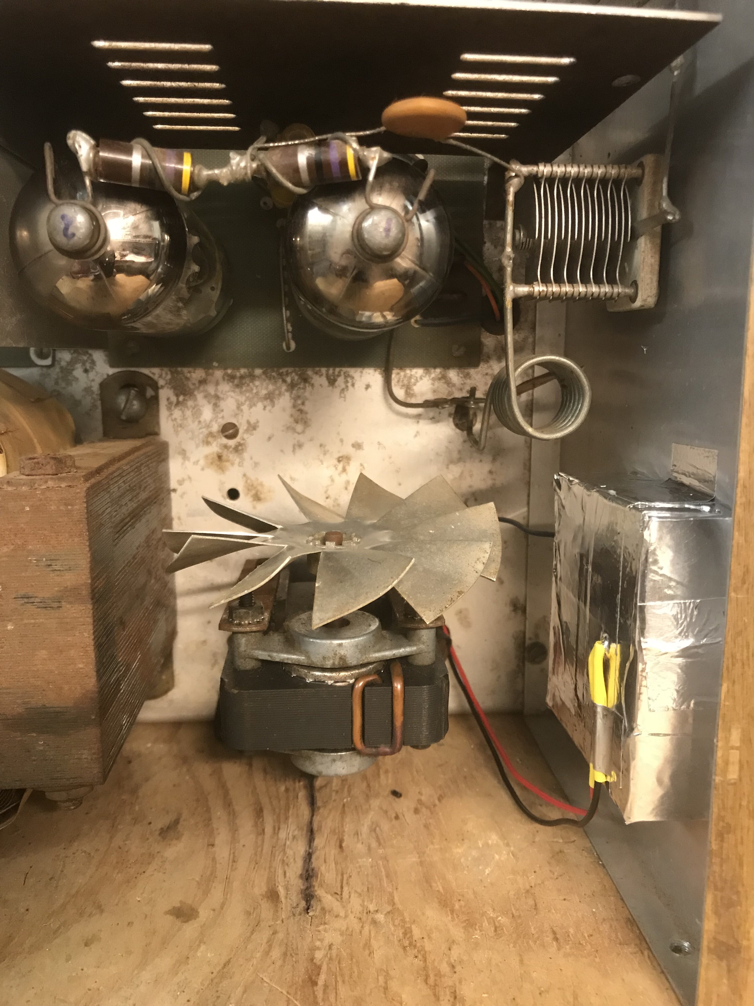

So after testing this power house for a week or so, it is time to send it back to its owner. I had one more thing I wanted to do to it and the owner consented. The meter in this amp is large, clear and works well for relative output but in dim light it is hard for me to see. I wanted to put an LED behind it and tie it to the operate/stand by switch as an indicator the amp is ready to go.
The LED needed an enclosure to focus the light behind the meter so I made one.
The LED is wired to the operate/Stand by switch and a dropping resistor added to supply the LED with 2.5vdc.
The picture below is somewhat brighter than the light in person and I had to try a few different angles with the camera to capture the light where the meter is still legible. It is really not as bright as it appears in the photo.
And finally a few pictures of the finished product.
Below picture during testing.
A picture of the final section.
And a picture of the driver section.
