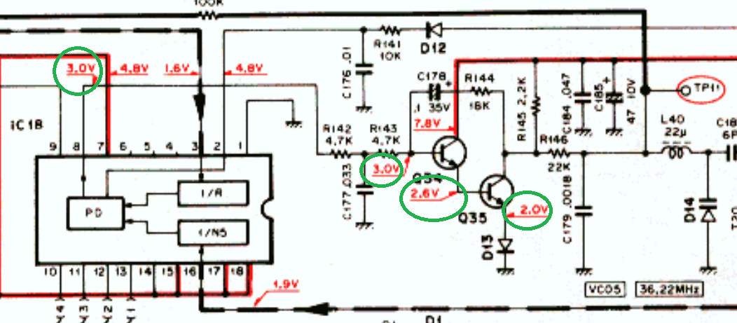

If TP11 is at 7.8v, it means that Q35 is not pulling it down. This can be caused by a bad PLL (check for 3v on pin 8 of IC18), a bad emitter follower (Q34), a bad inverter (Q35) or a blown level-adjusting diode (D13). I assume D13 is a 3-diode package like the KB363 because of the 2v across it.
Check these voltages, they will narrow down the issue.
I don't think you need to be messing around with the VCO/JFET side of C187. The problem is almost certainly to the left of that since your varactor control voltage is wrong. You can see if the oscillator is at least working. If it is working, even at the wrong frequency, it hints that the problem is elsewhere.
Edit: thinking about it more, since the control loop is broken (wrong frequency), these circled voltages may be different, but the levels between them will still hint at a problem so report those voltages whatever they may be, We care about junction voltage drops, not the service manual voltages.

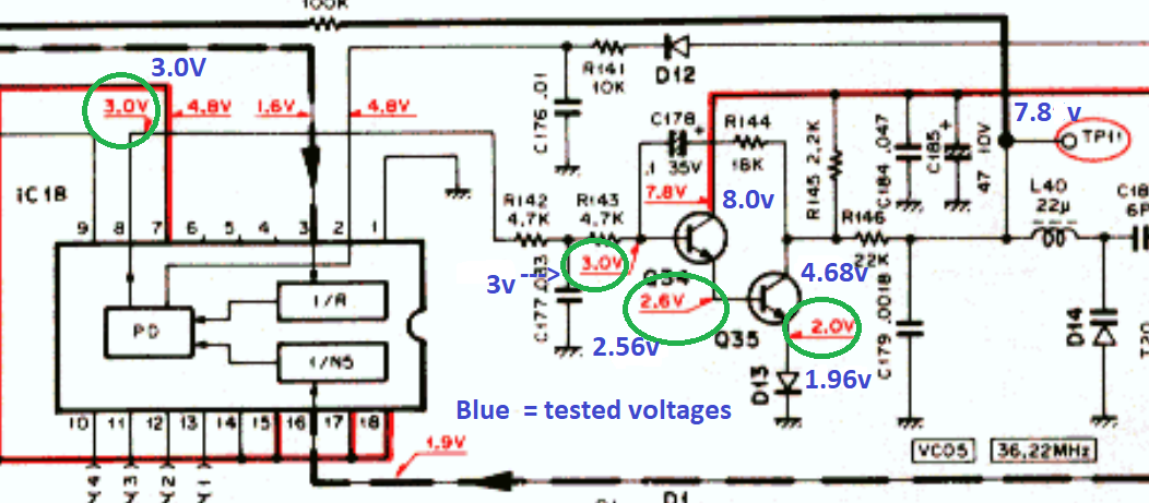

Thanks Brandon for that post - awesome detail for me trying to learn this stuff - appreciate it as always!. I put my measurements in blue back on the diagram below:
I just rechecked, definitely getting 4.8v on the collector of Q35 (2sc2459 middle pin) as per the diagram.
Tomorrow I'll get a chance to test Q34 out of circuit.
Forgot to mention, I think your right re: D13, it has a high forward voltage (~1.9) when I tested it out of circuit (OK) while soldering a new leg back on one side that had been corroded.
If TP11 has 7.8v and the collector of Q35 is only 4.8v (3v across R146), there has to be a solder bridge somewhere.
3v across R146 is 0.13666mA. The current flowing in R146 has to go somewhere. If it goes toward the VCO, it encounters two ceramic caps and should get blocked, If it goes up toward TP11 and across R147, it encounters an electrolytic cap (actually, two).
Considering it would take .00013666*100k=13.64v across R147 to account for that current (which would add to the 7.8 and be higher than the supply voltage, I think we can rule out the electrolytic caps being a source of voltage.
It is very likely that you have a solder bridge somewhere between Q34s collector trace and the trace of TP11. Inspect the area carefully.

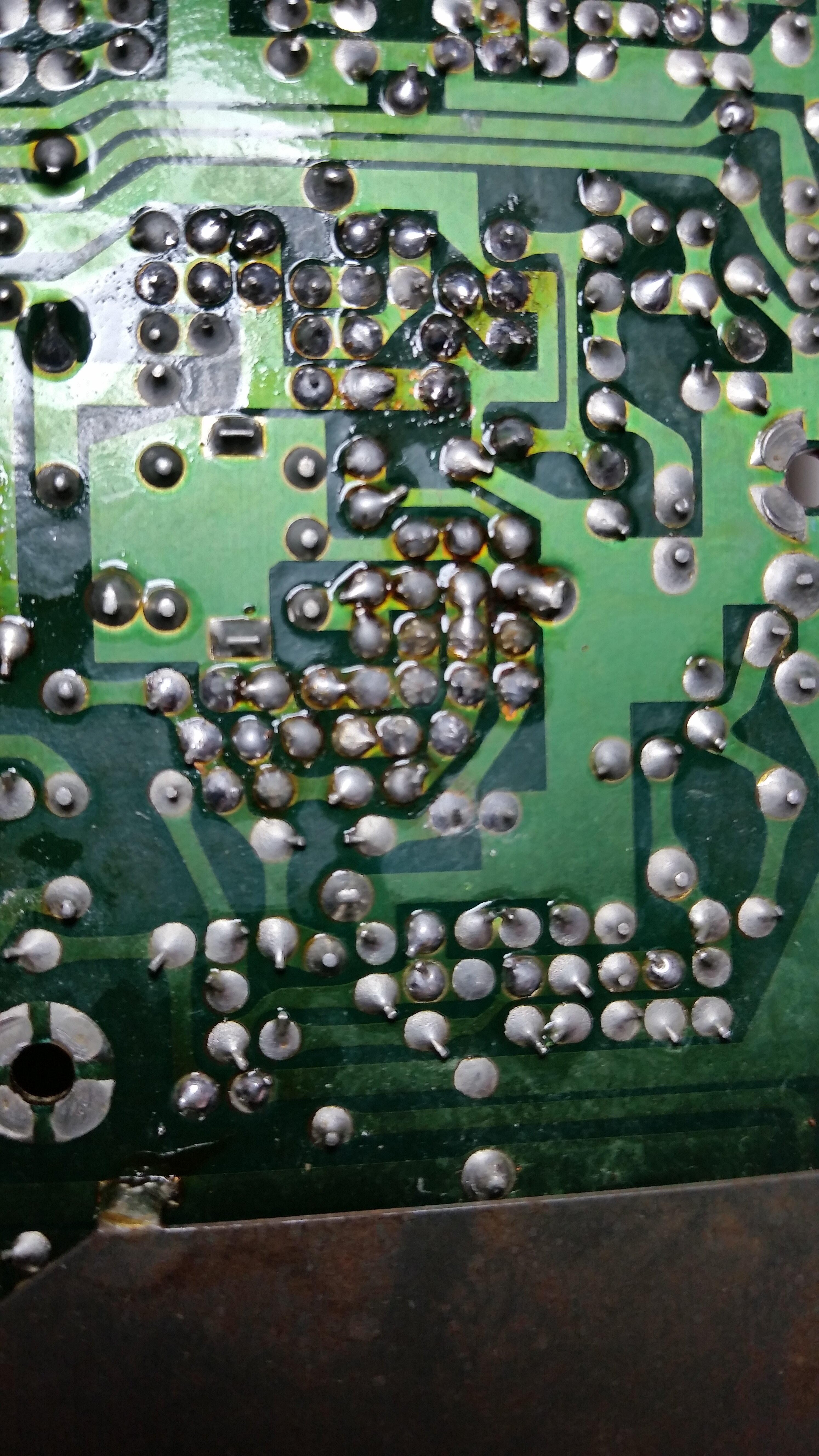

Inspected Q34,Q35, TP11 traces think I found really small bridge (half diameter of hair) on Q35 trace that I removed.
Decided to resolder all joints in VCO 5 entirely as R146 and few other solder joints looked average under 30x loupe. This was me removing all solder from previous owners work. I'm really confident there are no bridges now.
Result, still getting the 7.8v on TP11, only thing changed is Q35 base voltage looks closer to 2.6v (was 3v now 2.56v) and collector of Q35 from 4.8v to 4.68v (Got worse!).
Updated diagram below after resolder. I really am lost (does not take much as a beginner..) to what could do this - I checked the resistors in the area all test OK. I wonder if c178 tantalum or something is weird.

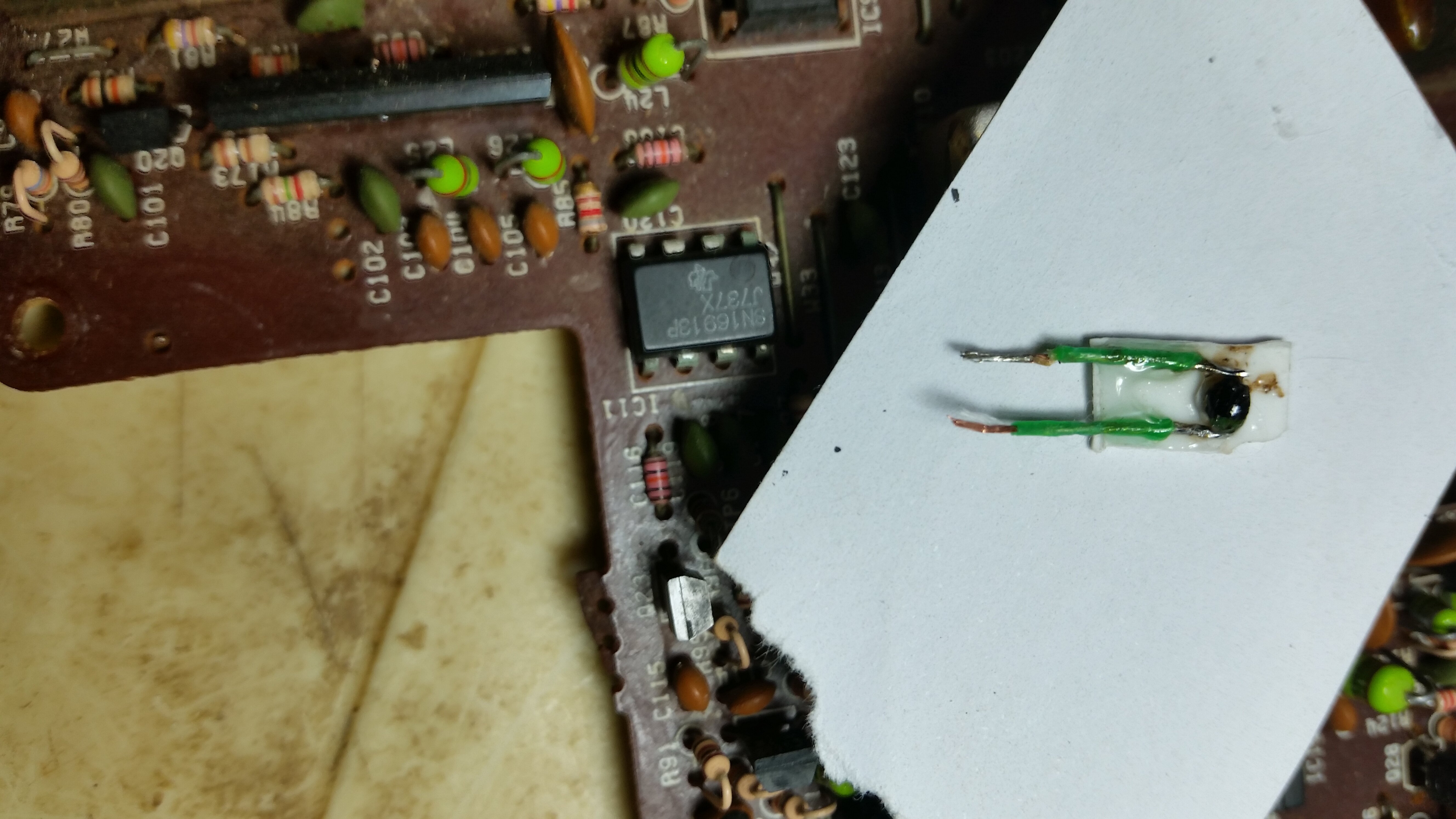

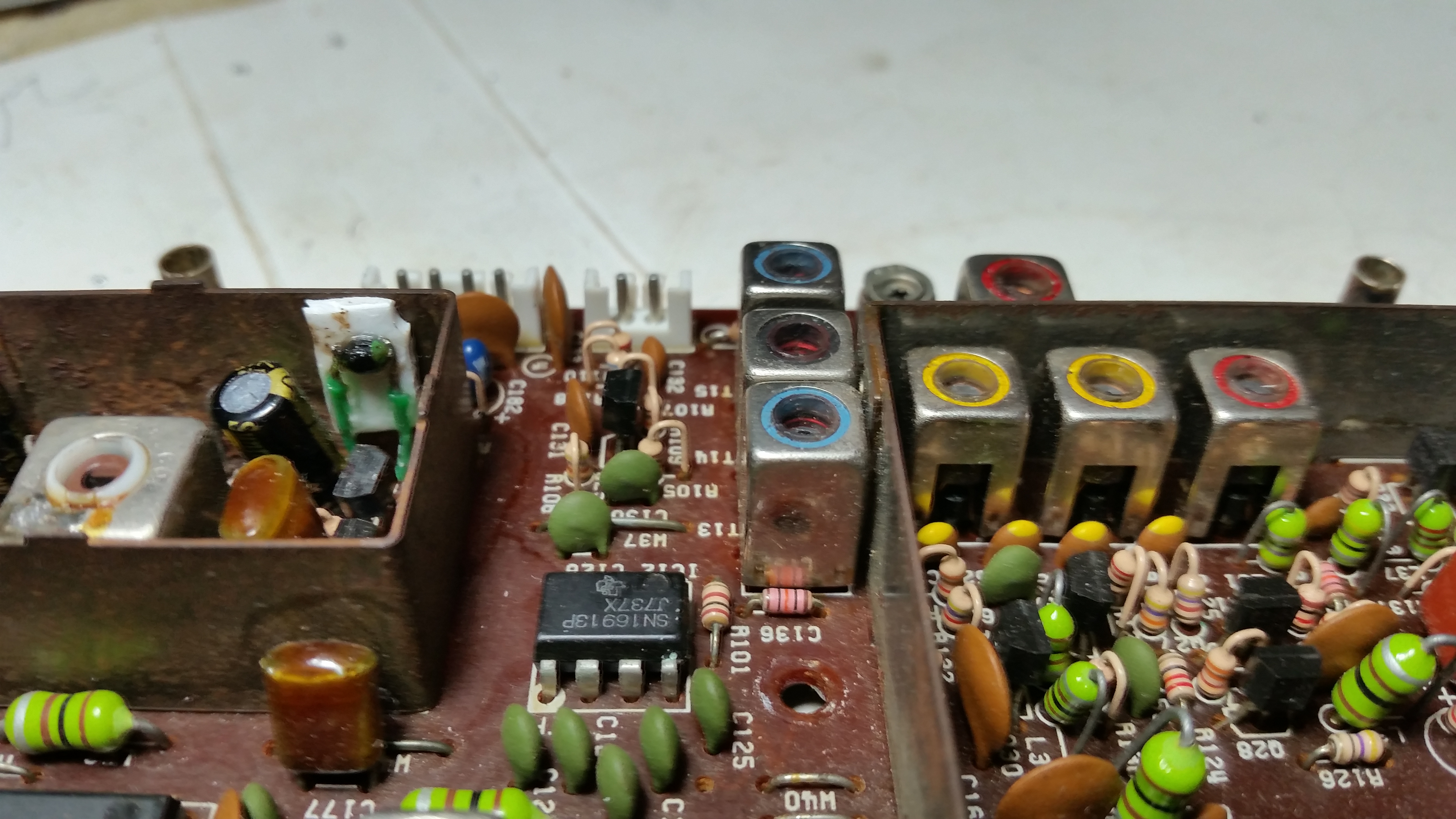

Had to rebuild D13 as other leg fell off (check pics below - stuck on a loaf of bread tag!!), rebuild was a stop gap measure as I need to find a MV203 substitute. It was a nightmare...
Assuming there is no bridge in that area, I'd check D13. I suspect that if Q35 isn't conducting, the bias from the Q34 collector would appear on TP11, more or less as you've described. Checking to see if D13 is open could explain the issue, provided there isn't a bridge.

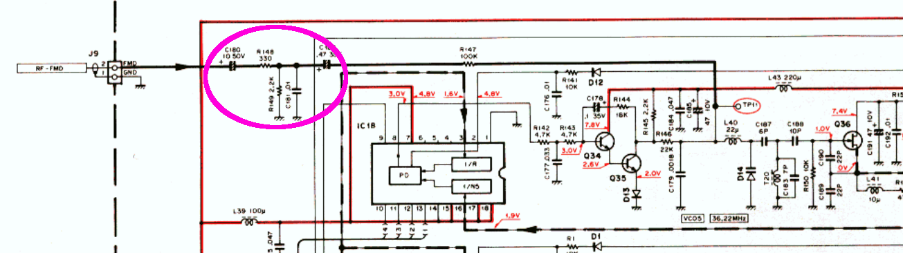

After looking your pictures over, especially the trace side of the re-flow work you did. You have not noticed a few parts in that area that have not been printed in the schematic ..... on page 73 of the service manual.
You need to go to page 72 of the X-ray view of that same area, find tank T20
(surrounded by a square) located about half-way down the page and the area you want is surrounded by a rectangle.
For ease of viewing both pages, I have two copies of the service manual open on my computer; one for page 72 zoomed in to T20 area, one for page 73 zoomed in to the IC18 to T20 area.
From page 72; items R147, R148, R149, C180, C181, C182, and from there C180 goes to a harness connection that says "FMD" of the x-ray view ..... are all plainly missing from the schematic on page 73, but shown just outside the boxed in area (just like C179) of the T20 circuit rectangle of the x-ray view, all being part of the TP11 test point circuit.
Since the x-ray view, of page 72, is looking down at your component side of the radio, the trace side is a mirror view of the picture you posted of the bottom area of your radio. To your right of your picture, it can be seen that those parts are in your radio. How they play a part with your problem, I couldn't say, but you may want to first disconnect the FMD harness connection to see if it helps, then test C180 and C182, or follow the FMD harness.
This is what you have missed because of the schematic not showing it ............. it happens a lot. I hope it helps you fix the problem and grow your hair back.
73 and good luck...........

The parts you think are missing from the schematic are right here. We don't need to consider them because there would need to be roughly 20v at these parts for the 136uA of current to flow through R147.
Reactions: Ghetto

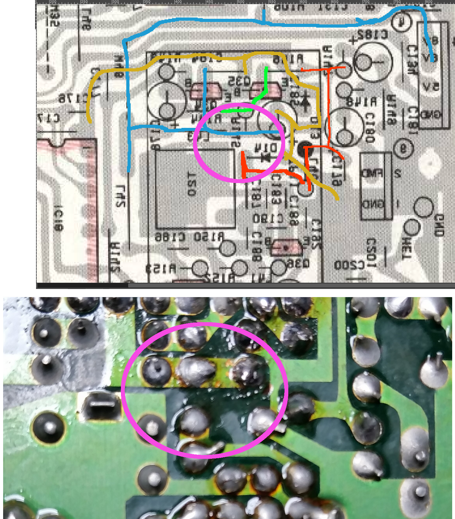

I flipped the xray view to match your picture and traced out where TP11 is (in red) and where the 7.8v source is (in blue). Any solder bridge would need to connect red and blue. Since they only get close in one spot and I see no bridge there, I am left to suspect that thick amount of flux circled in pink. Clean that off (clean the whole thing) and test it again. Green was what you measured at 4.8v and orange is ground.

They were right in front of me the entire time and I didn't see them in the schematic...... but they are still part of the circuit to TP11, and the components should be checked.
Like you say to" clean the flux", I have seen instances where a flux (dirty) area of a PLL just needed to be cleaned up to get loop running properly.
