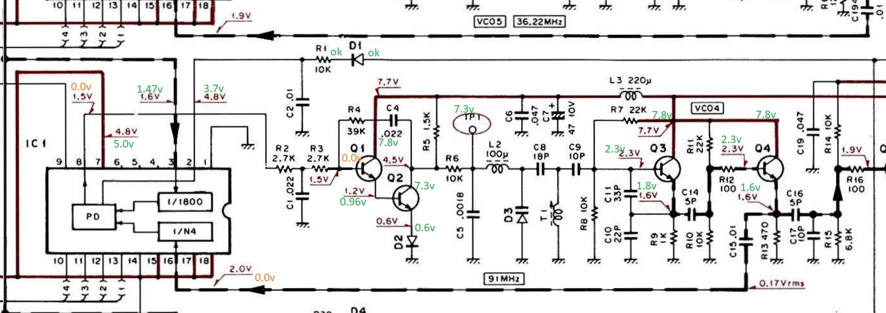

Thanks Brandon, I am just slow with it. Re: VCO 4 (radio on 27mhz rx) If I probe D3 it changes audio and drops the TP1 voltage down a bit (7.8v to 7.6v) . TP slowly rises on startup to nearly 7.8v after 5 minutes and sits there pegged out.
I just decided to check all voltages as shown in schematic. I can see IC1 (MN6147C) is not getting any voltage on pin 8 and 16 (orange):
I'm confident I have the skills to to replace that IC, I have a solder sucker.
Trying to work out if I can somehow test the IC - was going to start probing a good one vs IC1 to make any comparisons in diode/resistance checks between pins.
Maybe I need to bite the bullet and swap the IC's around from VCO 4/5 like your saying. IF I did that - would that mean I would get SSB RX but loose FM RX if IC1 was faulty? I'm just thinking out loud - I'm not into FM anyway. For me its really just SSB. I can also buy a replacement IC for $27AU.
And thankyou as always for your time. I feel like a broken record thanking you all the time but you deserve it.
Not having 2v on pin 16 makes me think that PLL is shot. There is no other source of DC except from inside the IC, so I think it is a safe bet saying the IC is gone.

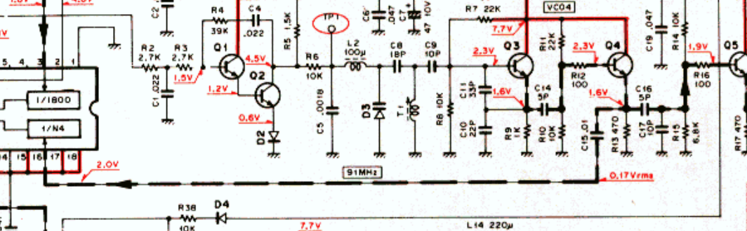

Posting this here is probably a total waste of forum space, but I can't stop wondering what would happen if you ohm'd out pin 16 to ground with the radio off. Is it a short, or some kohm value? .17vRMS signal into an inverter is going to need bias. Maybe, if you are lucky, it was just the internal bias resistor that gave out. Could it be possible to use an external resistor to pull that pin back up to 2v?

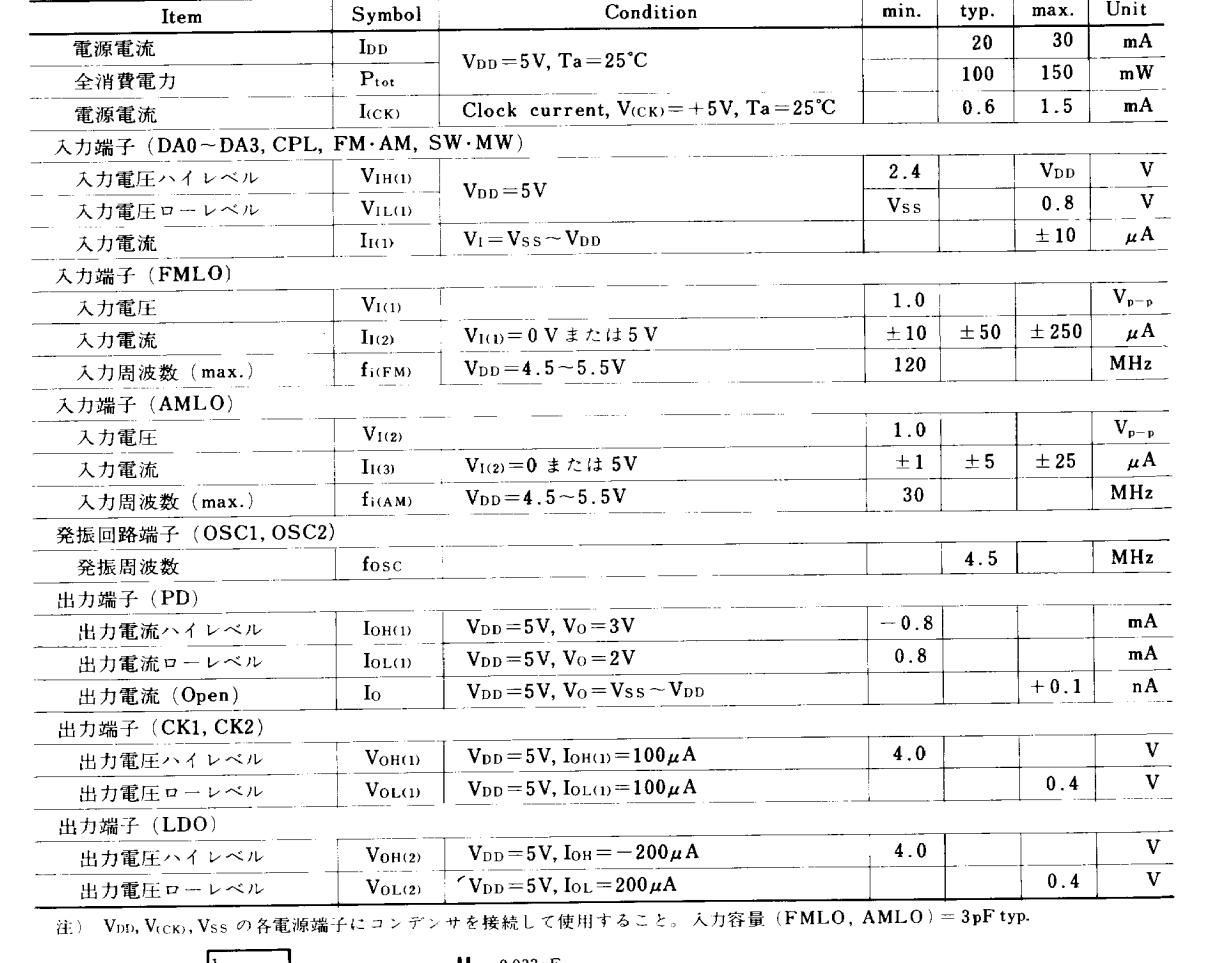

I wish there was a better datasheet for that chip. Most of it is chinese and there is very little information about the inner workings.
No reading at all is not what I expected for something that supposedly has 2v dc on it with no external source. I expected a divider of some sort. Being it is a CMOS chip, maybe those resistors are megohm range and your meter can't see them. IDK.
Looking at the PLL datasheet again, I see it shows a minimum input of 1v pk-pk, which is odd given the manual/schematic has .17Vrms noted on that signal line.
If you did want to try sticking 2v into that pin while it is on, you could take 3 resistors, a 47k, 33k, and 100k, solder all three together on one side, then take the 47k leg to pin 18 4.8v supply, the 33k to pin 1 ground (the two pins on the end of the IC), and the 100k to pin 16. This would put 2v on that pin.

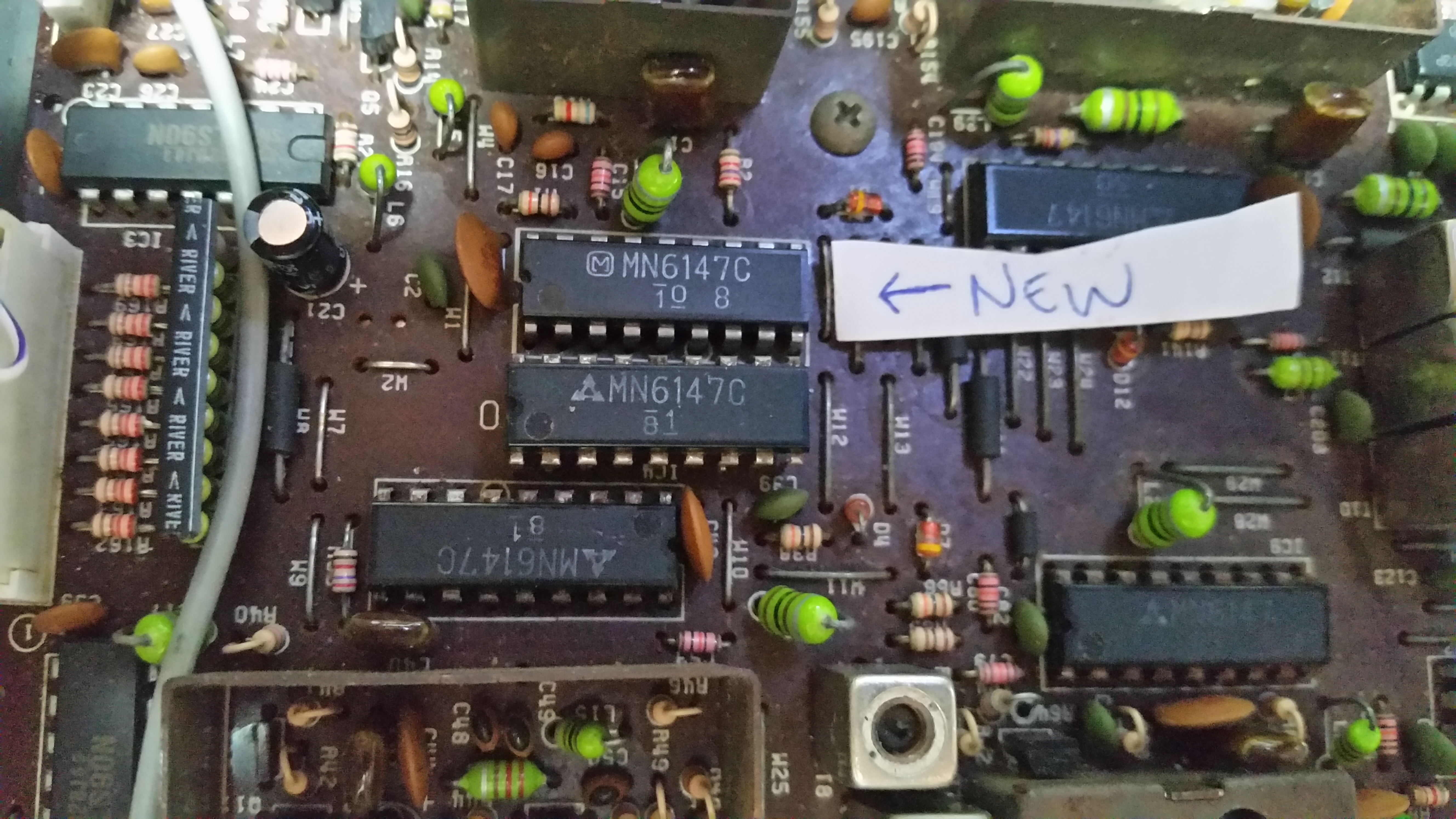

Well Brandon , I think its working!!! Looks like that may been the RX problem. I will verify tomorrow with a second radio and report back. I just installed the new PLL into IC1 (mn6147c from aliexpress) and the 3khz sweep thingy is gone on startup and it has proper volume and no weird noises. Sounding like it should be - stable. Intermittent dot problem gone as well. PLL was $AU20 inc postage so it was worth it to get it up and running.

Looks like IC1 is oscillating, I get the quiet noise for those frequencies. I've also have correct voltages now on pin 8 and 16 that were missing before. Attached a pic of the new IC1 with old ic below it:
