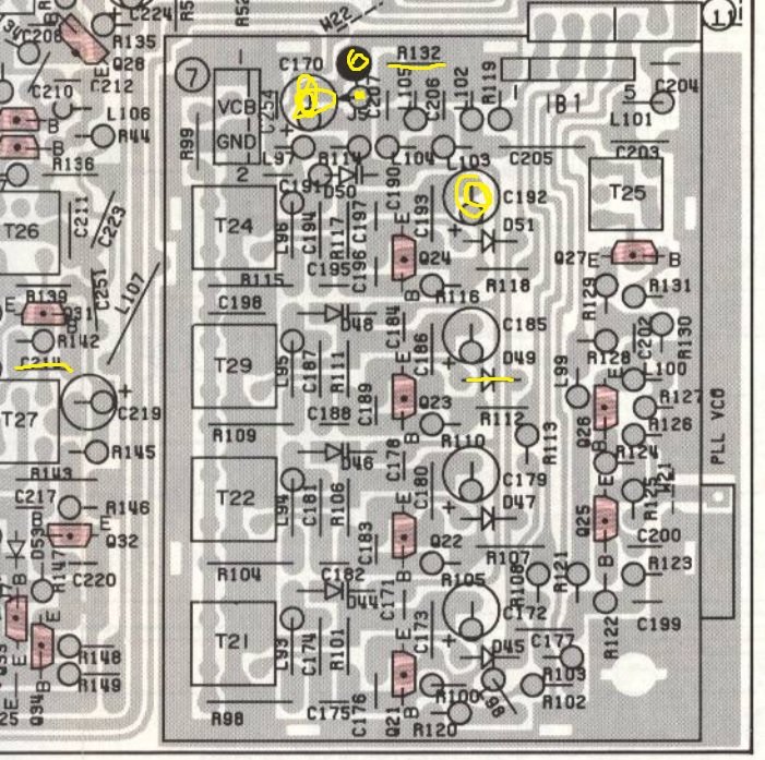

Decided to go check out VCO 1 on the RF Board (I had replaced a few components that had legs eaten off previously) as I read below on another forum which I thought might be relevant:
"The fault was caused by one of the varicap diodes on the R.F. board, it tunes one VCO-2 and is diode D-48. It tunes from about 53 to 58MHz. The diode was going leaky with more than about 4V reverse bias on it and shunting the bias on all the other diodes in that part of the circuit."
I found D49 was shorted (not a varicap) and replaced with 1n4148. Also replaced c192 with correct capacitor (previous person put a 22uf when it should of been 47uf). c170 on this VCO 1 was replaced as part of rebuild I did earlier. All other electros still original in this VCO 1. Attached pic for replaced items in yellow.
I'm wondering if I should take out those varicaps (no shorts but maybe leaky? D44,D46,D48,D50) in VCO1 and test each one or do you think I should be back looking at the PLL board?

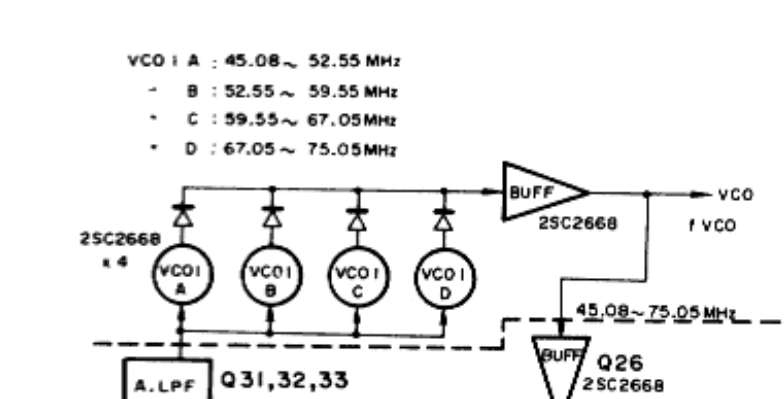

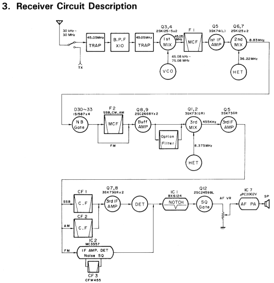

Take a look at the block diagrams
If you want to receive 27.355MHz, the VCO must mix something with it to get the first IF of 45.05MHz. X - 27.355 = 45.05MHz. Solving for X gives 72.385MHz. This tells us that VCO4 should be active when the band dial is set to 10/11m.
Q17-Q20 on the RF unit do the VCO band switching, providing power to the VCO with the correct tuning range for the chosen band. They should not be on at the same time, only one.

Q19 shows voltage here because the radio was on 14MHz when the test points were measured, so VCO2 (52.55-59.55) is needed since 14MHz + 45MHz = 59MHz.
The service bulletin says the diodes for the bandpass filter selection can go bad and throw off the signals that control these VCO power switches (Q17-Q20).
If all the diodes in the BPFs check out, I would take a look at these switch voltages to ensure only one is on at a time. On 11m, VCO4 should be active, but the other three VCOs should not have power at their collectors.
Lets make sure the correct VCO, and only the correct VCO, is running before moving on.

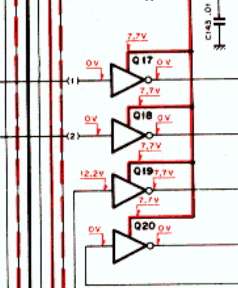

Rechecked the BPF diodes again (ok). I actually tested every other frequency range today instead of just 14,000mhz and its working great, its matched the service bulletion frequency ranges with no voltages where they should not be.
At 14,000mhz , Q19 matched the above diagram and when I change to other frequencies it changes. Eg Q17 is the only one running on 10/11 meters.
Q17 - Q20 look like they working correctly as well.....I think....
Only one of them 'on' at a time. I've attached the image for the transistors to make sure I'm not stuffing up here?. I'm seeing the 12v on the base (right most pin) when a transistor is running, and the middle pins (collectors) have 7.7 for all of them at once and left pin (emitter) get its 7.7 when base has its 12v. One anomaly is I see is 0.1v on Q17 emitter when not in use (due to frequency range). All the others show 0v on emitter when not in use.

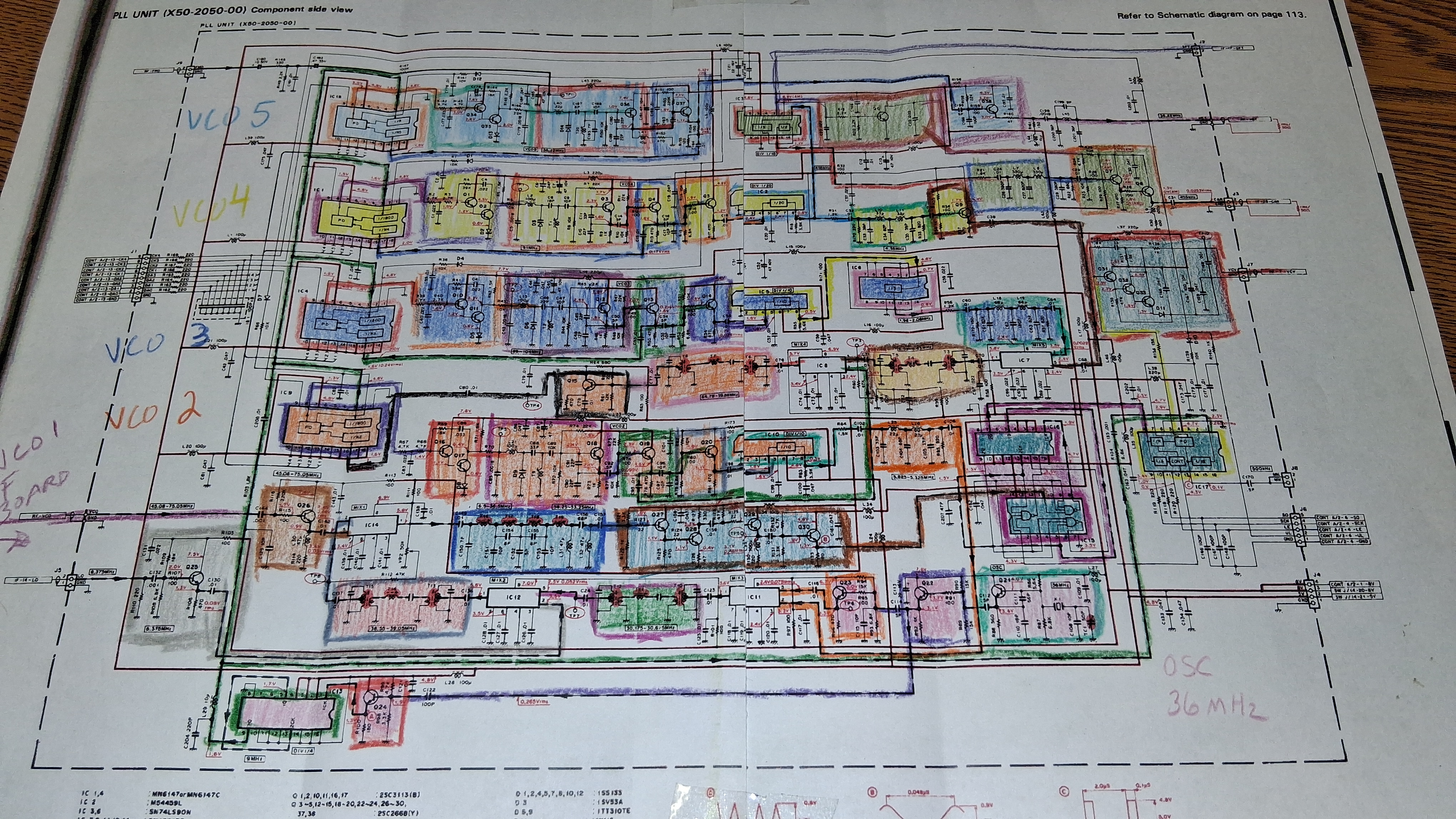

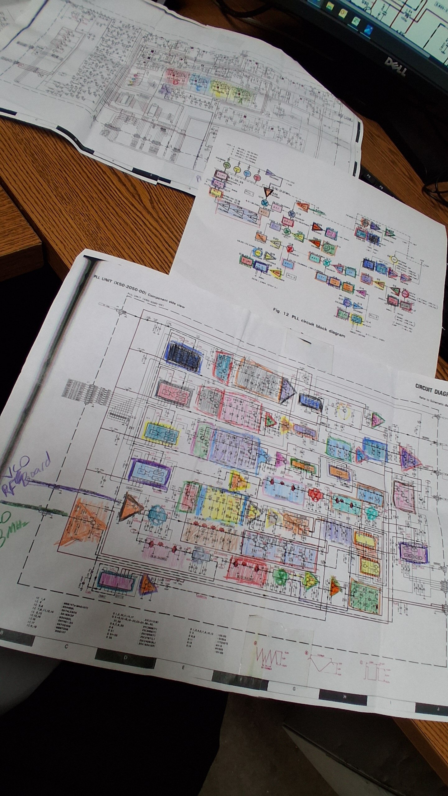

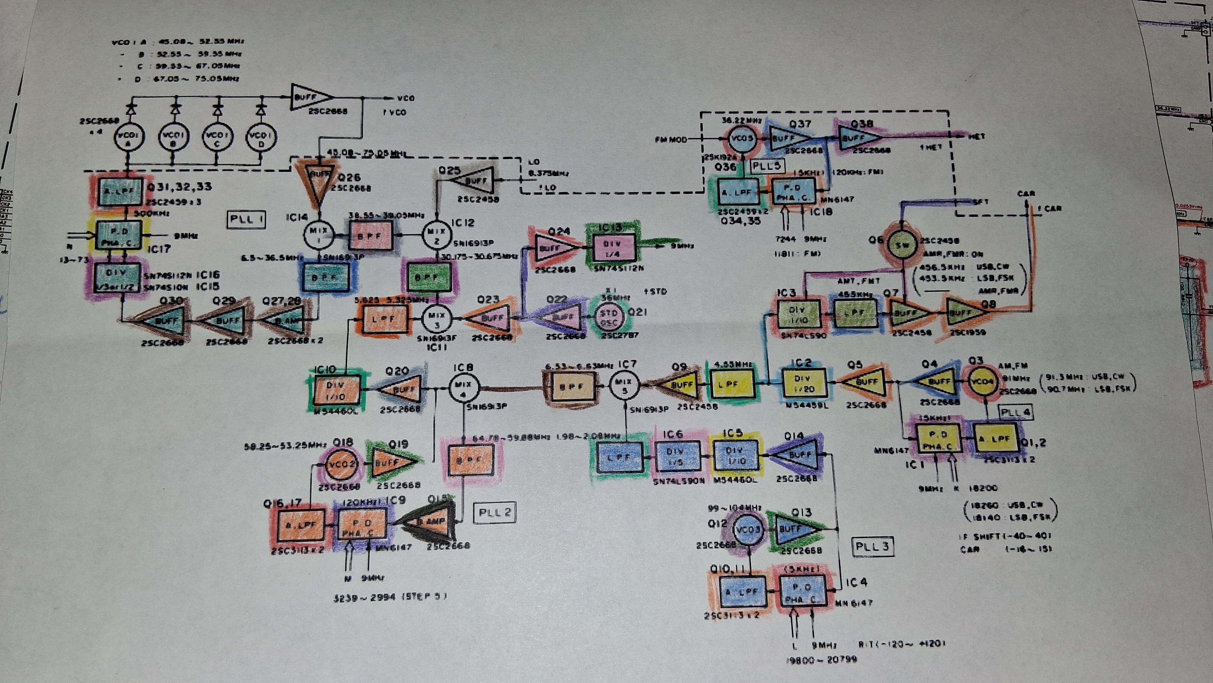

Work had colored pencils, but things got really messy. I plan to do this better tomorrow and hopefully do the rf schematic too. I have to manage color combinations better so they have meaning and reflect paths because these colors are random. Not sure if I will get further tonight though.

I re-colored the PLL block. This time the fill colors represent parts of the signal chain. The color the block is circled in is random, but the matching color leaving that block traces out the signal to the next stage.
I think you need to check out the oscillator (pink fill circled in teal at bottom right). This is amplified by the buffer (pink fill circled in purple, which goes to another buffer (circled in red) before IC13 (circled in green on bottom left). The 9MHz leaves this IC and follows the green traces to the PLL reference inputs. If any part of this pink-filled path goes down, none of the VCO's will lock.
