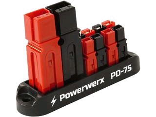

5). APP or similar junctions

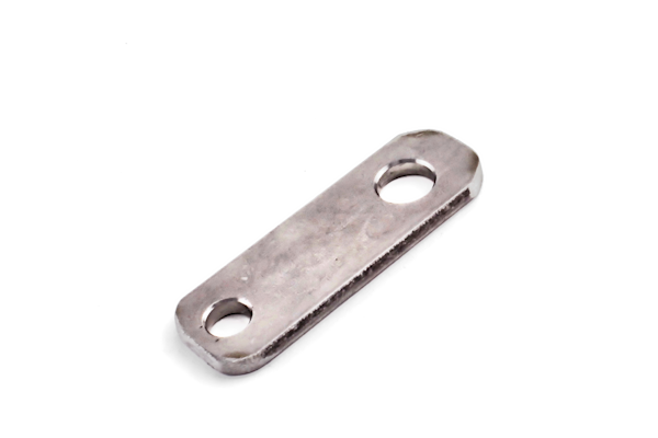

1). The mount stud plate isn’t much of a cover to keep corrosion & dirt away.
2). Removing the mirror arm assembly exposes the body-to-mirror-arm coax joint both ends of which corrode.: The bolt-plate faces corrode and need to be cleaned & treated. Shiny metal with some DOW #4.
— This is an RF Bonding, not a DC Ground. The vehicle is one-half of the antenna. RF current has to be able flow back to the source, and that voltage potential is as much the same on body/frame as we can make it. (Multi-meter testing won’t reveal “good” RF Bond). (Did I get that right, Ridgeline?).

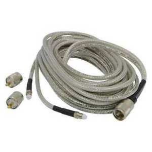

Run New Cophase
Given I’m assigned a T680 I’ll try a pair of these to mount the antennas (as in a post above). Use a longer stud to the OEM stud-join and hang the antenna outboard. Run new coax plus feed-point chokes. Wrap the chokes and coax join to waterproof, then zip-tie the assembly to the arm.
— First step is to exit the cab at the door wiring harness. Then forward BEHIND panel and PAST mirror arm to under hood. Then, back and out along rear of arm.
— Easiest, IMO, to use a fish-tape to get the coax end thru cab wall (wrap end with tape and tape that to fish-tape end). Loosen exterior body panel (shown in video).
Don’t close up anything until cophase harness has a little slack for each leg where it’s on the truck exterior. Work it carefully back & forth: want a minimal amount outside, but with nothing strained.
WILSON single or cophase coax with FME ends ($50?) makes this easy.
This full full bypass of the factory coax leaves it intact for the next driver plus eliminates at least four (4) splices plus the duplexer (if present).

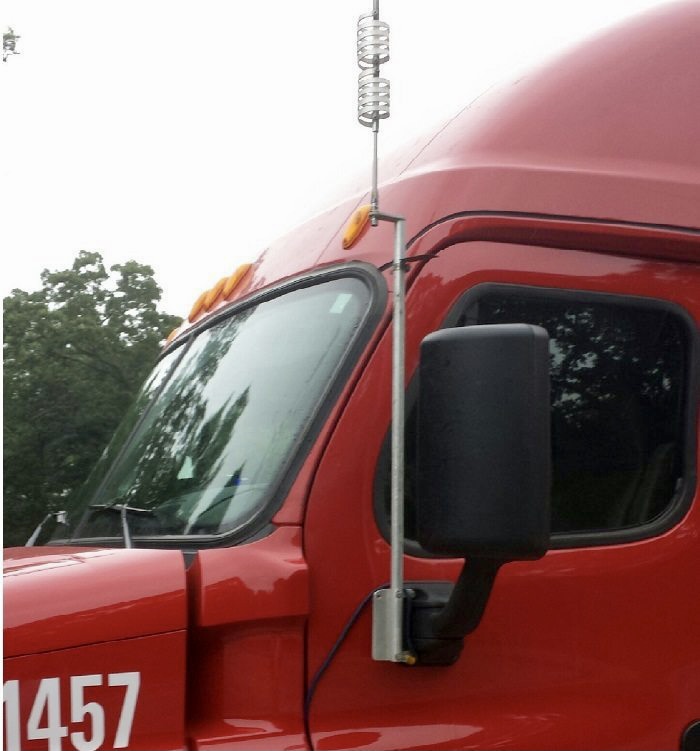

Custom Antenna Mount
This example of an arm onto which to mount a best quality antenna would be the ideal. While the truck shown is not a KW T680/880, the idea is correct.
The mount arm needn’t be this tall, the takeaway is the strength of the arm bracket bolts with a plate is key.
Getting the antenna above the body (away from the body) is the thing. (Pic is of a knowledgeable drivers’ assigned truck; amateur license holder).
I wouldn’t go OVER 14’ clearance, but I’d snuggle up next to it, (No, an antenna won’t set off a 13’5” clearance detector).

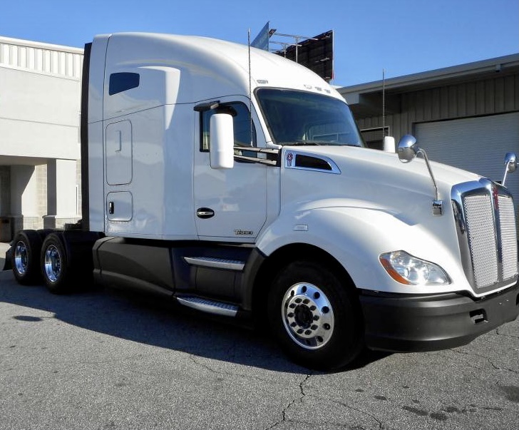

Am champing at the bit to get this one started. Most gear assembled & ready. Hoping coax in good shape if I have to use an older truck (2020 model). Will use the Lincoln II+ and 6’ Skipshooters. Run power.
Having to wait thru pre-employment items to line up.
Antenna Mount Base: 6.75’ (81”)
from ground on Mirror Arm.
A). 5’ Antennas (60”)
(141”) 11.75’ top-out
B). 6’ Antennas (72”)
(153”) 12.75’
C). 7’ Antennas (84”)
(165”). 13.75”
Big truck with van requires 13’5” clearance.
(Stock photo; OEM 4’ antennas shown).
Definitely easier to work with than the 579 Peterbilt. Antennas far enough to outside of trailer dimension to be able to see it from rear.
As I’m starting in an old-timer (MY-2018 & 365k-miles) with new trucks on order, my work here will be to clean both mirror & antenna-stud mounts of powder-coat.
I may run a ground strap thru the arm (fold-back arm design) connected to coax below antenna stud and out to cab. I’ve some unused narrower strap, and may as well find out if it’s a beneficial change.
Just got it back home a few hours ago. Need to move gear aboard. RADIO RIG changes will be on-road as no time tonight. Get under a load in the morning and a 1,400-mile run to East Coast.
7’ Skipshooters
This won’t be the tallest installation by about 5”. One does have to be aware of tree branches. So a pair of HUSTLER Quick-Disconnect adapters are going to be installed (which will bring me to just shy of 14’; call it that for GP).
