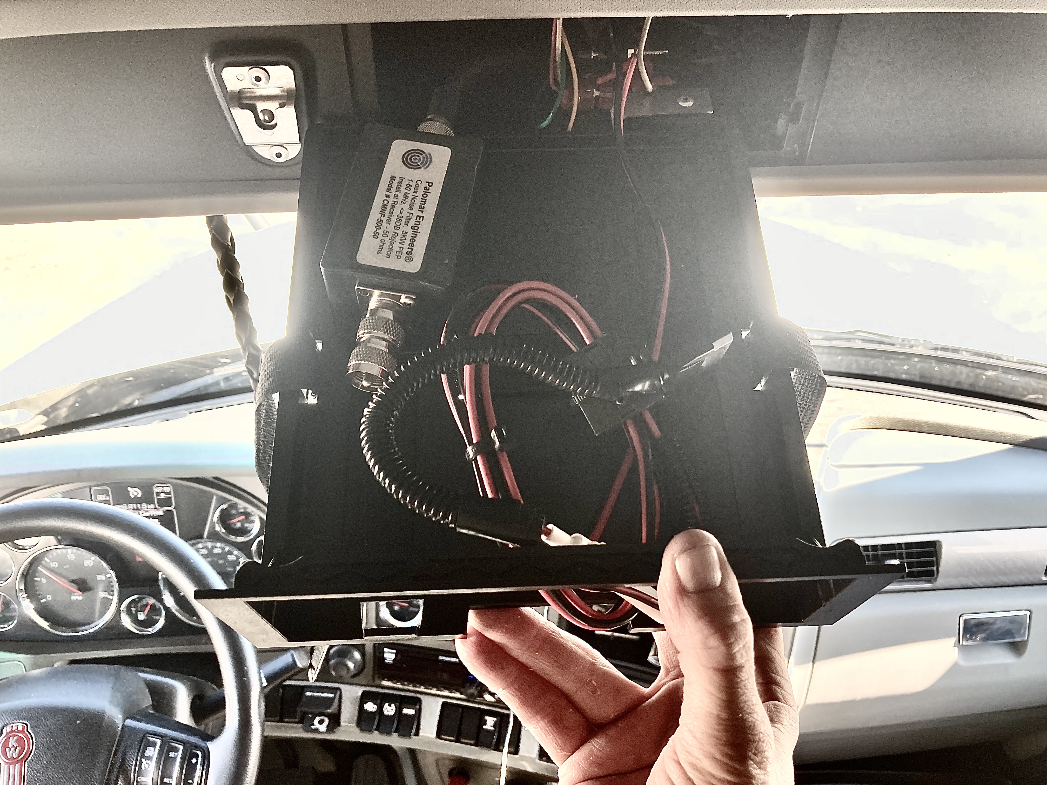

Now, for those where a big truck install is new territory: the KW 680/880 is as easy as it gets to physically install a radio of the proper size.
— Shown here with a few snap-on toroids and cased noise filter.
This tray releases and slides. OUT!. Using your new soldered-end power cord, attach where the binding post does not capture wire insulation, but wire only. Tighten past snug.
You could try the noise reduction additions seen here ($75), but I won’t make you promises. Can I hear a difference? Yes. Will you feel you got your money’s worth? Can’t say.
1). Mix-31 Snap-on over truck wire (one pass).
2). Mix-31 Multi-pass of Radio power cord (shaped and secured with zip-ties; 4-turns).
3). Coax Noise Filter at Radio (Palomar Engineers CMNF-500).

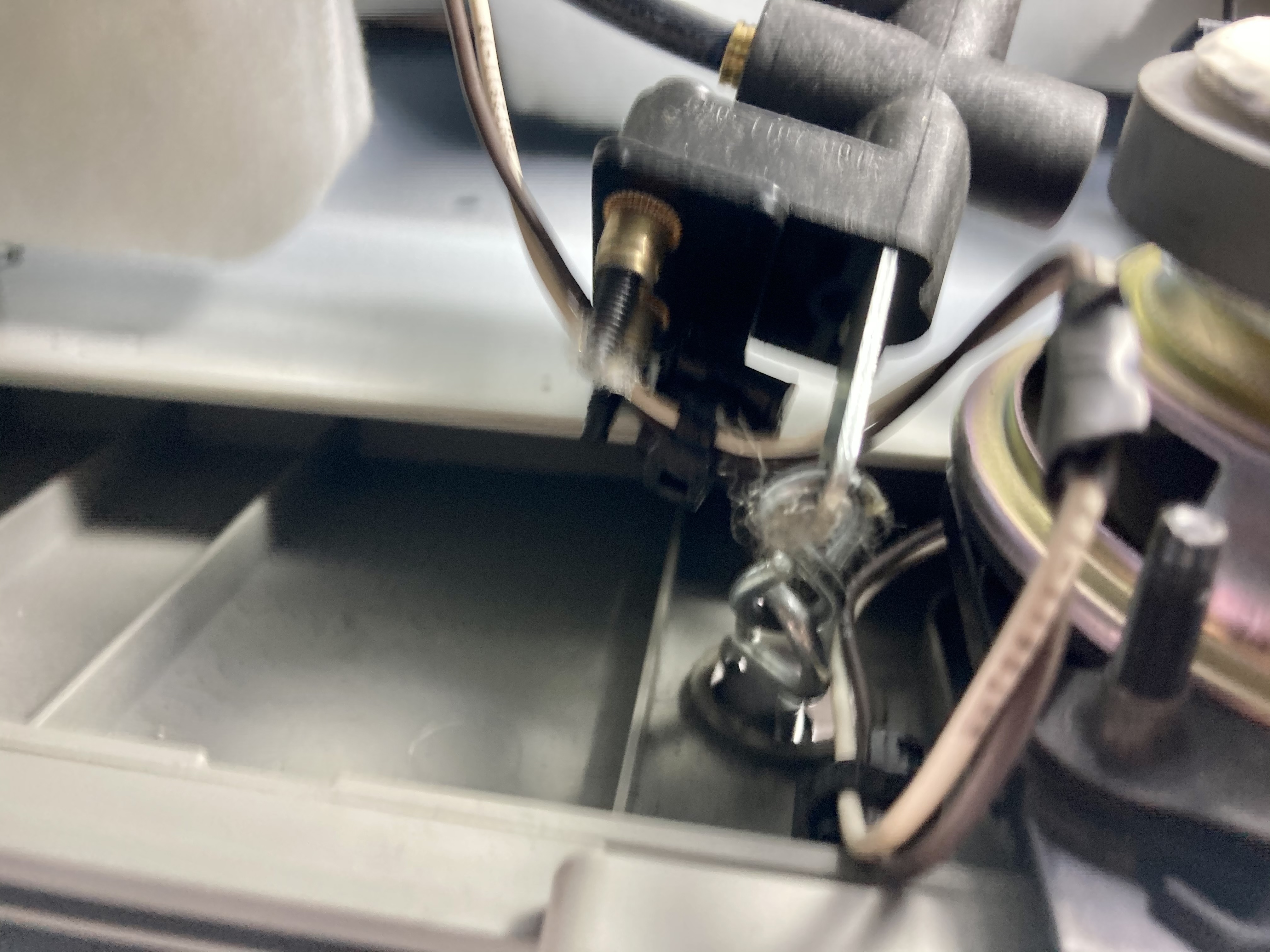

This view is to the viewers left with the front panel removed. Thr radio tray — not shown — is to the right. The tiny factory speaker. The air lines for the air horn. And, Moses, look upon the Promised Land (meaning the powder-coated steel shelf behind it.)
To this will attach the power cord Negative where the Positive makes the long run to the Batteries under the drivers door steps (about 20’).
Bypassing the factory power will decrease substantially the noise carried by the vehicle electrical system.
Reducing the Signal-to-Noise Ratio is a series of small bites to reduce the problem. No ONE fix. Many little fixes.
And, as radios run best with less than a half-volt drop once keyed, a correctly-sized power cord can be minimized in length PLUS wire gauge with this short Negative run.

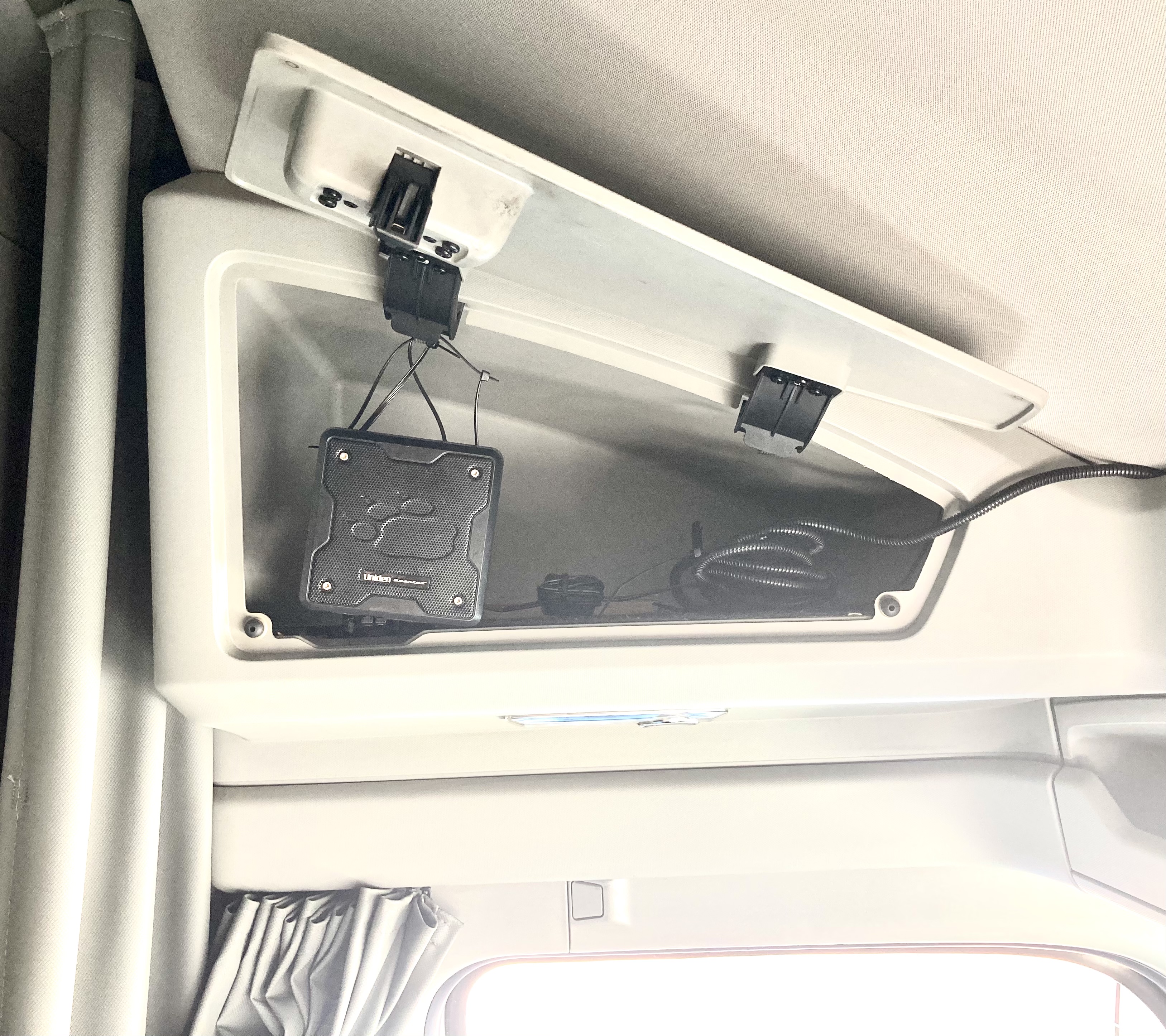

3). External speaker in cabinet above drivers left shoulder.
Installation Requirements:
A). Above left shoulder.
B). Downward tilt.
C). Speaker cone clears fixture.
D). Bracket attached to latch behind speaker from bracket; more zippies from bracket to above. Fat M-61 toroid took 4-5 turns (must close to work).
Even this inexpensive truckstop UNIDEN speaker when properly-positioned, offers FAR MORE clarity than the KW integrated speaker or the one in the radio case.
