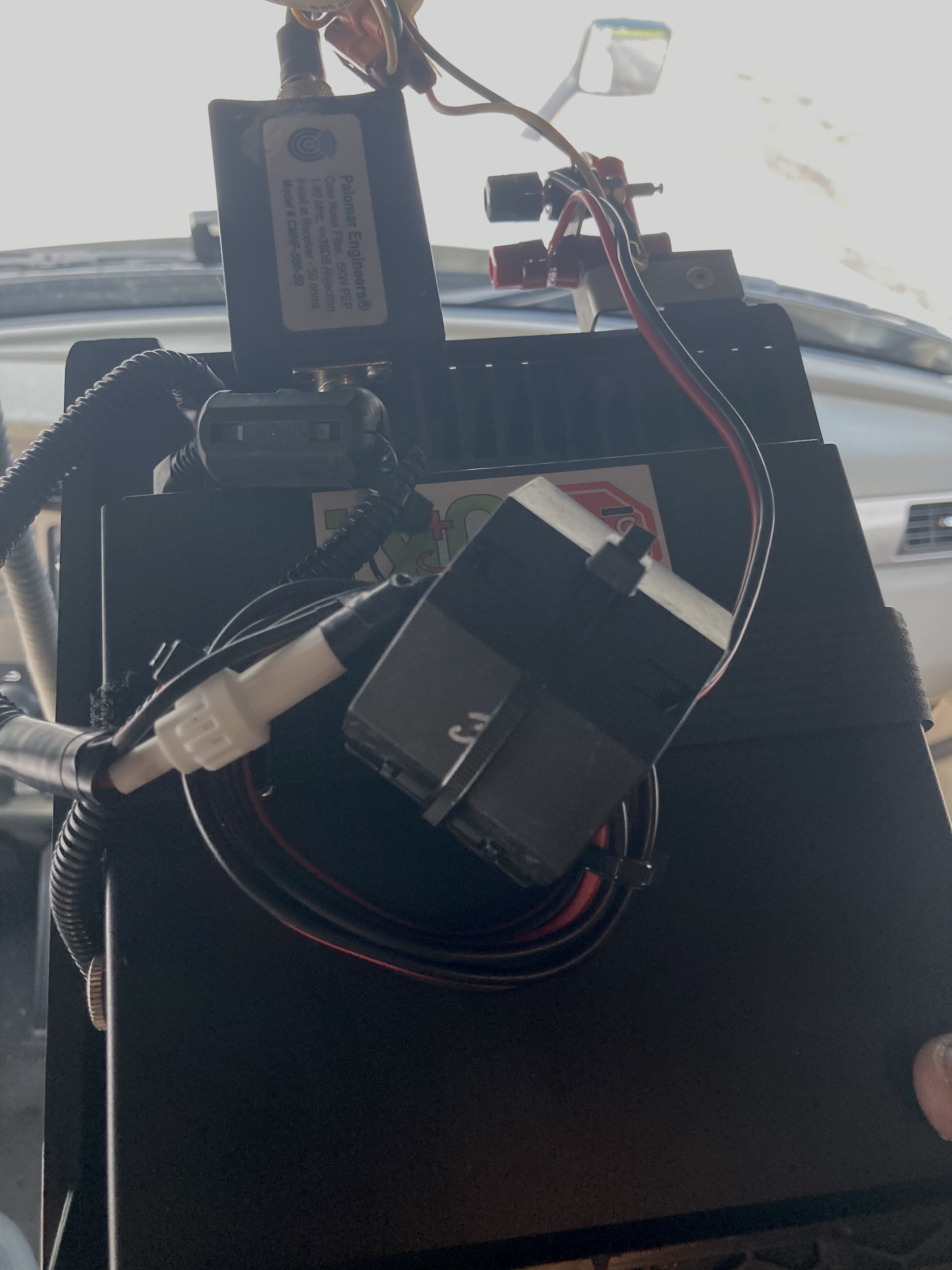

Pic to come but wrapped power thru a great big ol’ Mix 31 ferrite toroid.
And — all of a sudden — them hopper-bottom boys lined up down at the Lightcrust Flour Mill was given the gift of tongues, such that strangers and kin alike all knew their own.
Interpretation: Boy, this truck is noisy thru the factory binding posts.
Was
noisy.

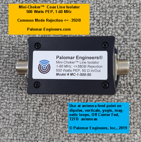

Here are the pieces I’ll use to better mount the 7’ Skipshooters (which have done fine in the 4,300+ miles the first eight days on this truck), as they’ll enable me to also mount the P-E MC1-500-50 MINI COAX Line Isolators at the antenna feedpoint. $59.95/ea.
If it’ll work, I’ll use a pair of 90 adapters to curl the feed to the MC1-500 between the arms with coax then attached via another 90 to the trailing edge of the lower arm and thence to the body plug.
Still have to make the antenna mount RF Bond which will route internally to the steel of the arm-to-cab bolts.

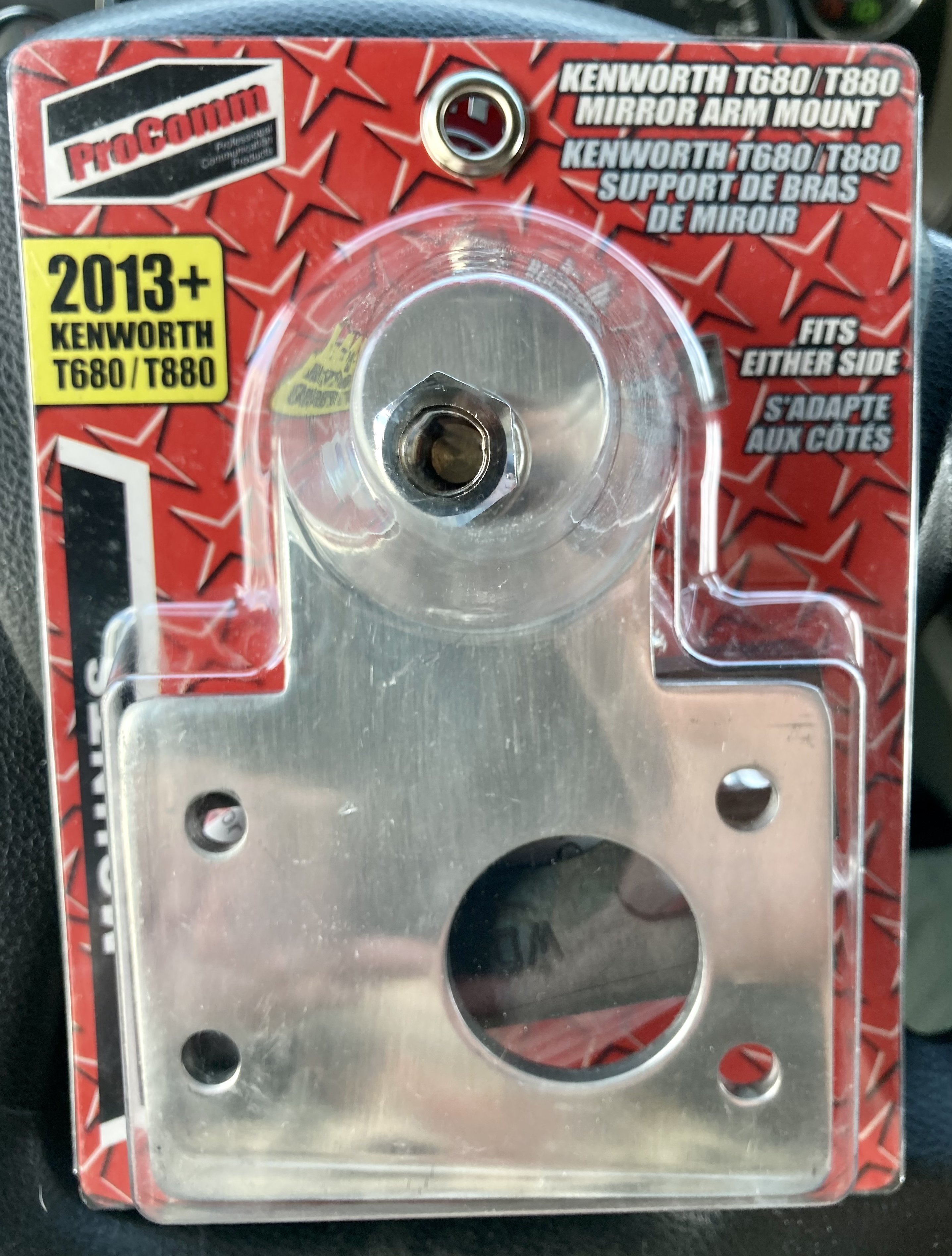

There’ll also be better (larger, stronger) antenna studs used. ($20/ea)
Found these mounts today on the shelf at the KENLY PETRO (IOWA 80) on Truck Stop Road, X106 on IH-95 in North Carolina. $34.99/ea.
The mirror arm folds back for transport or service. Can’t have these mounts interfere (to front or rear).

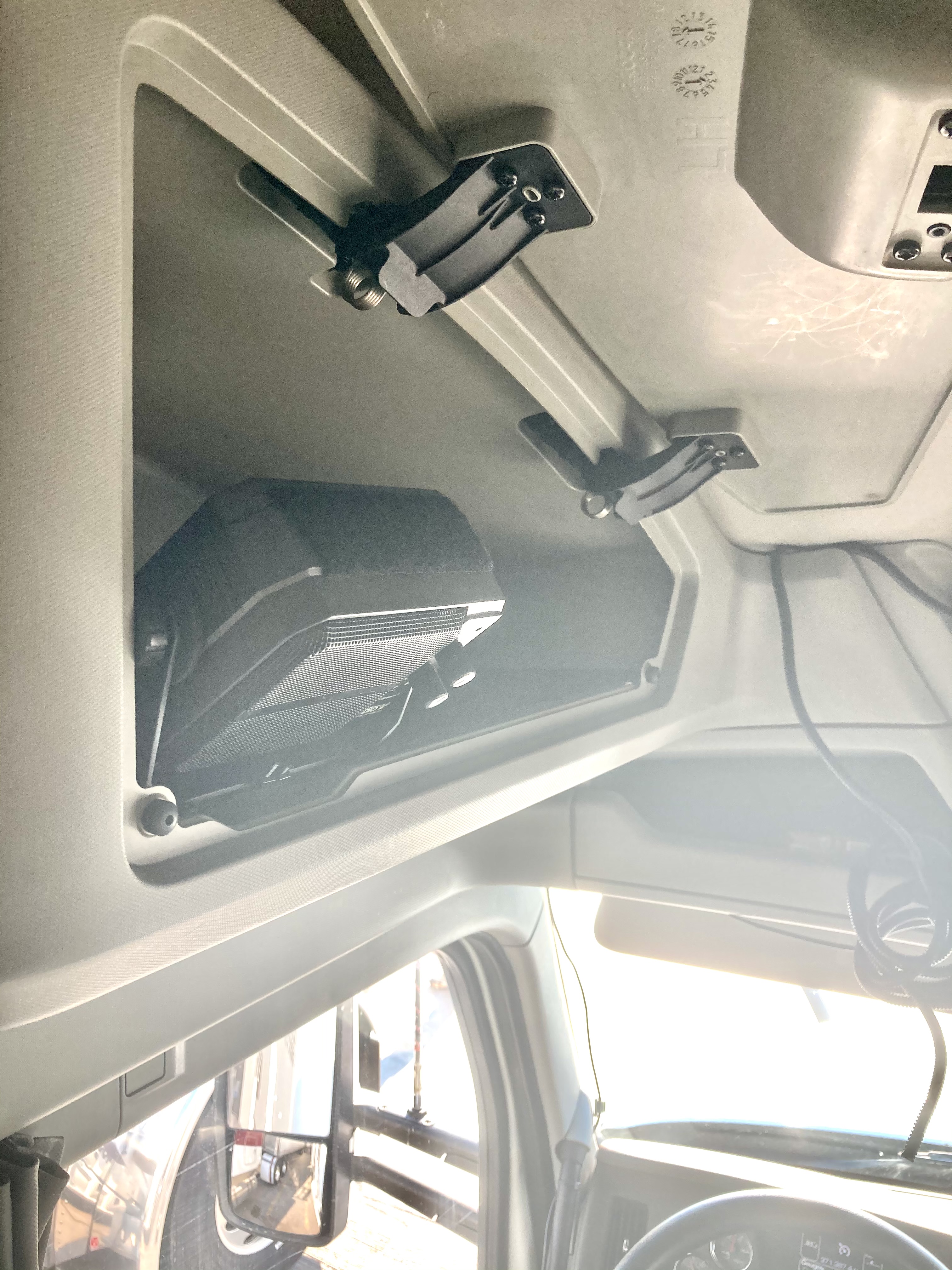

Have the WEST MOUNTAIN RADIO CLEARSPEECH DSP Speaker installed with Velcro & zip ties:
1). Over left shoulder.
2). Angled down to envelope perception.
3). Ease of use.
— The PRESIDENT LINCOLN II currently installed needed help in amplification. This speaker delivers. I can run windows open and still hear everything.
— Digital Signal Processing
cleans up RX (see threads this speaker as title).
NO need for NB/ANL. Back off RF Gain a scooch.
This last two weeks was a LONG two weeks without this speaker. CB Radio goes from irritating (hash noise plus asshats on air would make anyone turn it off), to not noticing A-hats very much.
— Hash so well reduced it’s like having a new radio —
Yes, you need to mount any external speaker in the manner shown, please.

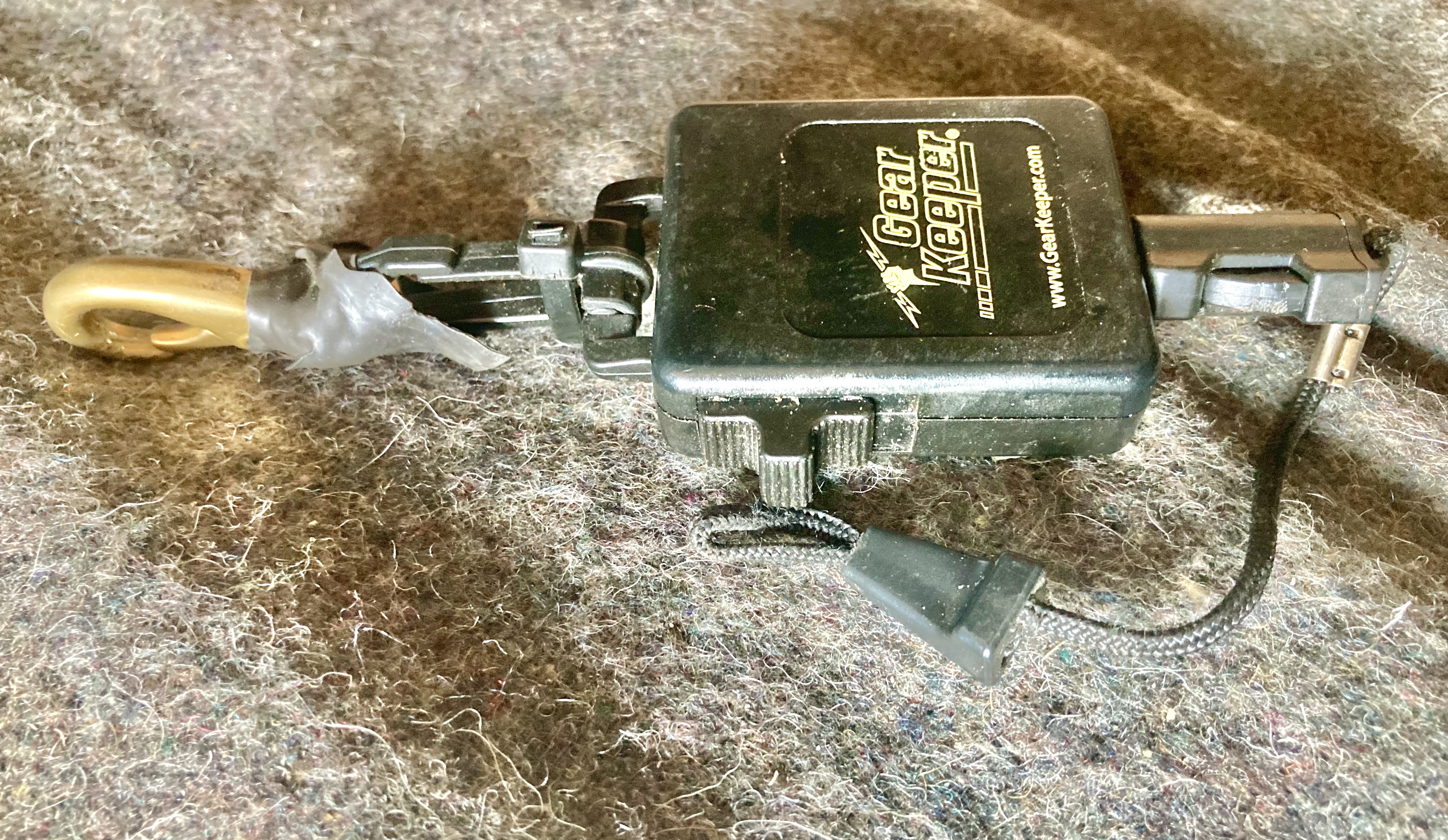

Dug this GearKeeper mic hanger out of the bag to see if I prefer it over the KW clip. (Got that HD brass clip at a marine supply store; need only a lip to hang this device, then). These are about $30 and are great if you’re willing to get them dialed in per location and swing-tendency.

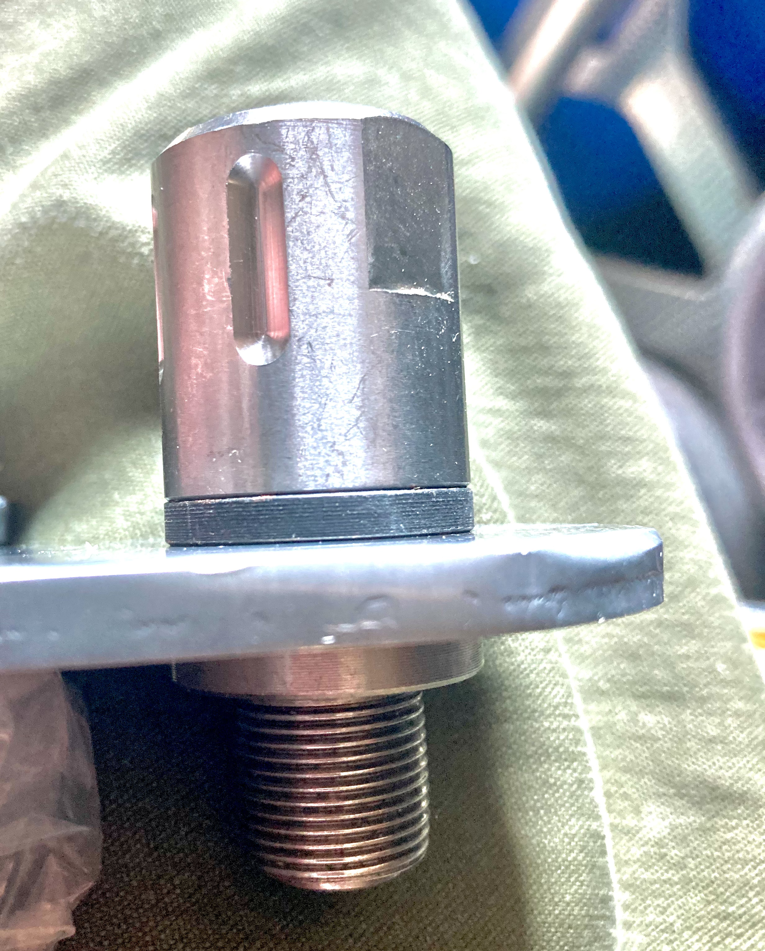

Upgraded the included antenna-mount studs to TOP GUN stainless pieces bought several years back.,Covers a greater surface area of the mount. Machined. Isn’t going to crack like lower-quality stud it replaced.
The included Pro-Comm studs are not what I’d want for any antenna over 4’.
The Skipshooters at seven feet generate plenty of gyrational torque at highway speed. The weak point is (should remain) the antenna ferrule, not the stud nut.
(This addition brings the antenna mount upgrade to $60/each side.)
