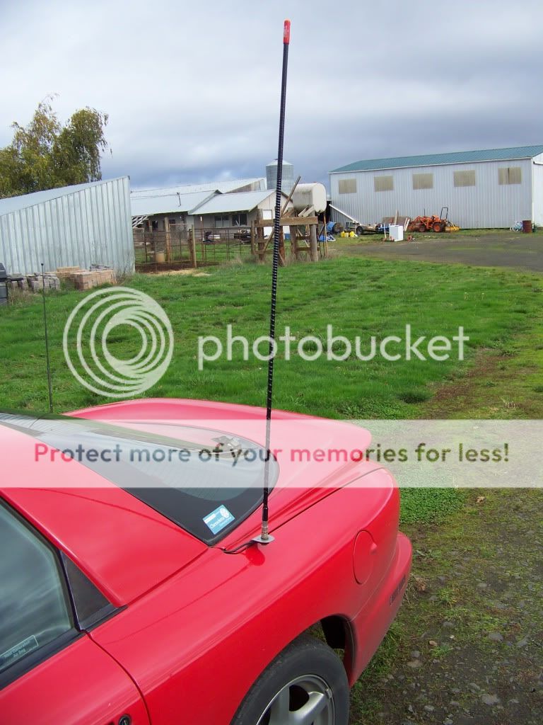

3) my car does have alot of metal, but it does lack key points for a mag mount, id say 70% of the car that is not glass is metal. heres a pic
4) so the firestick II is a great antenna and will do the job, but for that little extra reach, a 102" whip will help, but my setup works good, 100% better than what crap i had before.
this ones before the antenna a while back to give you guys an idea of full car.
Hah, I know all about that model.
Poly bumpers and spoiler, fiberglass doors + hood + fenders.
Here's an option:
You've probably got a little tow hook in the back underneath the car.
Sand off the coating from the hook.
Clamp an extension onto it. You can make one pretty easy.
One long bar of steel + 1 short piece with a bolt through it to clamp it onto the hook. The long piece should stick out past the bumper.
Mount your 102" whip off of that. It'll give you a solid connection to the one big piece of metal on your car (the underbody).
This is exactly the setup I'm going to be using on my Honda CRX.
You'll feel a little ridiculous, but who cares? It'll get the job done.

Brownstone,
Nice pics, looking at that metal grain bin in the back ground, an Imax 2000 mounted on top of that big metal grain bin would be SMOKING HOT for an antenna location.
Heck even an 102" steel whip would talk it's as* off mounted on top of that big metal structure, or better yet that machine shed with all the metal roof for a ground plane.
People would think you are running a 100 watt amp instead of just a 4 watt radio.
Reminds me of climbing on top of the silo when I was a kid with my hand held walkie talkie, I could talk to my cousin fishing at the lake, almost a mile away when I was on top of that silo.
yeah i been just saying whats goin on ch 17? and people who wana talk talk and who doesnt doesnt. i would tend to do a radio check, but it would last like 30 seconds and be done.
and yeah i wish i could run an coaxial that far im sure it would act great as an antenna. its full of rotted grain bout halfway up but im sure it would be awesome.
