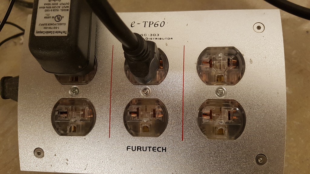

Some will say Yay and other will say Nay! I dont have any experience with the Tripplite, but why not have clean AC going into your equipment, I run a Furutech e-TP60 conditioner and am very pleased with it.
