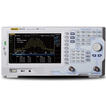

Nnnnnnice; a spectrum analyzer. Still don't have one yet either. Are you looking at the Rigol? That would be my choice; the one with the optional signal generator. That would be the ultimate setup to test filters and ferrites, as well as a few other key tests at that price point.
