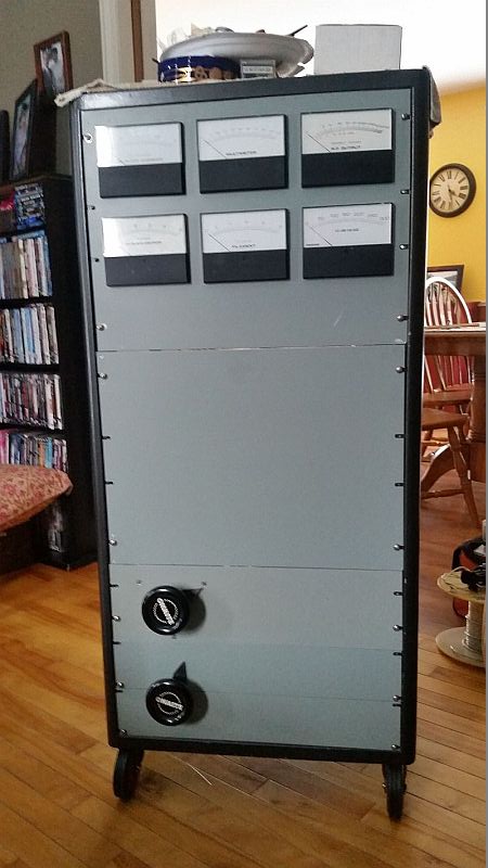

Well I have the tower and am working on about 1.5 Kw or more when the project is finished. :D It's still a work in progress and will be for some time.
