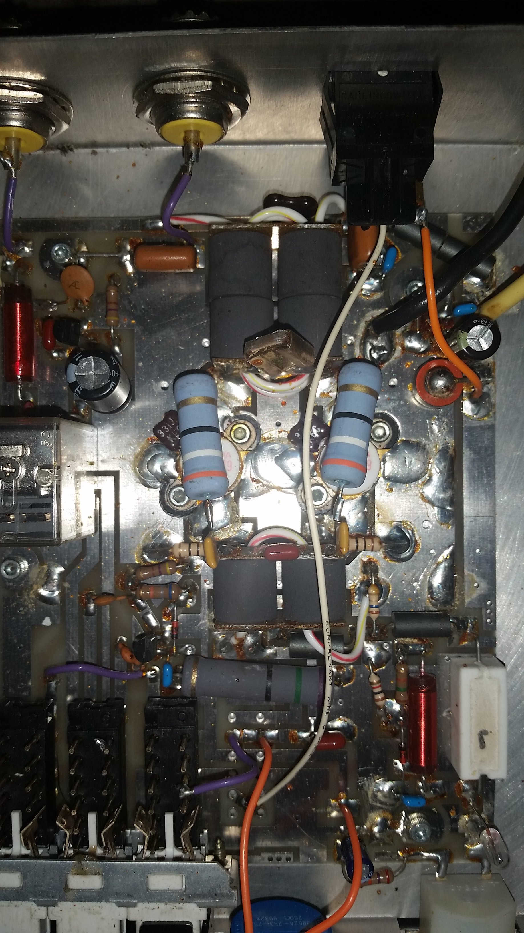

I have the ts350 vhd, I love this amp. Before I knew what I was doing a few years back(and yesterday) I drove this amp with a 50 watt radio. Now I use it as a driver for dx and just ssb. I did how ever lose the potentiometer just this week and am hoping to get that replaced as soon as I fine one. I have had this amp for about 6 years and it still does about 350 on my meter with a 15w drive. I run mine on a 32 amp power supply @ 14.5v. PS drops to about 14v at full power.
I got it used for 100 bucks. Don't know if it's stock or not. Here is a picture
