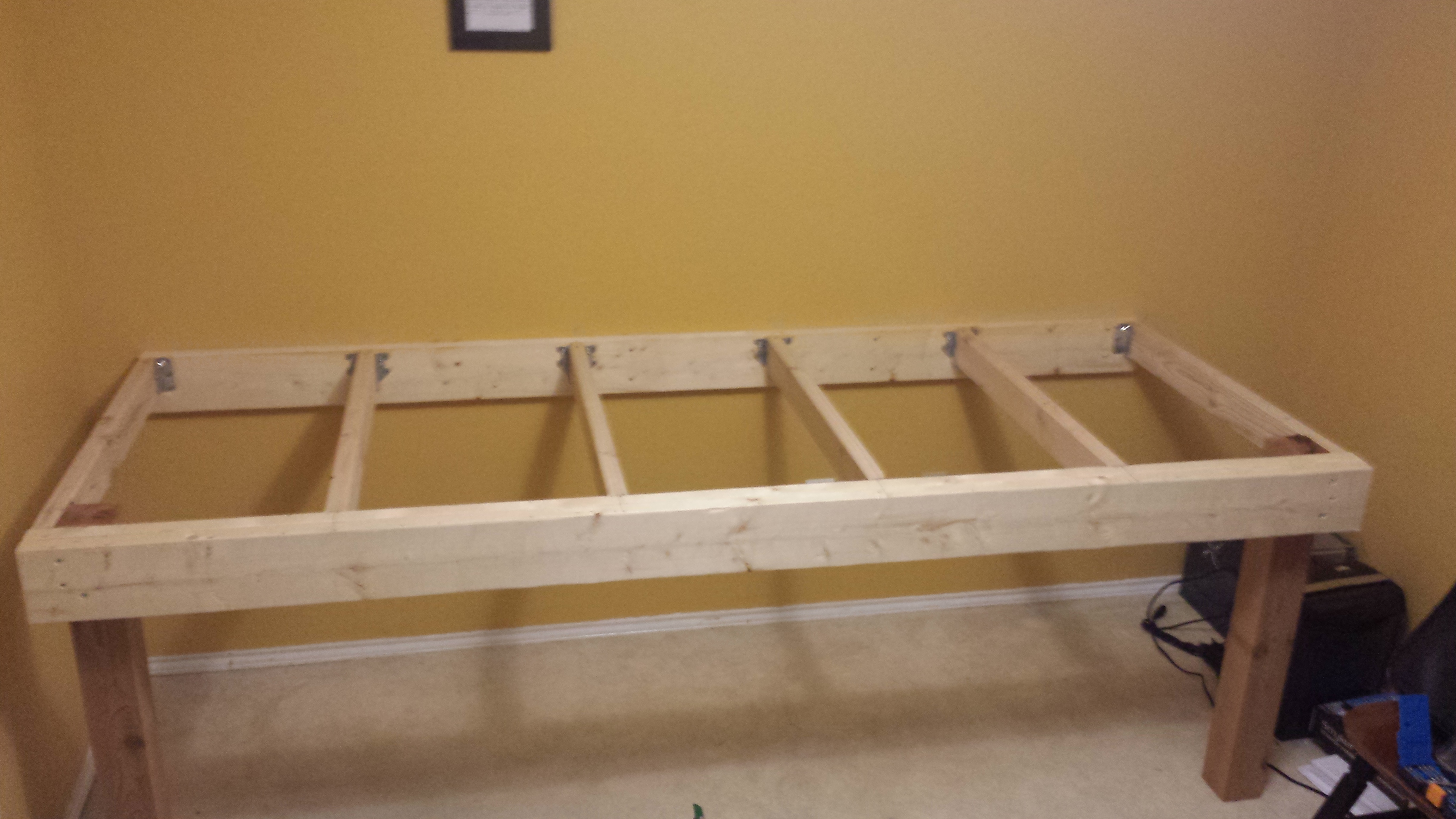

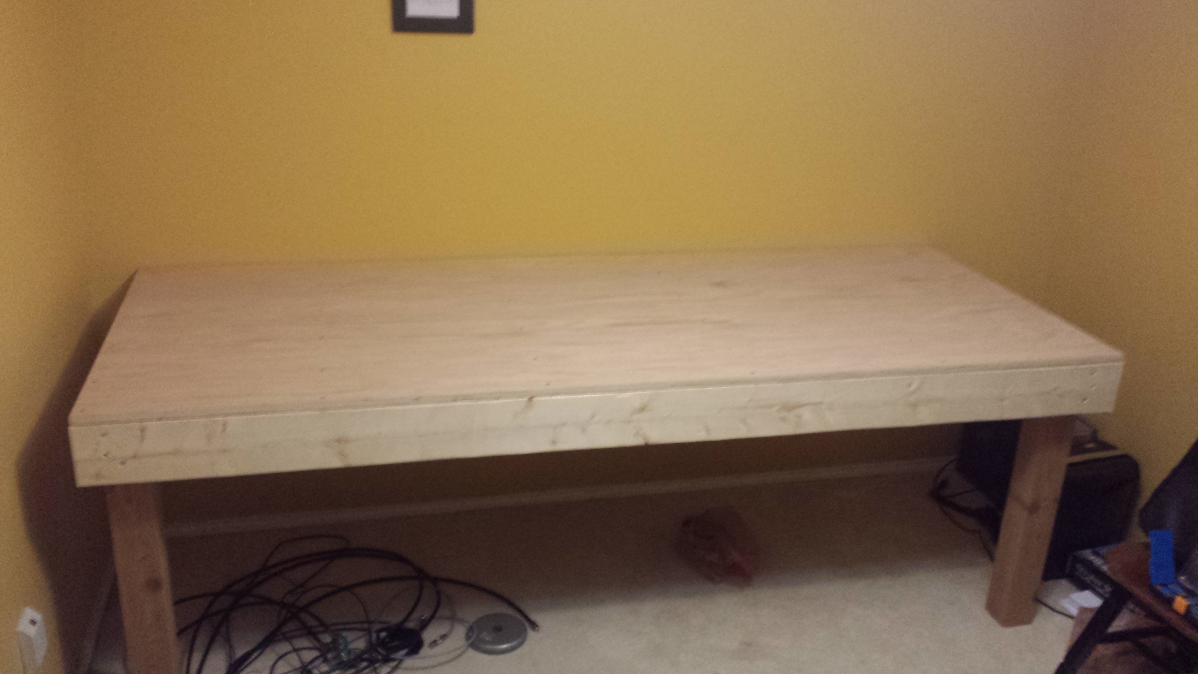

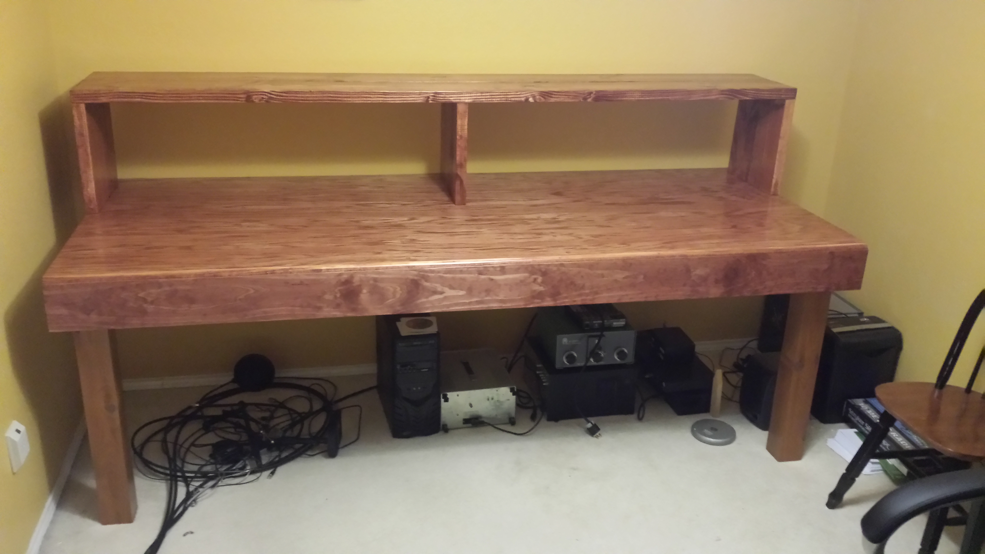

Buddy of mine stopped by earlier. He's going to build it for me. What he described was basically how you did yours. I told him I want to be able to zip back and forth in my chair and not bust my knees.
Once I get this done I'll be able to bring out my closet queens and start using them. Be nice to have a proper bench for a change.

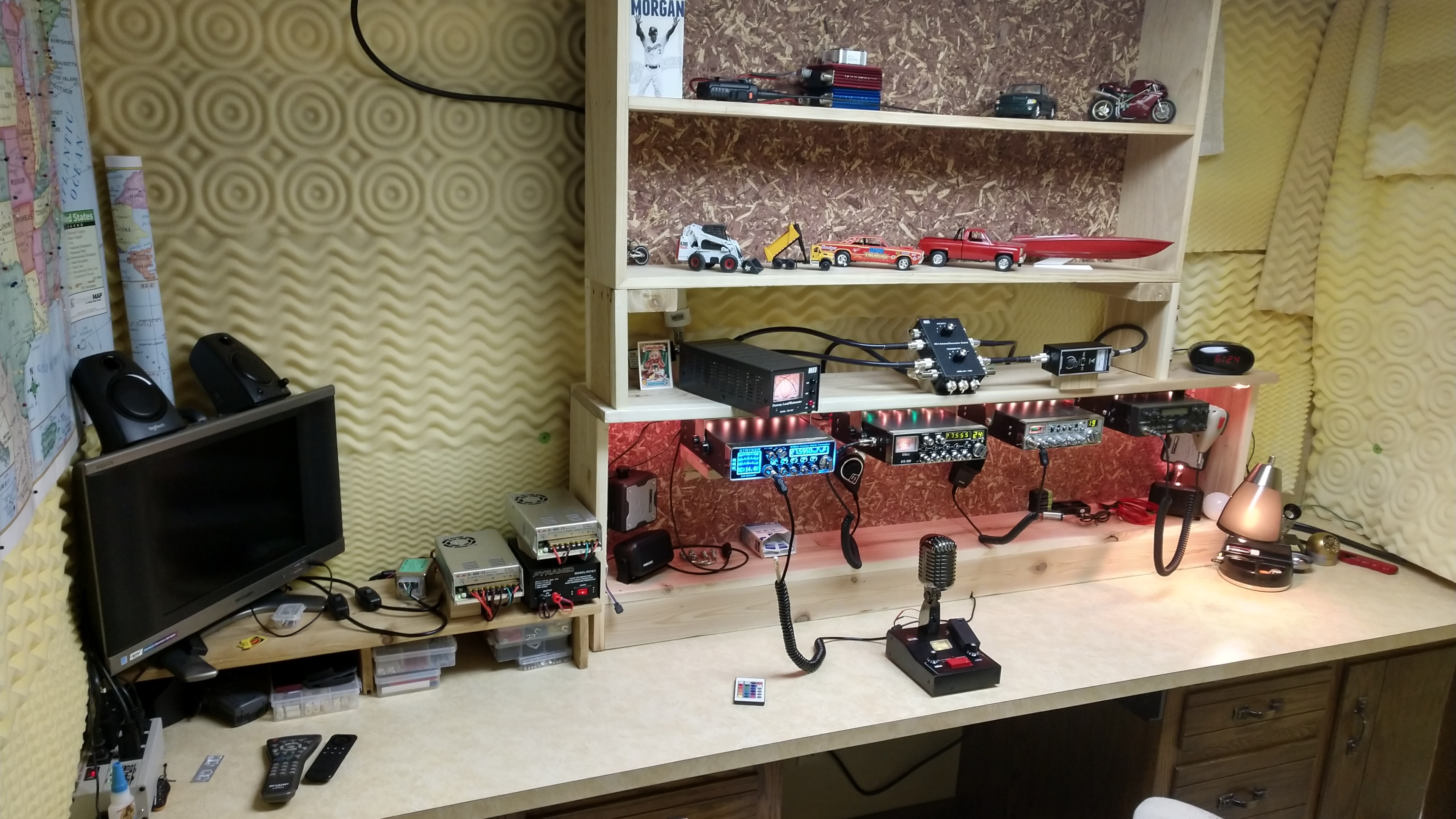

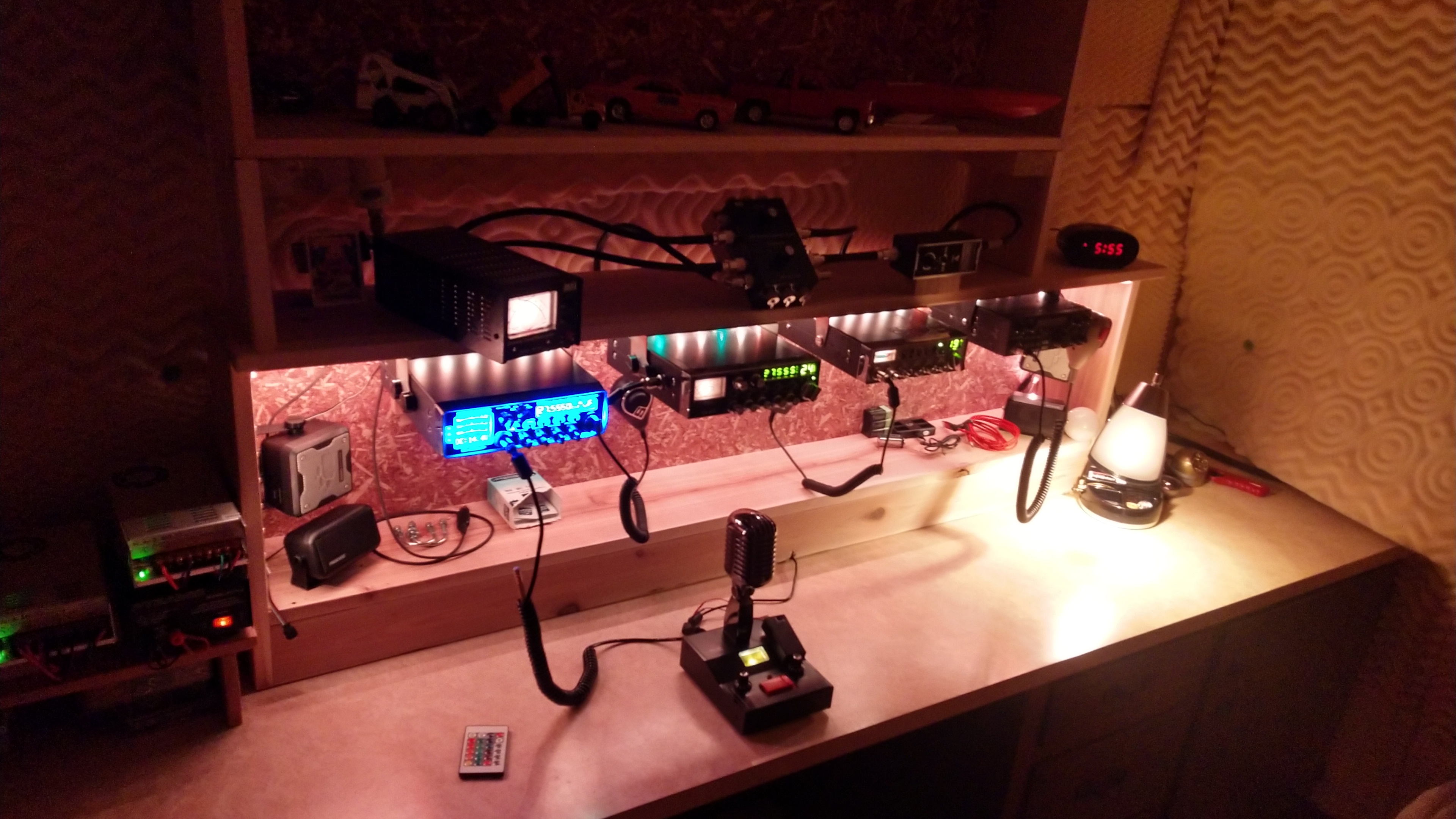

No matter how BIG you build...never seems big enough...so go bigger than you think...it will fill up fast!:whistle::LOL::LOL::LOL:
I will be building a bigger topper this summer...out of room:confused::(
Top shelves 2 x 12's...lower is 2 layers of 7/16 chipboard...not strong enough will use 2 x 6's or 5/4 board this time with a center post for extra support...End supports 1 x 6's...again ended up not strong enough...ended up adding support to the wall with brackets to keep from pulling forward.
The weight adds up quicker than you think.:LOL:
