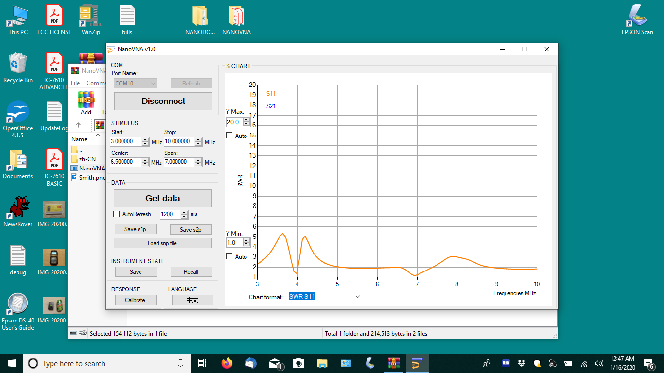

  15. HomerBB
    HomerBB Sr. Member
    Joined:
    Jan 4, 2009
    Messages:
    3,418
    Likes Received:
    1,502
    Rwb likes this.
