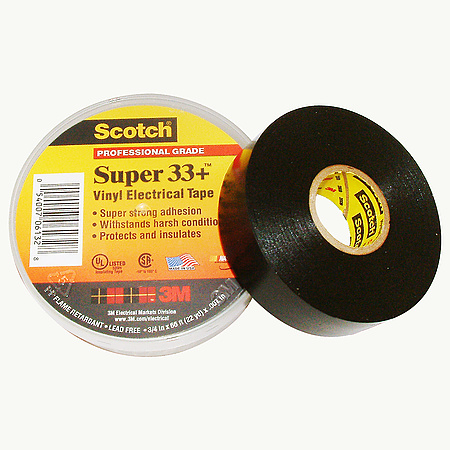

After you get it tuned. Tape up all the sections with good tape.
This will help on water intrusion plus if something shakes loose this will also help hold all the sections in-place...even the radials.
Good Luck
All the Best
Gary
SCOTCH 33+
...find at Home Depot/Lowes or just about any major hardware store...most generally, in the Electrical dept. section.
Cost for the good stuff around $3.00 a roll...get a couple.
And when you rap that pull it tightly overlapping each rap about half way...even the hose clamps...Then cut with a razor knife to finish...if you just pull that till it breaks it will over time tend to begin to unravel(which any tape will do) This will make a good joint and last many years.
The little extra work after tuning will help insure many years of good service. Always worked for me and have assembled many, many antennas over my 40+ years of RadioFun:LOL:

Mike: Yes, No tape is impervious to moisture...
However having been a cable splicer for almost 40 years...in the worst possible environment's..It damn sure helps!!!
When used as I described:
It will at least slow the process and help minimize the intrusion and contamination.
