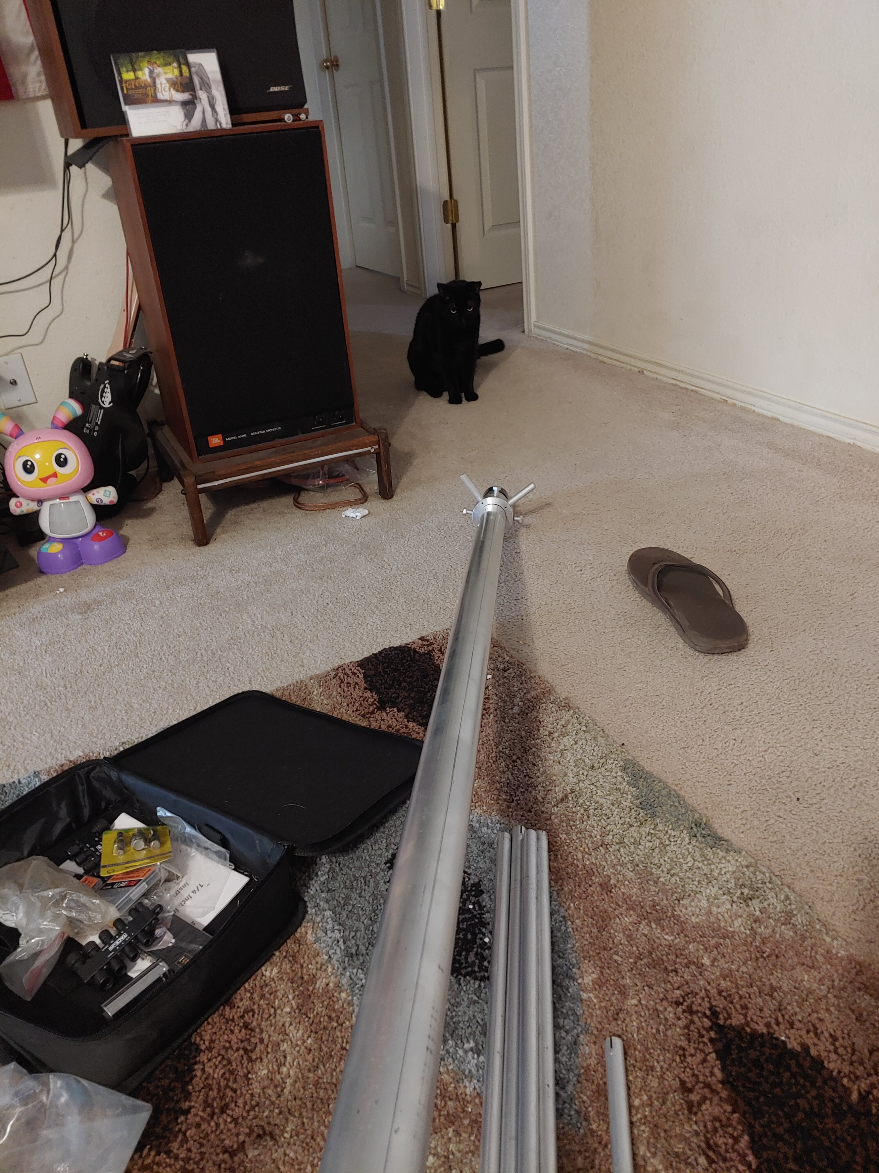

Antenna is in bits on living room floor.
Apparently Maco doesnt include the bit of masting to go from antenna boom to rotor because that would be too....hard..?
For a place whose business is based in aluminum?
Seems rediculous to me. It wasn't forgotten its not in the parts list at all. Odd as the piece IS required to have a functional antenna with a rotor?

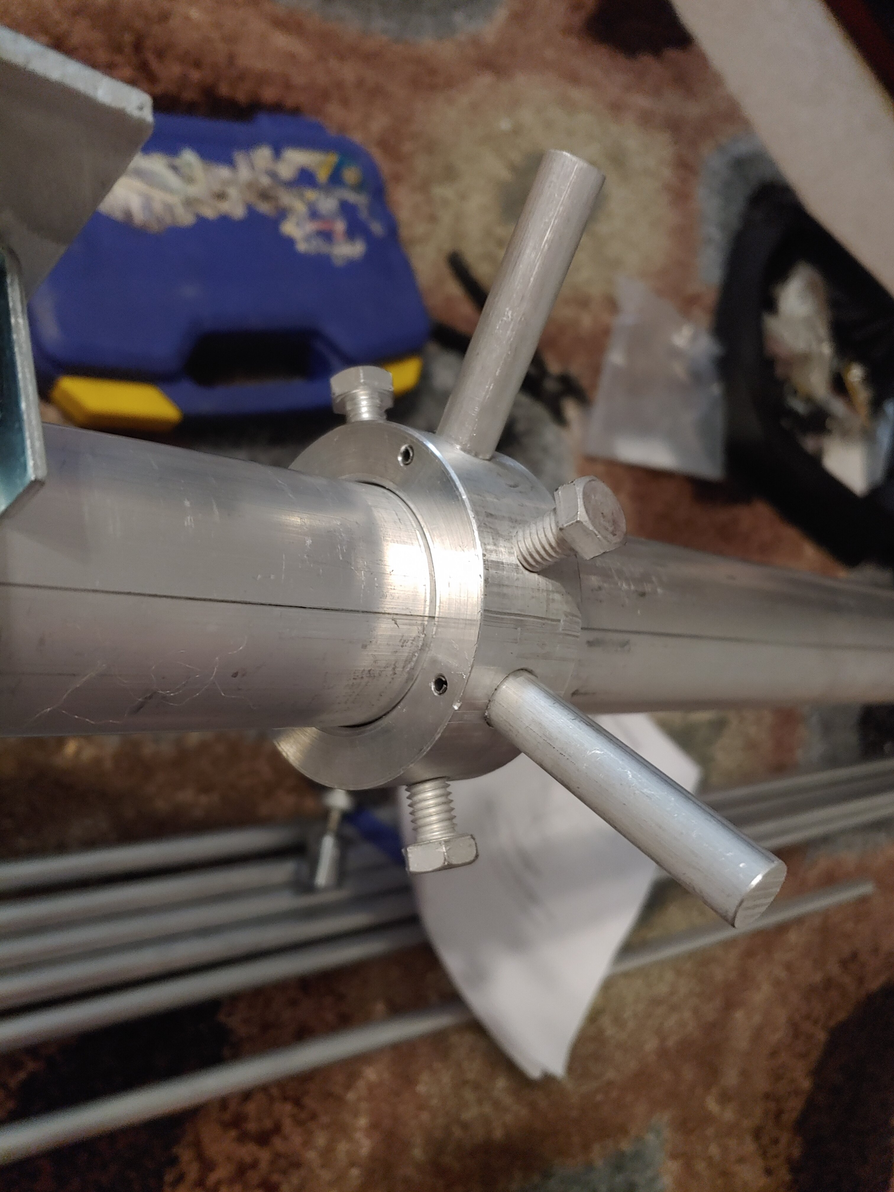

So far have the boom and rotor and boom to rotor splice sort of together next the positioning on the rings with element legs and cutting the wire to length rest will have to be done outside this baby is big shes over 13 feet boom length nm the giant triangles lol
Almost done all I can indoors. Sucks this TX HEAT is no bueno.
Do like Macos new milled brackets vs the old VQuad u bolt madness pretty trick.
Not sure if new VQuads come with these or just VQ3.
