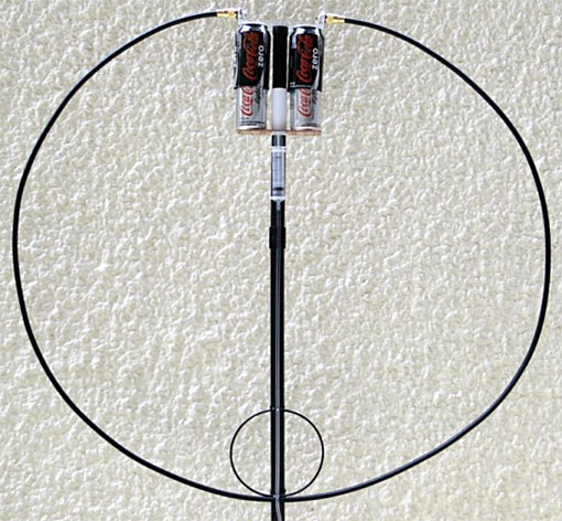

PY1AHD ALEX - Alexandre Grimberg - py1ahd
Also, MFJ makes a Tuner that is used with Your own wire loop, there is some good info here as well about the size of loop needed for different bands
http://www.mfjenterprises.com/Product.php?productid=MFJ-936B
[QUOTEYou can operate 3.5 to 29.7 MHz with a full 150 Watts. No ground, radials or counterpoises needed. A 13-ft wire formed into a loop operates 30-20 Meters (4-ft for 17-10M; 7-ft for 20-15M; 28-ft for 40-60M).][/QUOTE]
Jeff
