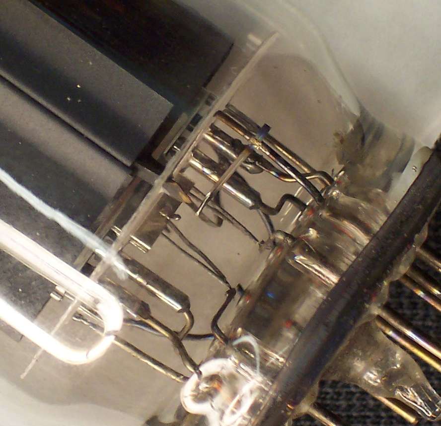

Ah, the infamous 8950 "cathode fuse".
Like this one. The bottom of the cathode is near the center of the pic, and has a tiny ball of melted aluminum where a flat ribbon made a right angle leading to pin 2.
The M2057 is pretty much a beefed-up 8950. Behaves pretty much the same but with more anode dissipation.

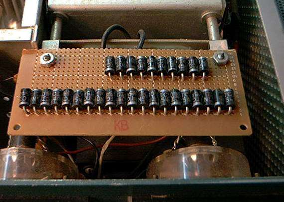

Mostly we use cathode bias with a zener diode only on larger transmitting triodes. This one is used with two 3-500Z tubes in the Heath SB220.
Not a big trick to wire thirty of them in series. Much more robust than the 10-Watt zener diode the factory used.
You would never use this many for sideband, but the 20 Volts you get from this setup is about perfect for running that tube in AM.
This is the board we use for that purpose.
Much less labor than drilling sixty holes in perfboard.
Reactions: Shadetree Mechanic
I've tried everything from zeners to zeners buffered by a pass transistor in shunt mode and absolutely nothing is as bulletproof as the diode string you're using there. They tend to survive even the worst internal tube arc.
