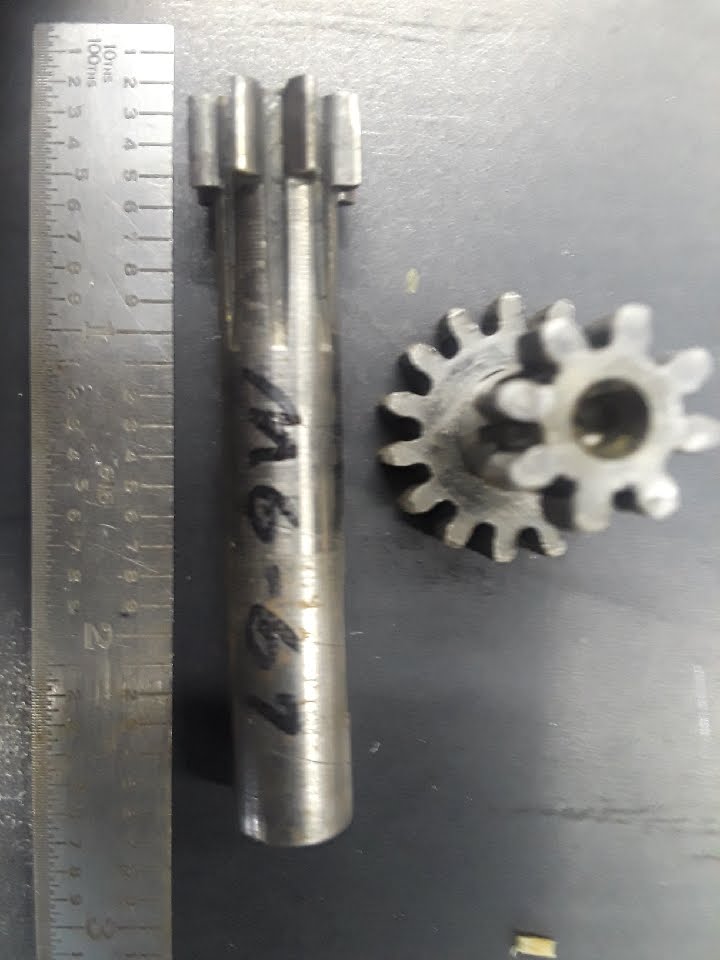

The change gears were really getting on my nerves.

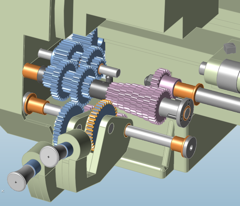

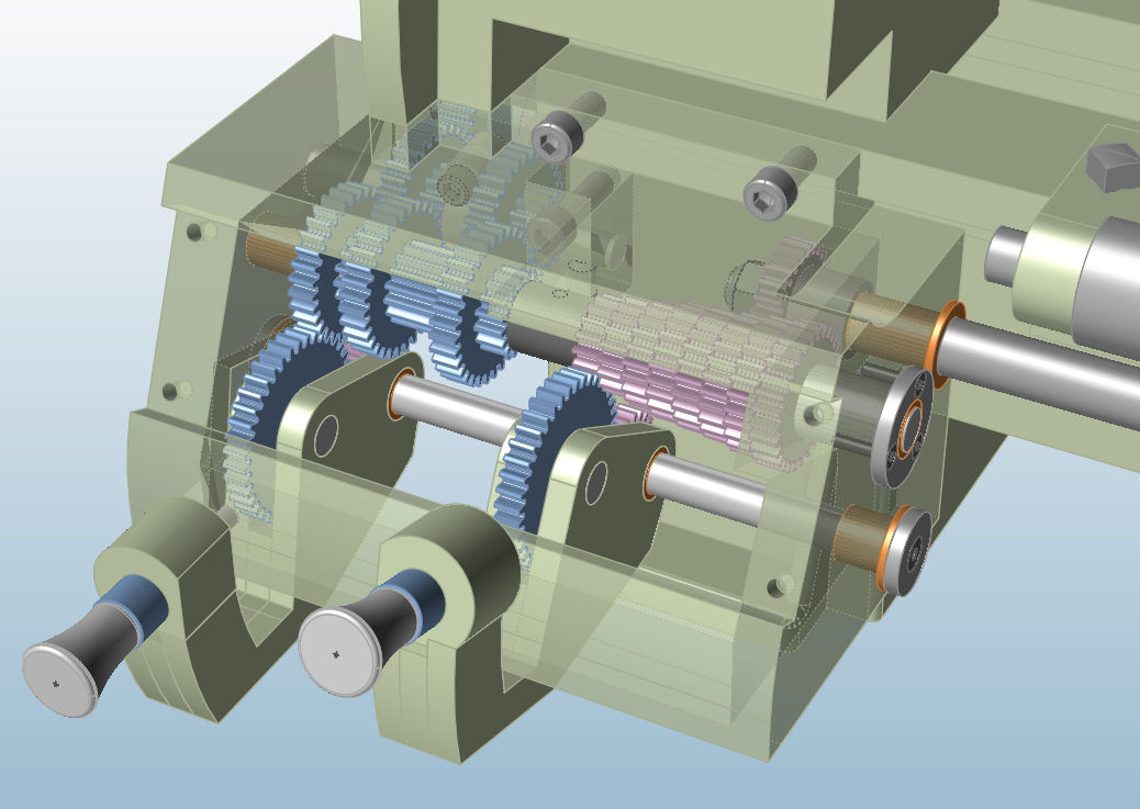

So a gearbox is the new order of the day.
Convince me you are serious in PM, or can contribute and I'll share code an BOM.
The current boggle is sourcing pinion/spur gear stock.
All the gears are 24 DPI 14.5 degree pressure angle.
I'd rather cut off and finish the gears myself as individual gears are $25 and up.
If I'm going to the bother of building one I may as well build a few, or at least the parts for a few.
Anyone that has 6" tooling they can spare can also contact me in PM.

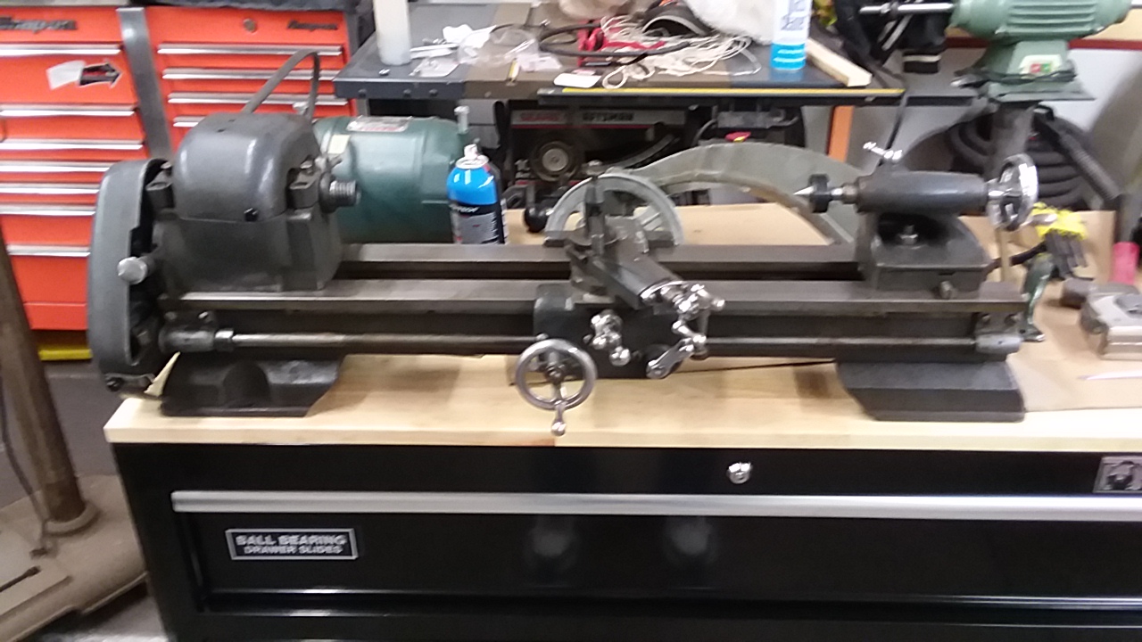

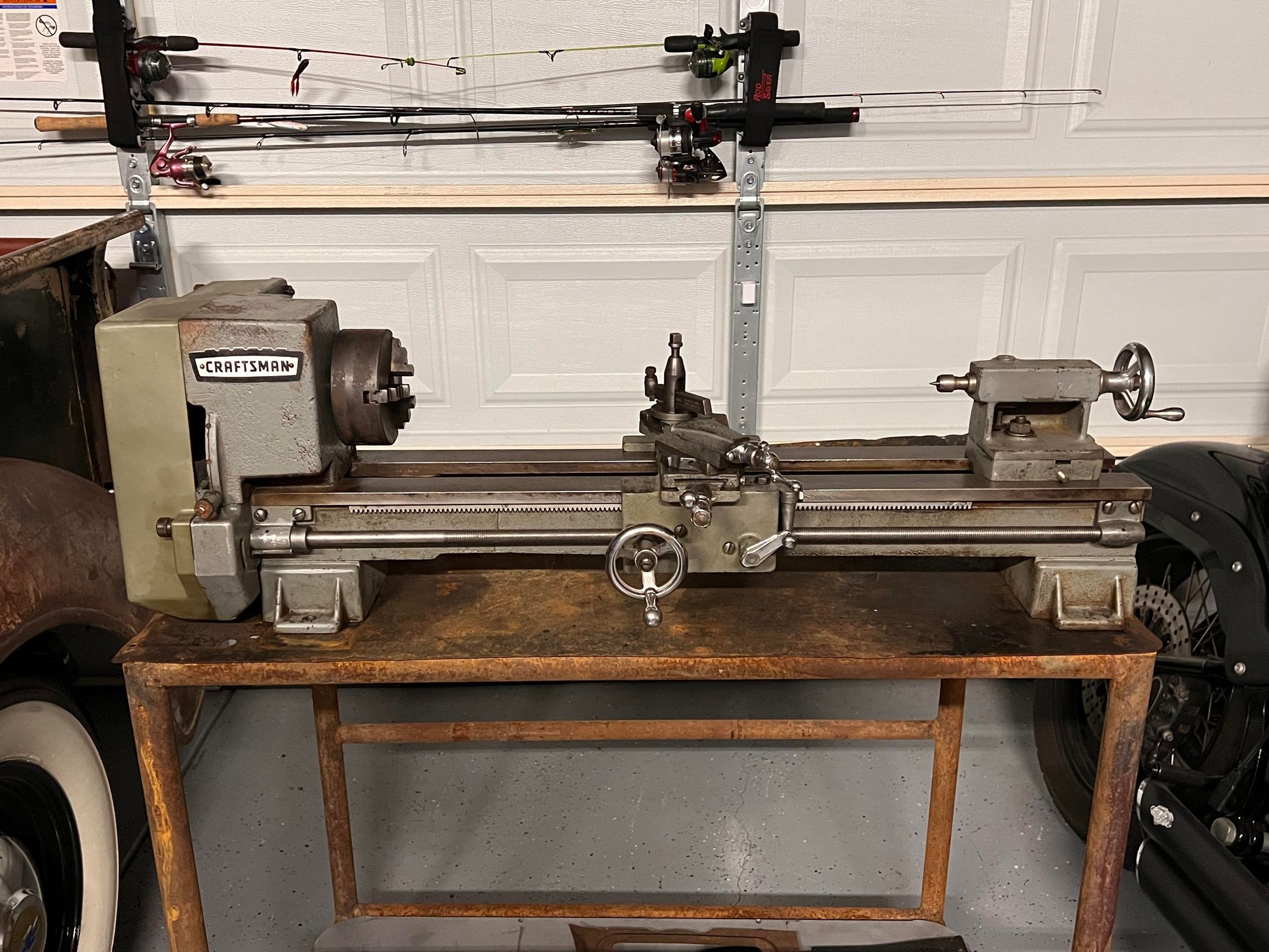

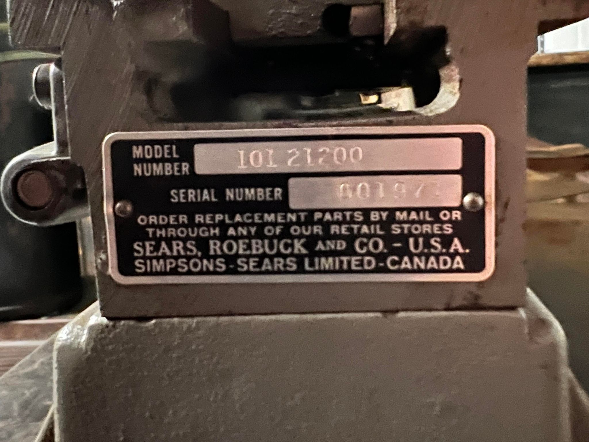

Gary , get me a pick of your data plate so I can keep an eye out for accessories. I think we share a bunch of common parts.
I am surprised how much I can buy directly from Atlas Clausing. I will get the info to you. The one I have is I believe from the 40's
The one difference that comes to mind is our spindles. Mine is 1" -10 TPI yours is 1" -8 TPI . We do share change gears though.
of course Kopcicle gets a lathe and the first thing he makes is parts for a lathe LOL.
How long before you're turning delrin on there for antenna parts?
