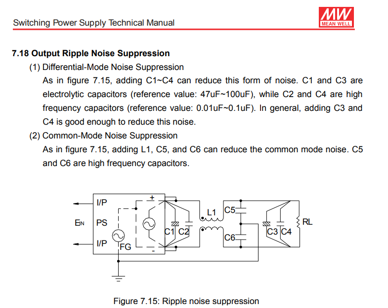

Since most users are into the 11-meter and above, the above "add-on" may seem redundant, but I found this article - a PDF attached, interesting due to the effects of Hash noise and even in typical radios - using IF strips that land in the frequency range, the noise leakage can be heard..
Since most use the heterodyne principle - the IF strips being between 45MHz to as low as 7.8MHz - the above additional support - being what it is, doesn't seem to be included unless it is for such specific purposes of having to use a switching power supply in the regions of where the ambient hash, being the switching noise itself as well as uses of components like Schottky - the effort of Noise suppression becomes evident in any case.

So yes, in the PDF they even admit they shed noise, and the many test tables that they placed it on, got turned on them because of the technology, being so efficient - may have left left others in the dust, but the EMI is still there.
