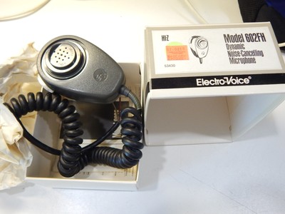

This guy has no clue what he's selling and it would be the best 20 bucks you ever spent.
http://m.ebay.com/itm/SHURE-602FH-DYNAMIC-NOISE-CANCELING-MICROPHONE-PAGING-DISPATCH-/302400536941
