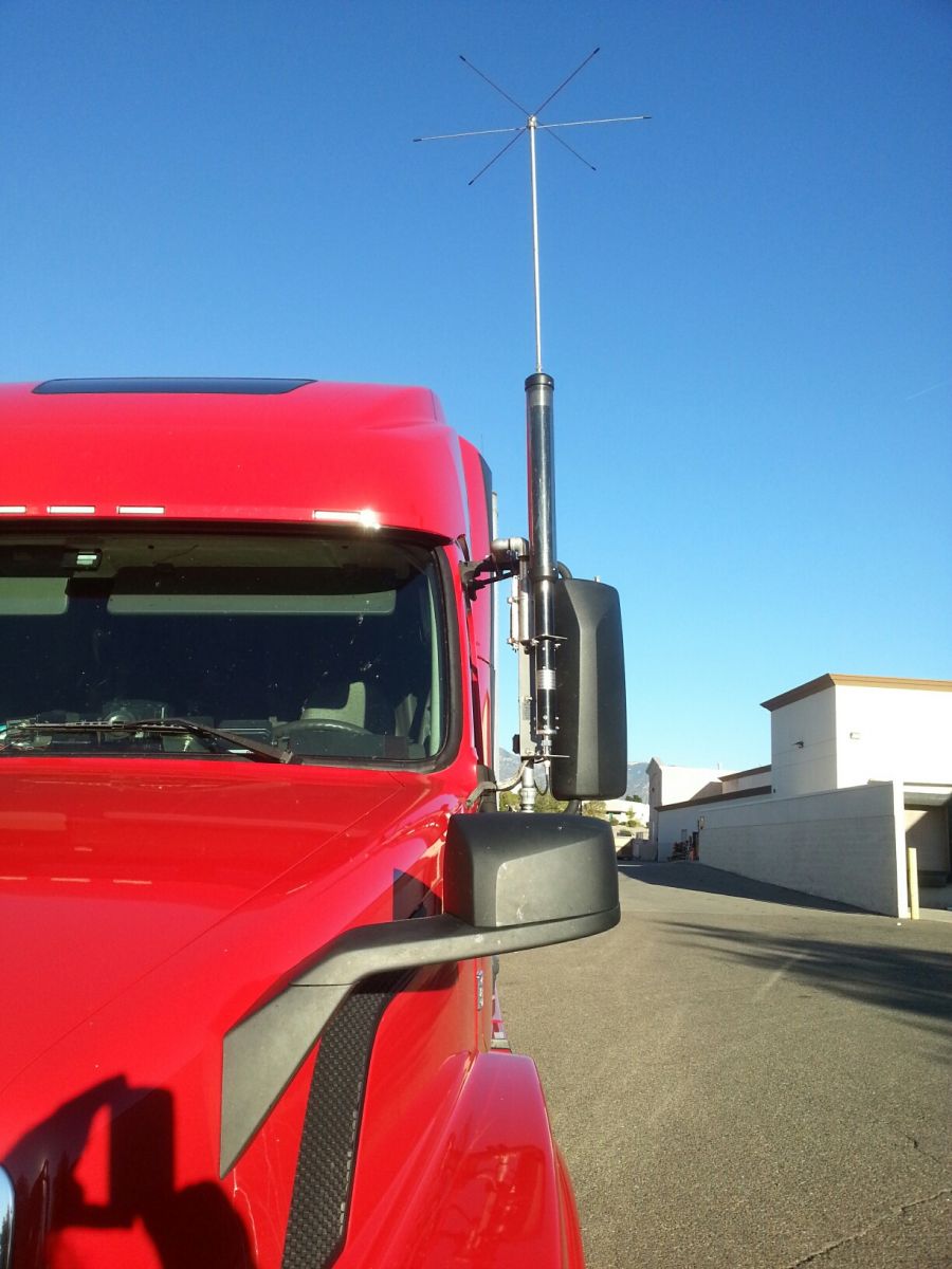

Here is my pic of my Volvo with a HF amateur radio antenna and you can see the coax and ground strap coming out from the corner of the hood where there is enough gap where the coax won't get pinched.

That's a very impressive Antenna and mount you have there I want something that isn't noticeable a perch would be more to liking , and I would get any Antenna installed at a radio shop
