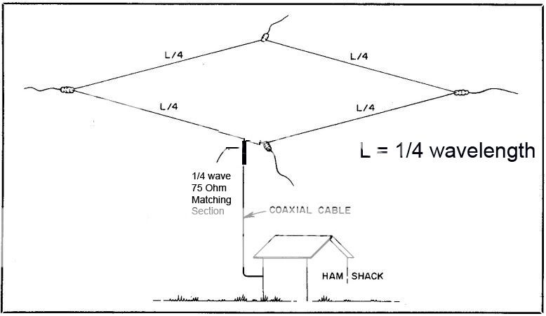

I know some frown on the idea of an indoor loop, but since you are in a trying something mood, maybe you'd like to try a full wave loop - roughly 4 x 9' continuous wire - around the perimeter of the ceiling. Feed it at one of the corners using a 6' piece of RG59 coax, then from there on into your radio with your regular coax.
Top right is what Doc suggested: (the dotted lines are preferred directions to run the feedline)
Loop: (diagram shows the loop outdoors. Your setup would be the radio placed where the Shack is located in the illustration)

ohhh ok, was thinking for some reason he ment to stand the whole thing straight up.
