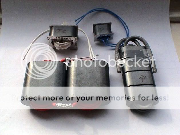

Are there any manufacturers left that produce monster cores like these beauty's:
I'm trying to convert the pdf data sheet of this Japanese company into a jpg but not having much luck.
Will try later.
The company have ceased producing these cores.
Dishtronix purchased the last 500 pcs for this baby: Dishtronix - Prometheus

Make your own!
Go shopping for the correct "Mix" and size, find some copper tubing and make your custom sized transformers by placing the ferrite core on the copper tubes and, soldering one end of the tubes together; this is where you are going to connect your "Vcc" voltage.
On the other ends, you connect the collectors of the output devices and the bases to the similiarly made input transformers.
You will probably have to experiment with the number of turns of wire on the secondary side of the transformer.

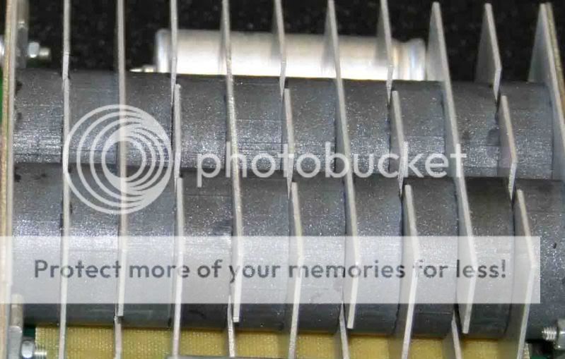

What do you think of this:
The thin metal tabs between the cores are like small heat sink fins to cool trafo structure. It is VERY effective.
