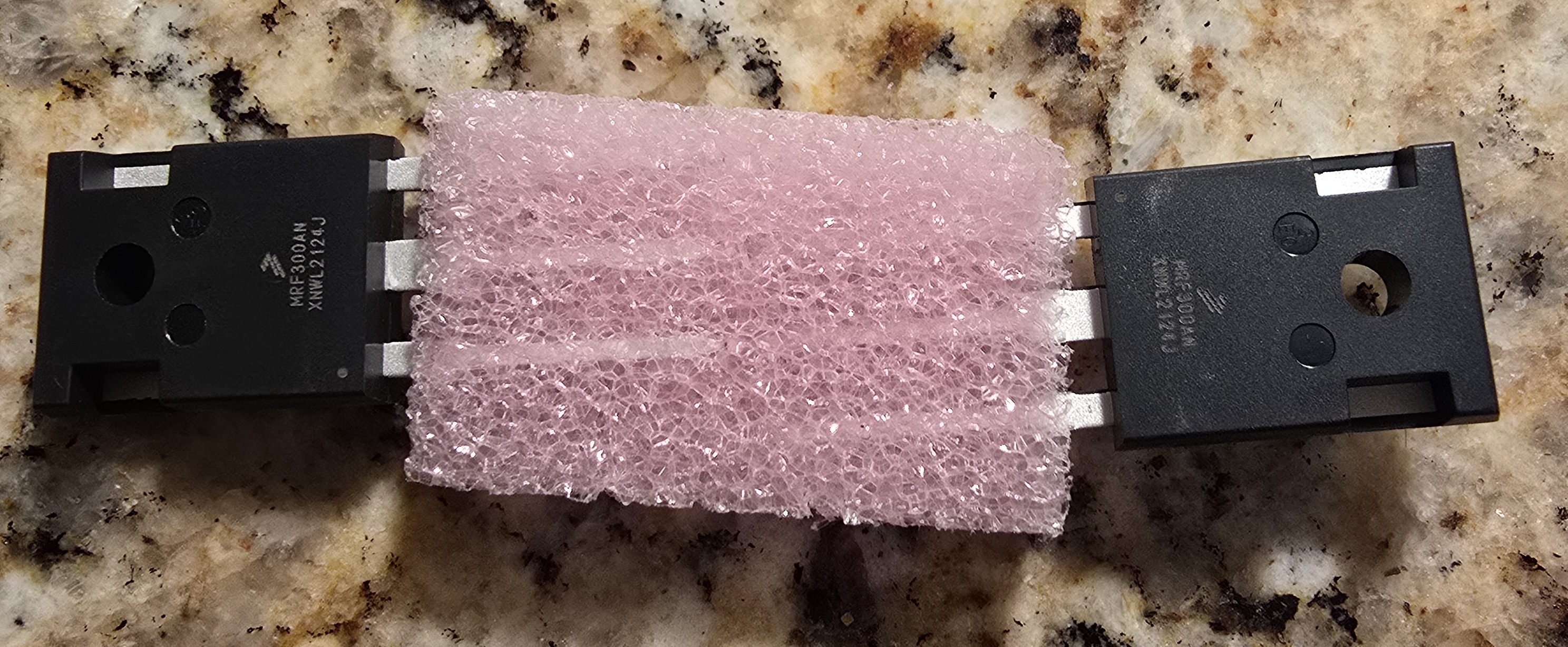

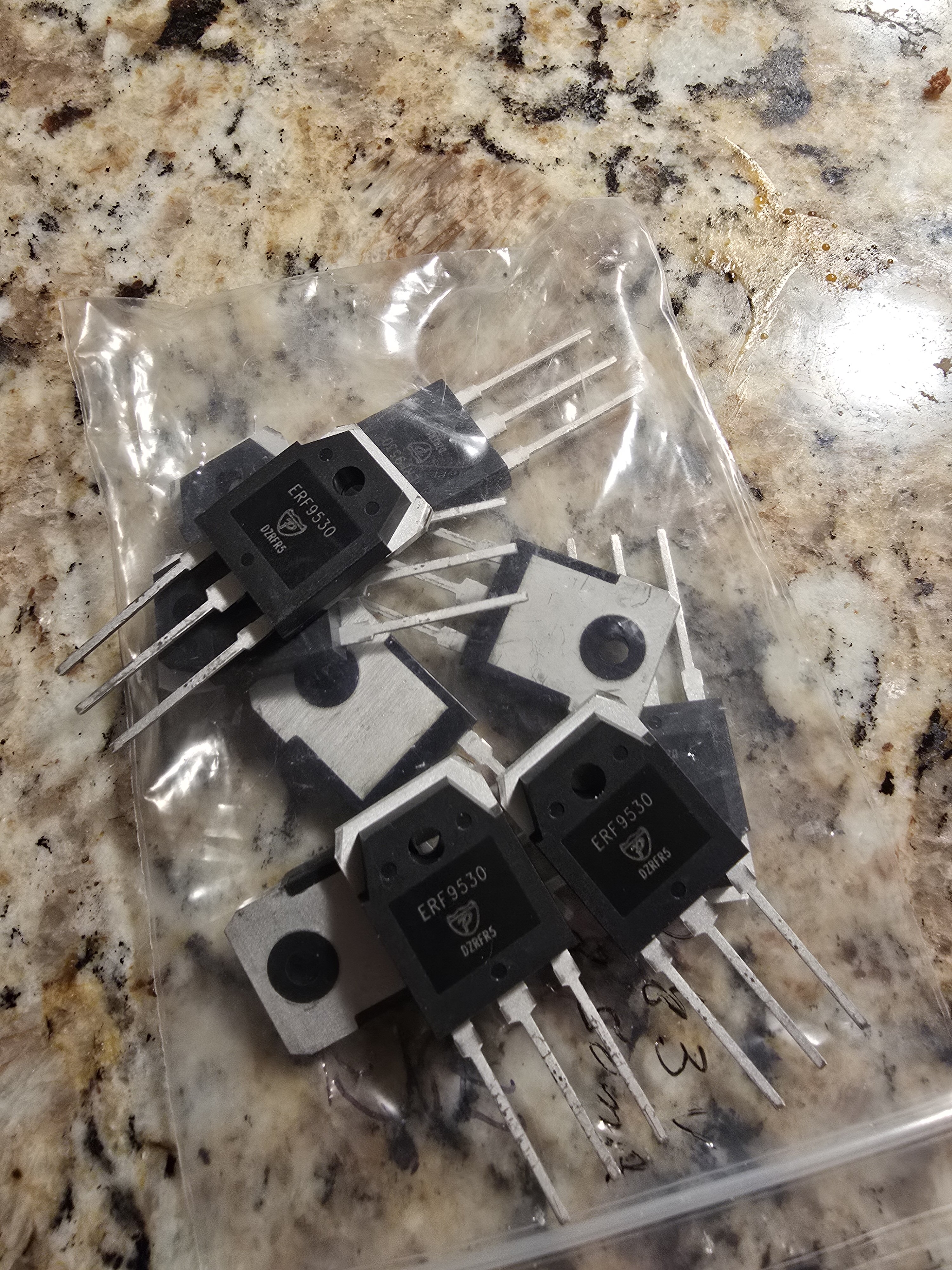

I have 10 of the ERF9530, 2 of the MRF300an, and 2 of the MRF300bn.

The ERF9530 was not designed as a RF power amplifier. Its original purpose was to switch DC power-supply current, typically in a switchmode regulator circuit. But it was adapted to use as a RF power amplifier because that type part is produced in large quantities cheap.
The MRF300 is a 300-Watt transistor meant for use as a RF power amplifier. The ERF 9530 will barely multiply the driver power by a factor of six or seven to one. The power gain of the MRF300 parts is closer to 100 to one, more or less. The A and B versions are identical on the inside, but have the pin assignments in mirror image. This simplifies circuit board design when using a pair of them in a push-pull circuit, one on each side of the input and output transformers.

I just looked into an amp I also got from the widow that has 4 of the ERF9530s in it. It must be one of those adaptations.

Those are the ones sold as "Palomar" by Eric Lewis or now Palomar electronics. They're used in the Palomar rfx-95hd or the rocket box amps.

I believe you are correct about them being ERF9530 (The amp I mentioned looking into is a Rocket Box HD500 MOS). At Walmart right now. When I get home I'll confirm it.

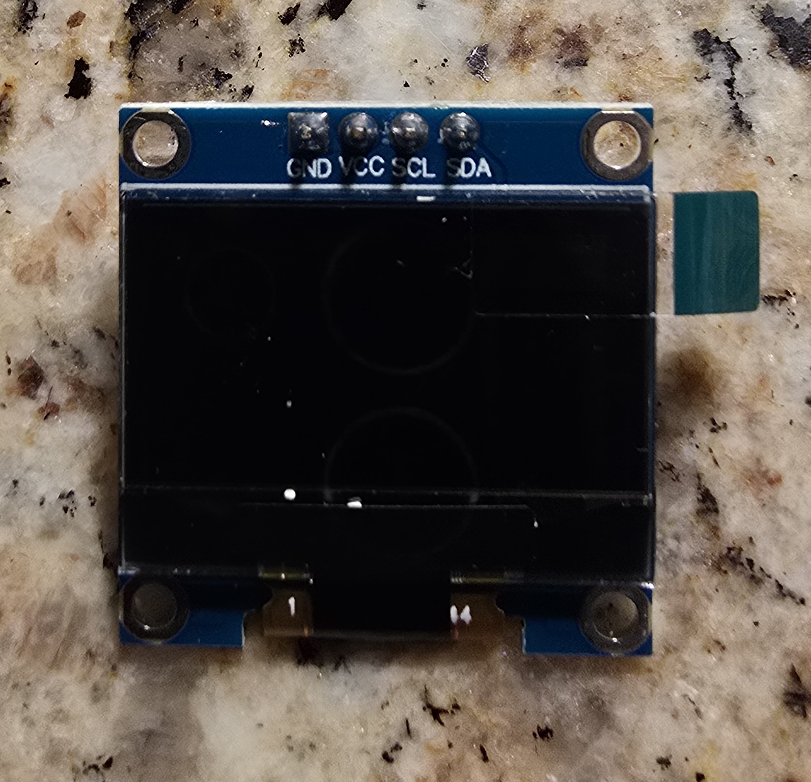

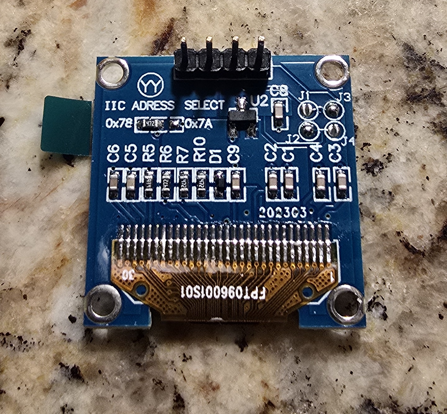

There is also this thing. I have no idea what it is.
AI says this, "The object shown in the image is a 0.96 inch I2C OLED display module."
