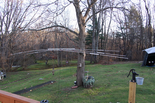

I put the antenna together as the Mini 33A and hung it from a branch on a tree in the back yard, hooked up the Coax and checked SWR with a MFJ 269. 20m is spot on 1.0:1 at 14.300, 15m is 1.5 and 10m is 1.9, I could have probably gotten them a little closer but the tuner will work on 15 and 10.
Hooked it up to the radio and went to the noisiest frequency on 20m 14.313, it actually does some pretty good rejection to the sides and with 100 watts got some great signal reports from down south, as its pointed SSW hanging from the tree. Cant wait to get it up on the tower, I'll have a friend come over with his Tree Service boom truck to mount it as I am going 10' above my Satellite array.
Now all I need is the rest of the parts, then I can give a true review of the antenna.
Here it is in the tree right now.

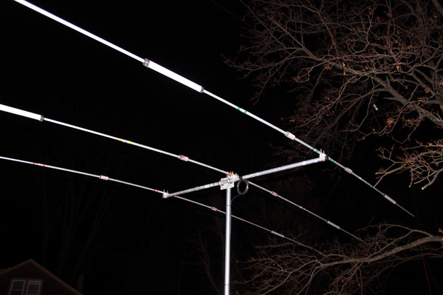

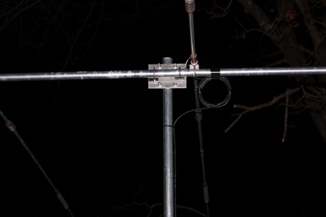

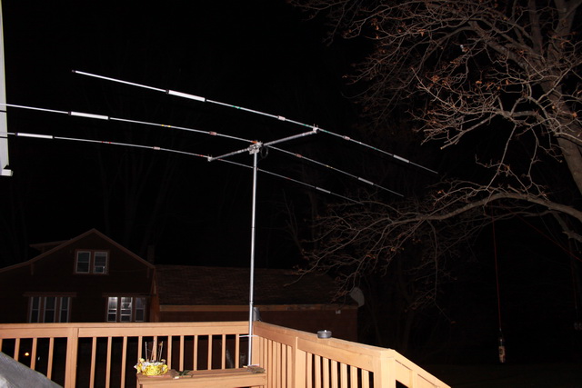

Well being the impatient person I am I built up a mast plate out of a piece of aluminum plate I got at a friends shop. I also pieced together some muffler clamps and got some long 8mm bolts for the rotor separation kit, just cut the heads off the bolts and now I have studs that will work just fine. Picked up a 10' Galvanized fence post that is 1 3/4" OD and it plenty heavy enough to handle this small beam. The missing plastic block that goes between the boom and the mast plate I made out of wood and coated it with liquid electrical tape. If I didnt have to deal with getting the antenna around the satellite array I would have put it up on the tower today, but I have to wait on a friend with a bucket truck to stop by. Probably Tuesday or Wednesday next week.
So there ya have it ... If the driven element insulator gets here before then I will add the WARC band element, if not its going up as a tri bander. :thumbup1:

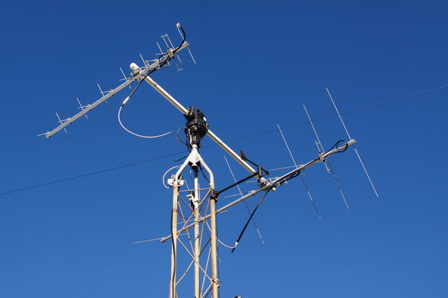

Why are you installing the HF antenna ABOVE the satellite array? Convention says to do it the other way around. The azimuth rotator turns everything and the elevation rotator is mounted above the HF antenna and elevates just the satellite array. You also do not have the satellite array firing through the HF antenna that way. Any pix of the existing satellite array and rotator assembly?
For right now this is the easiest way to do it as I don't have a rotor tray on the tower or a 20' mast. If I had the expendable extra funds I would go that route. I will most likely change everything in the spring and swap stuff around. The Tray, thrust bearing and mast will cost between $350 and $400 from what I have seen, probably a lot less used. I would also like to put the tower another 10' up then I could use a slightly shorter mast and not worry about the beam hitting the chimney. I guess I would need to take some pictures of what I am talking about to make it clearer. Firing through the beam should not be an issue, I'll make sure the HF stuff is off when using the satellite stuff.
