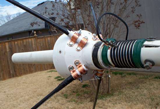

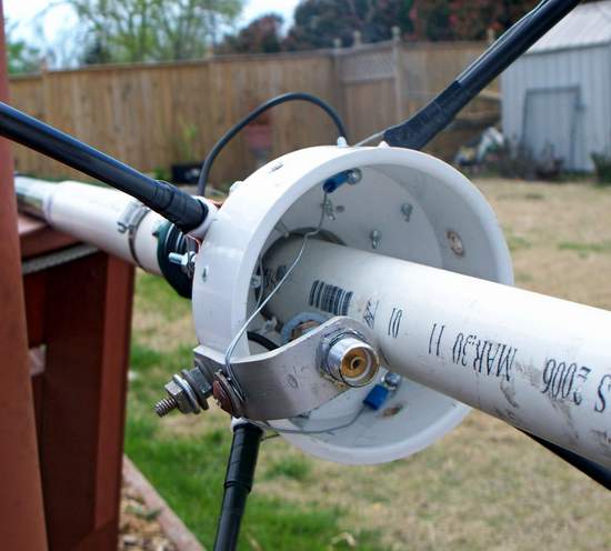

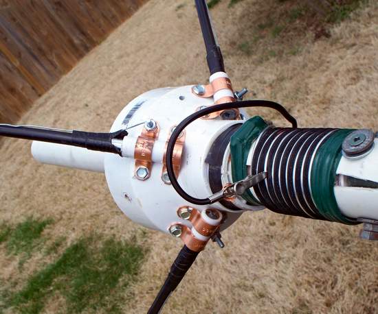

These are updates from today
I intend to paint it all gray to look better.
The SWR are pretty good.
Flat 1:0 at 27.195
1:2 at 27.405
1:2 at 26.965
I am probably going to cover the exposed coils and the PVC holding the vertical element with fiberglass to protect it and reinforce it for additional strength.
