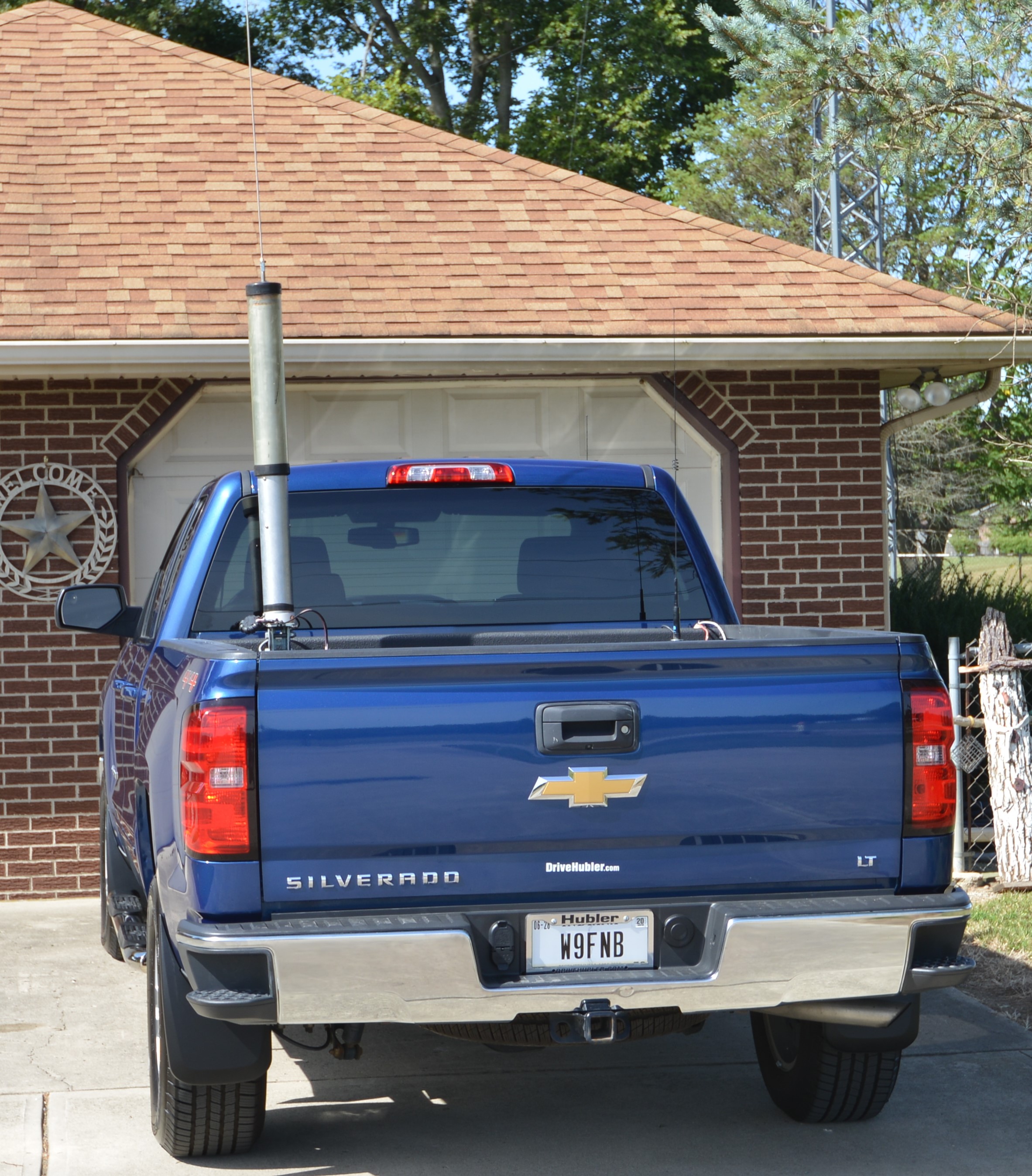

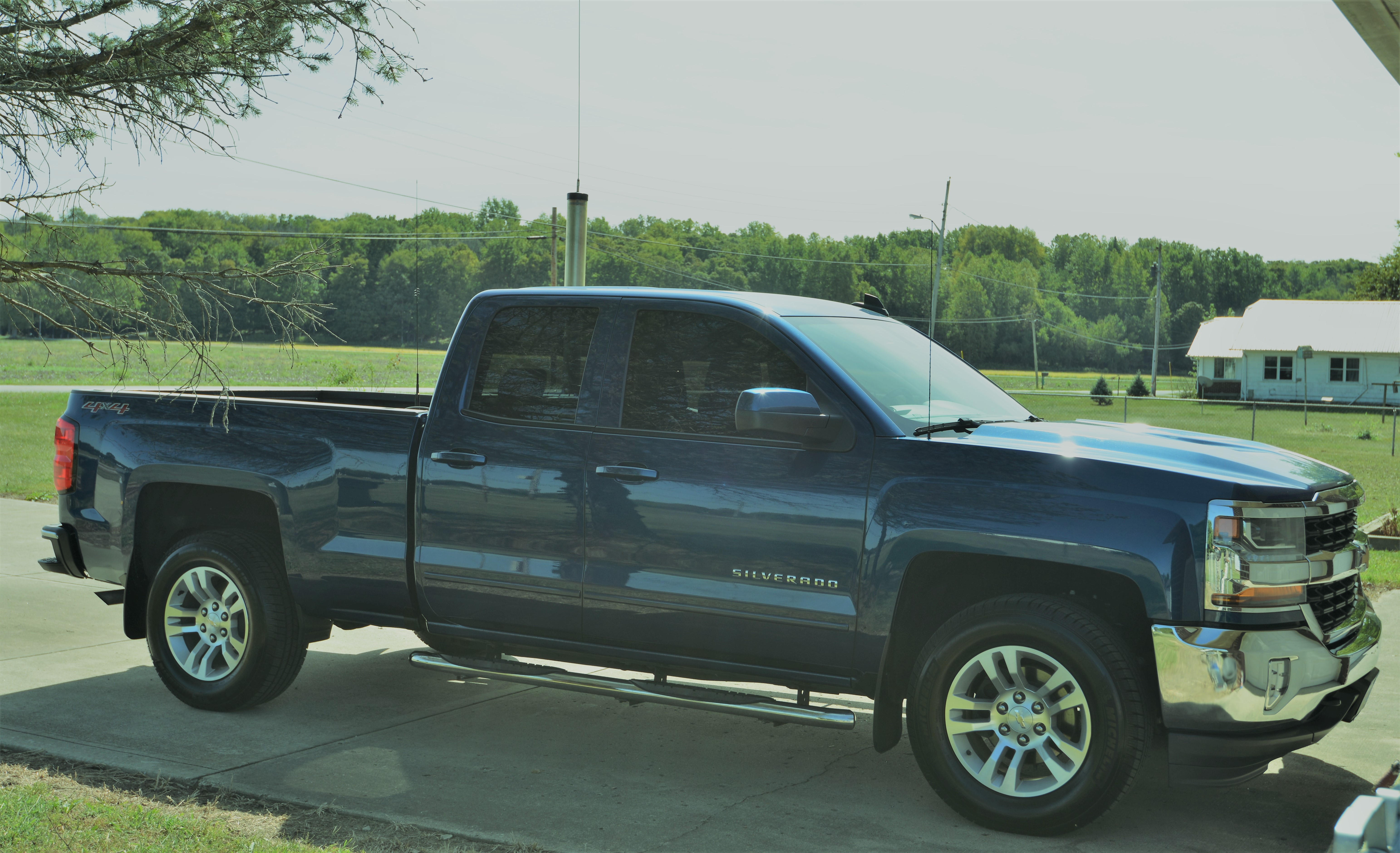

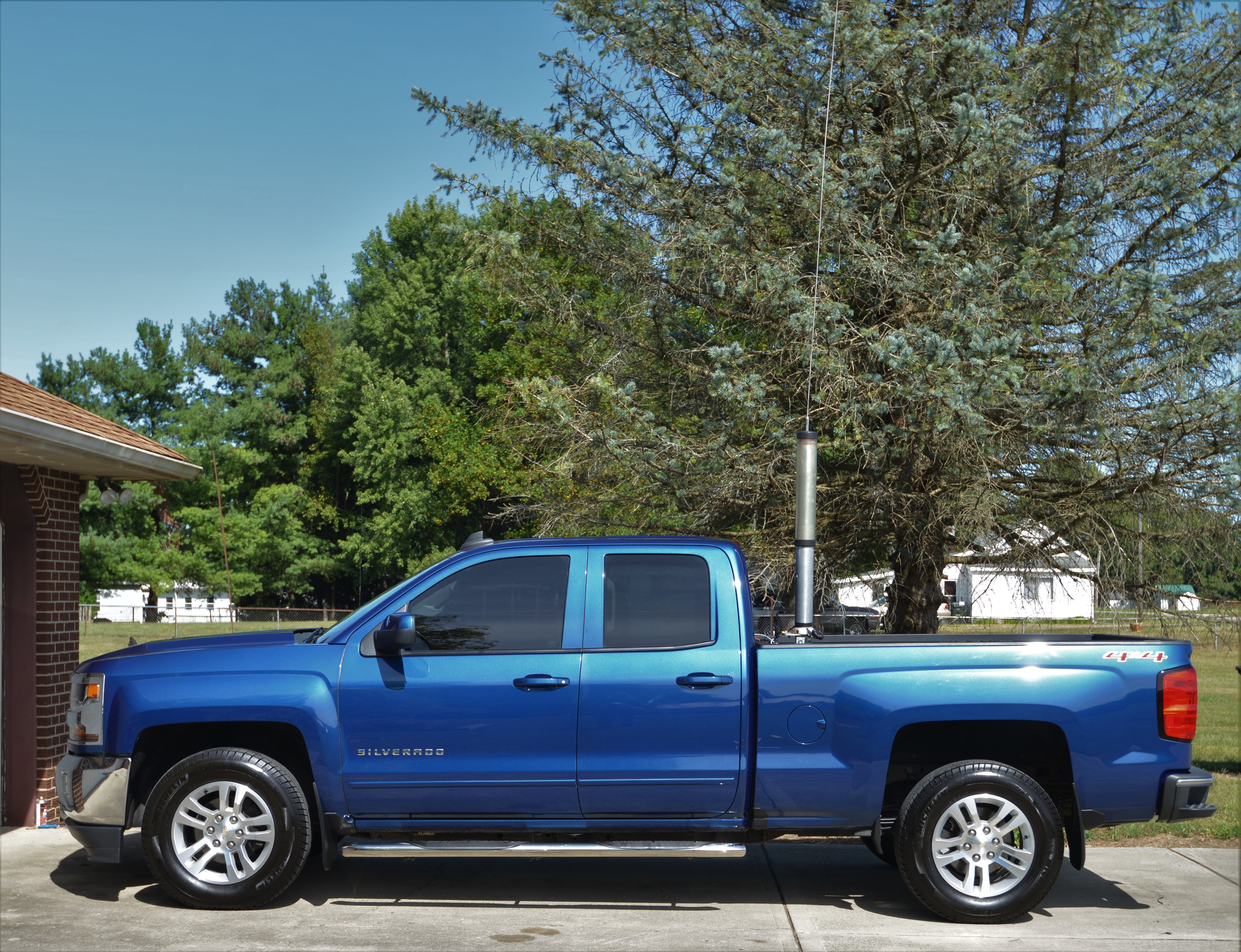

My 160 thru 440 MHz mobile.
Road Trip Ready!
Headed to Chicago for a family reunion on 9.27.2019
ICOM IC7100 for 160 thru 10m (@ 100 watts) 6m (@ 400w)(y)
2m/440 @ 50 watts
KJ7U Screwdriver Antenna
Diamond 2m/440 antenna
Weather report looking good!
Flight Plan laid in!
All the Best
Gary/W9FNB
PS: 2017 CHEEVY Silverado 327 V8 multi-port FI...4x4 with Z85 sport suspension/ with towing package /6-speed w/ manual/auto shift overdrive tranny

How do you like the KJ7U Screwdriver Antenna? Been thinking about a screwdriver antenna but I'm never mobile that much to bother. Might go with a 6m antenna next summer on the truck to go with the Comet CA-2x4SR 2m/440 already on it.
Is that a 102 whip on top of that?
Yes, it is! like 14+ ft to the top. That makes the antenna on 6m a 3/4 wave antenna using almost zero loading coil. Works well.
Also really makes tuning 75m phone band work well also.
CK: I've had this screwdriver going on 17 years now. 4 different trucks. Been a Great performer.
He custom made that for me. The coil is 60+ turns on a 3.5-inch shaft made of #12 solid hard-drawn copper wire connected via solid brass finger stock at the top.
The main outer base shaft is 4-inch aircraft Aluminum, inside is a worm gear driven by a variable speed Black and Decker reversible 12vdc screw gun motor in the base.
It's a talker even on 100 watts on 75m.
