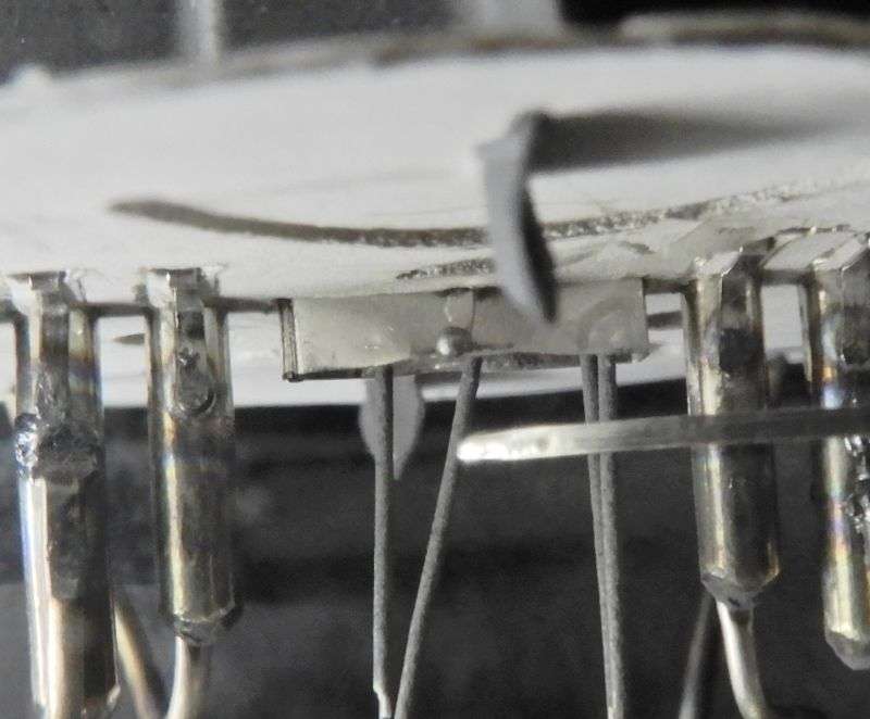

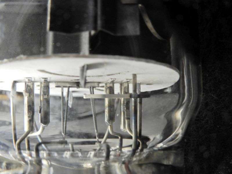

In particular, we see the tiny ribbon at the bottom of the tube's cathode becomes a weak link. Leaves a broken circuit that looks like the failed element in a glass fuse that has tripped from a slow-to-medium overload. Leads me to think that RF current will release more heat where the RF resistance is high, or reactance creates a voltage drop. Turns out that operating an amplifier out of proper tune will speed up this exact failure. Seems to afflict the compulsive knob twisters. They ones you hear tuning up, turning the Tune and Load knobs every which way looking for a little higher wattmeter reading.
The tube has one pin connected to the cathode. In this case, the 6LF6 and 6KD6 tubes used in the Palomar 300A use pin two.
The pin itself is spot-welded to a tiny thin metal ribbon. It leads to the base of the cathode sleeve that encloses the heater.
I suspect it's just a tail that's part of the pattern when they cut the cathode blank from thin sheet stock.
It melts just below the cathode, leaving a visible gap like the element of a glass fuse.
