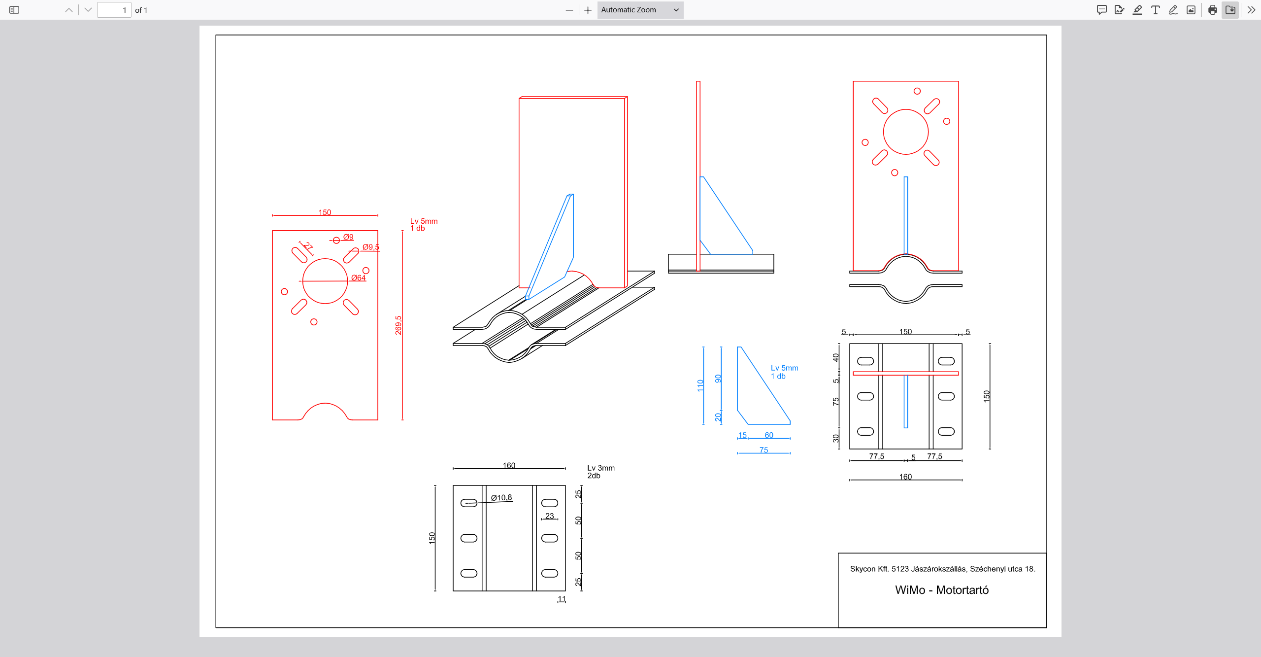

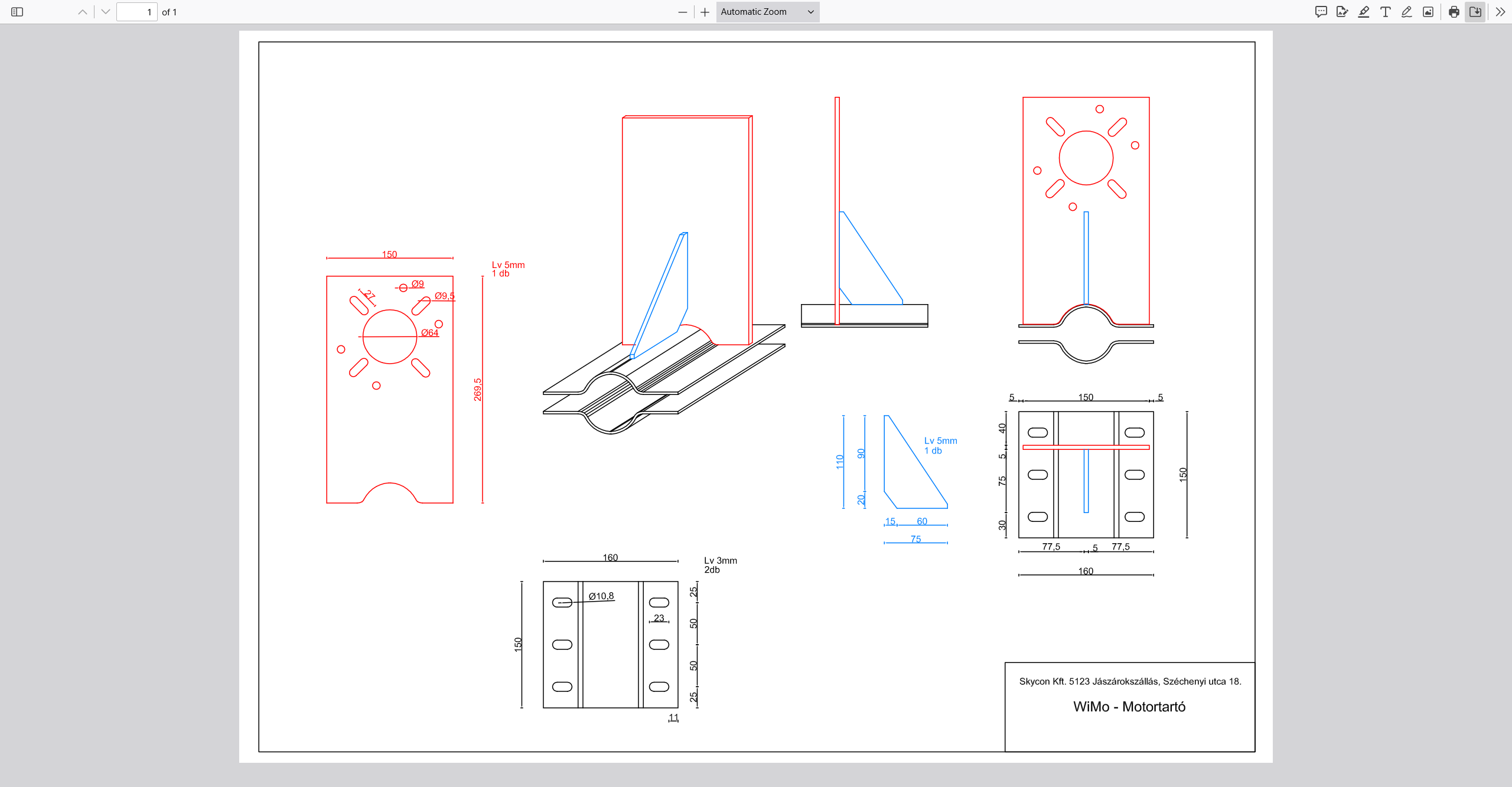

And what is the mast shelf / clamps being used with the rotor and the thrust bearing?
DXE sells the rotor platform but it was out of stock when I was looking for them.
I bought the same pair direct from a company in Germany for fifty bucks cheaper with shipping. I also bought the thrust bearings from them which were priced good and to be sure they matched up with the platform holes.
The bearing holes are supposed to match up with Yaesu thrust bearings and rotors. My rotor and bearings were a perfect fit.
I do strongly recommend you use 2 rotor platform plates and thrust bearing if using a heavy antenna on a pole like I'm doing. I believe you can see why that is.

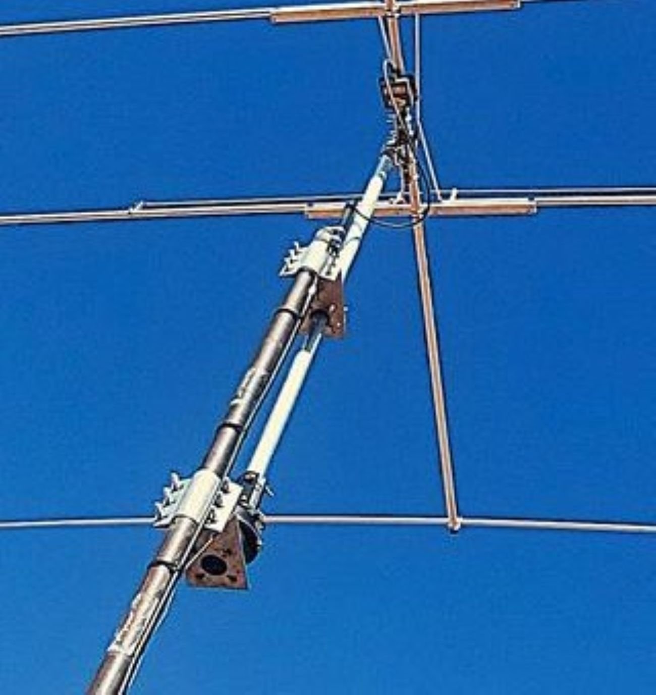

Good morning:
Do you have any photos of how your assembly with the GPG-60 platforms turned out? I've found some information about them, but nothing concrete. I'd love to see a real assembly of these platforms already installed with the rotor down and the discharge bearing in place, etc.
Thank you very much and best regards.

Good morning:

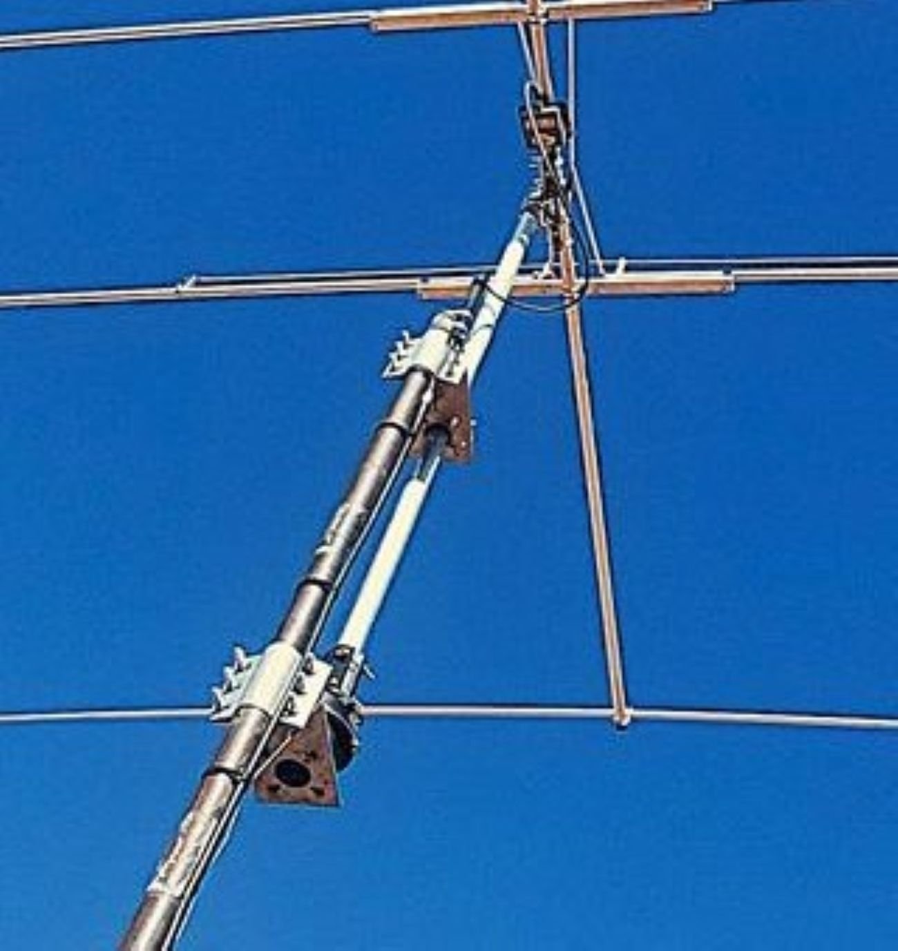

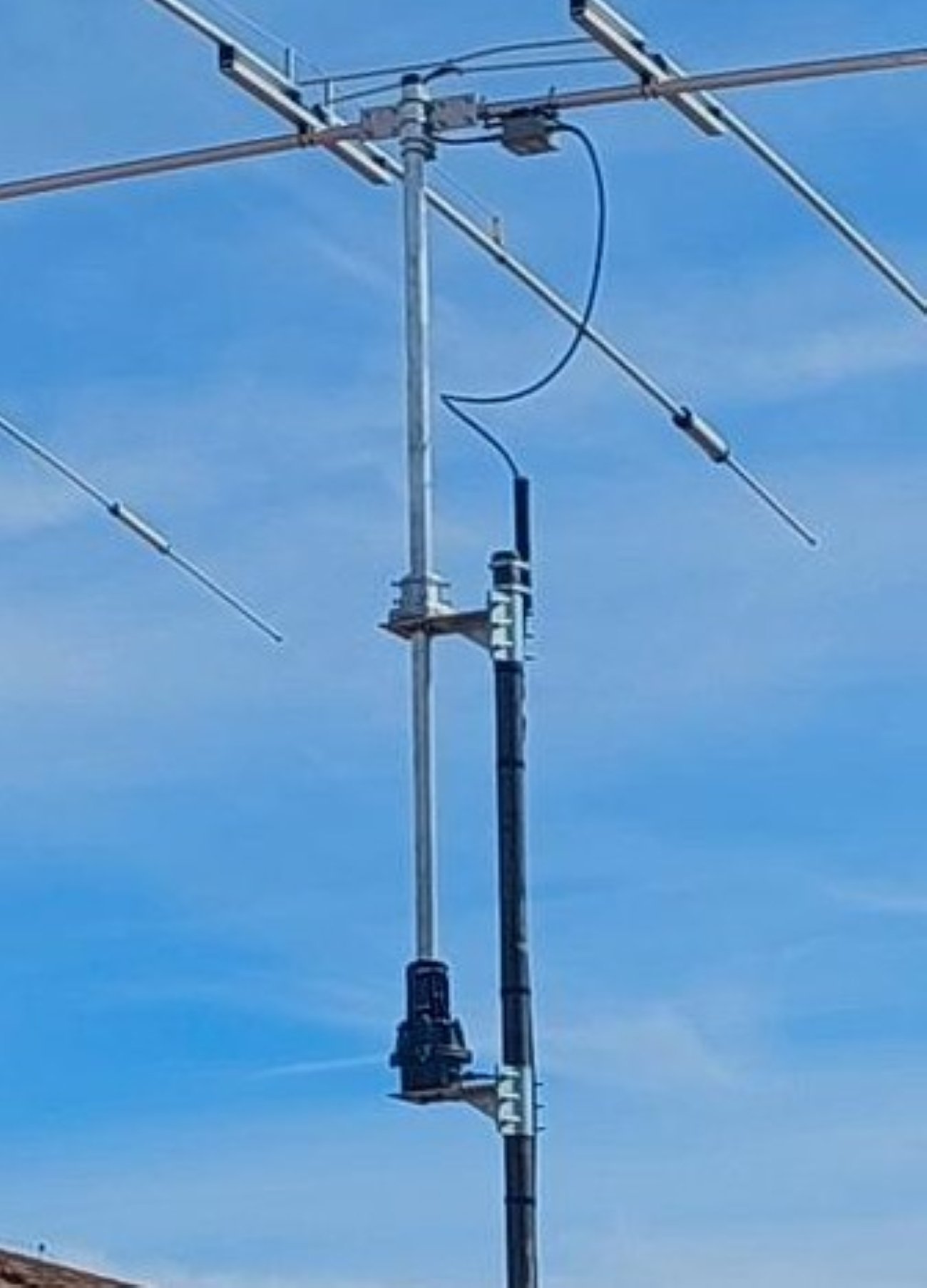

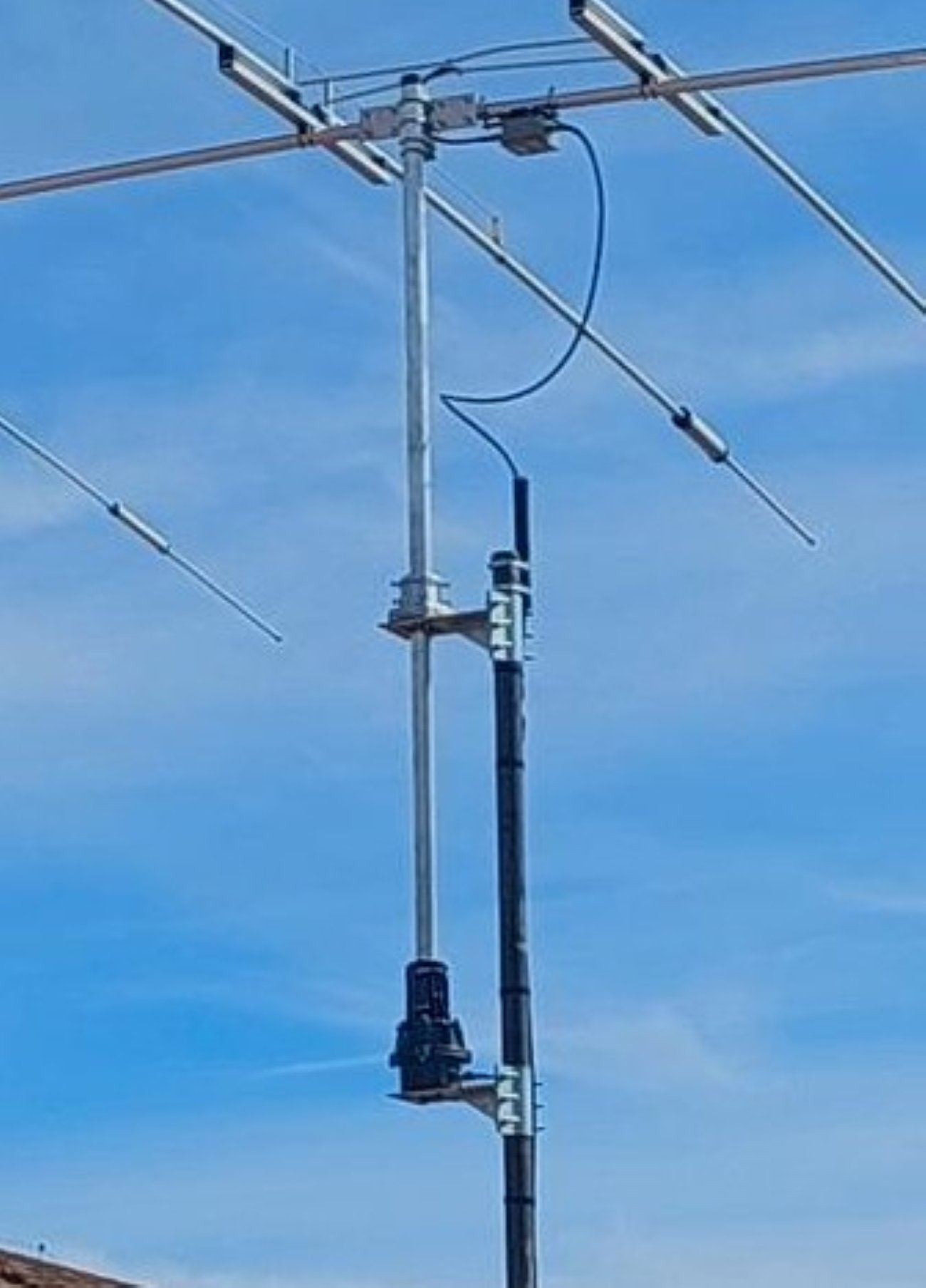

Haven't had a chance to respond on the forum lately but here are some pics.
These platforms fit the Yaesu and other thrust bearings along with Yaesu and other rotors.
Here are the spec's
I don't think I've ever seen a thrust bearing setup on a pole. Always on a tower! Very cool! 73, Brett
Thanks!

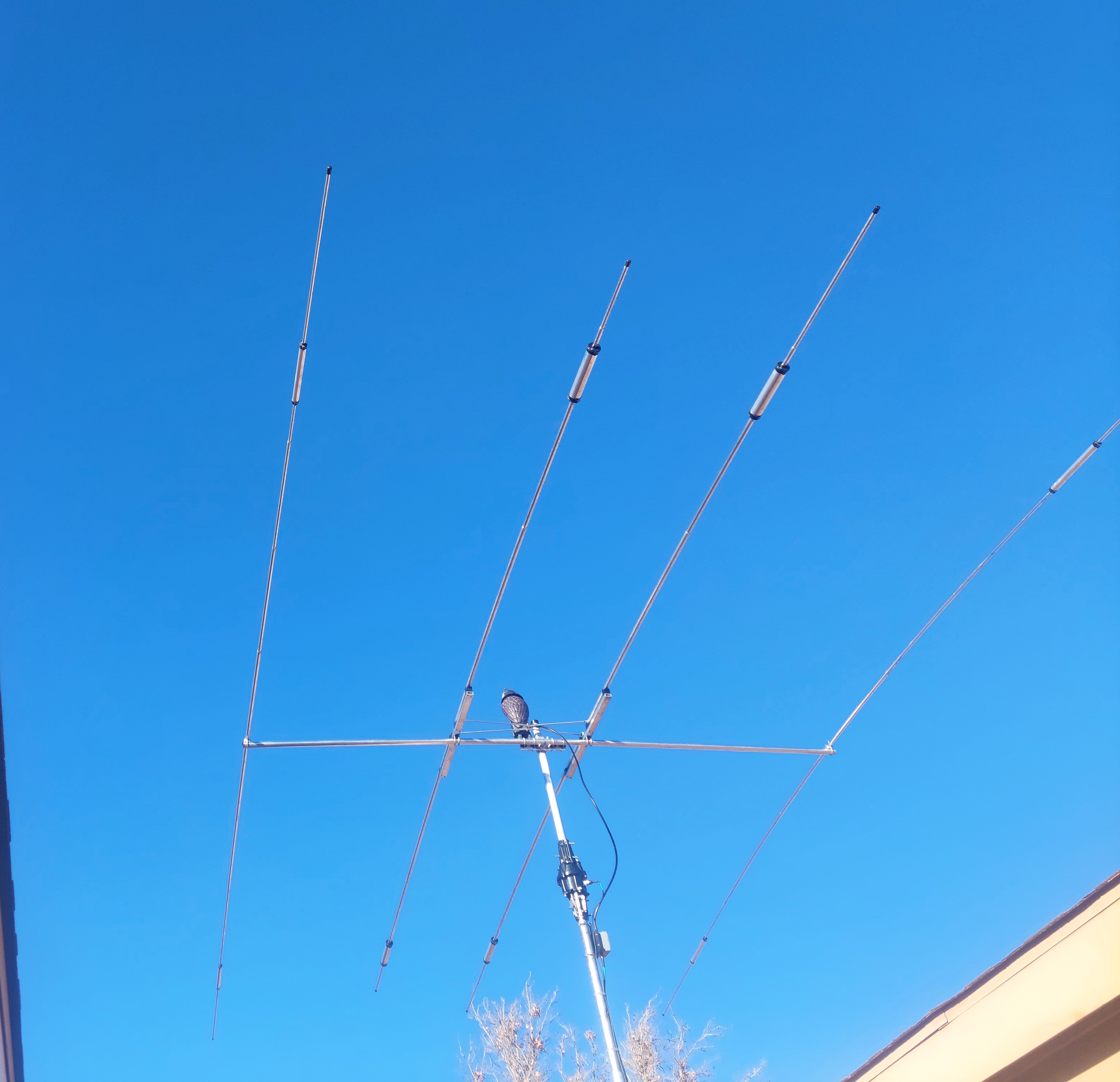

Even though there is much more extra weight added on with those platforms and thrust bearing on the 2 inch pole, it is a night and day difference in terms of weight distribution and sturdiness compared to when I originally had the rotor and antenna mounted directly mounted to the pole.
Here's a pic of my original setup that would wobble in the wind and was putting to much stress on the rotor.
