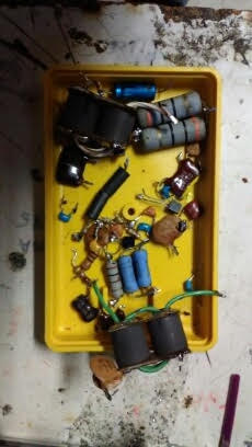

Have you tested the parts to see if they are good and within spec.? No magic in the box apart is either good or bad. Since you already took them all out might as well test them! Anything that is out of spec replaces and see what you get.
You kids today give up too easily. I have 3 boys and my younger two give up before they have hardly even tried. You wont get any place in life if you give up this easy.
Since someone has already done the hard work and designed this unit, loaded up a schematic and invented the internet at this point you just need to follow a good plan of action. You have a multi-meter, a soldering iron, the schematic and the parts so just start at one end and follow the circuit! Until you do that and give us more specific info none of us can help you.
You are half way there do not give up! Relax the process is the process and trying to rush things or find the easy answer will not help you. If you where my boys I would not tell you anything different!
Just get back on that horse! When you get frustrated stop and go have a beer or watch some tv, lift weights whatever it is you do to let your mind unwind a bit!

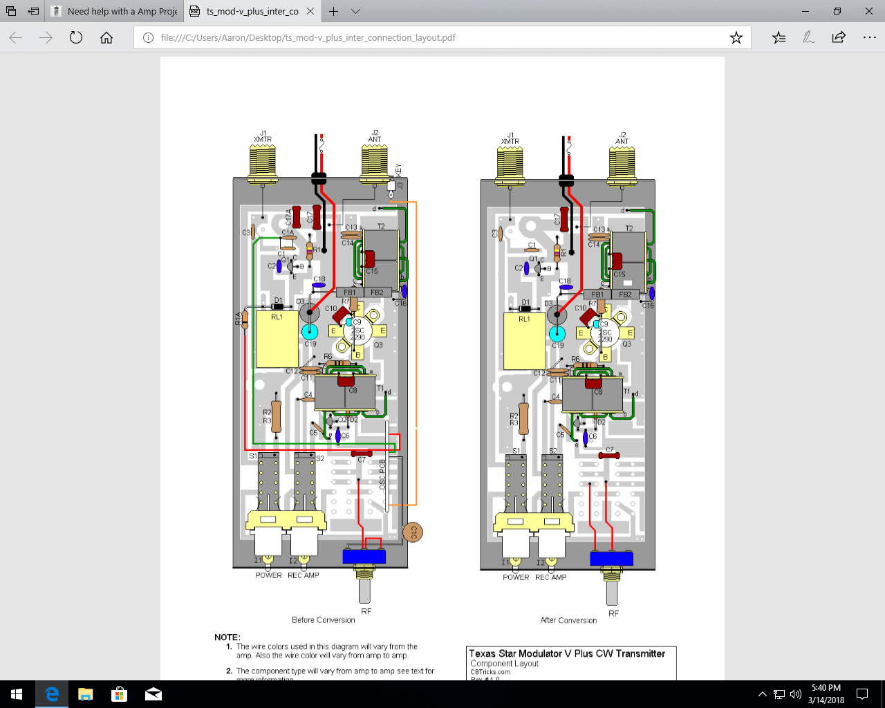

RF electronics are a finicky beast and exact placement on the board for some of those components is essential for proper operation. I'm not talking about which trace it gets soldered to, im talking about where on the trace the part sits.
I know you are here hoping that someone will be able to spoon feed you all the answers and walk you through putting the amp back together, but that's not going to happen.
no tech would even take that amp in to fix themselves much less try to talk you through the whole process. the amp isn't worth the money it would take to get it working.
The motorola circuit you found in the datasheet is a guideline for engineers to use when they design an application for that transistor and is by no means a complete amplifier.

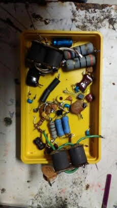

Before you took it apart it was an amplifier. Now it is a DIY amplifier kit with no assembly directions. Well, a partial kit. If it was not working before being disassembled, one or more of those parts is probably no good.
The relay looks as if it has had a hard life. Any time the protective cover is missing you will usually find the contact points are damaged. Can't adjust the contacts on this type relay. Just have to replace it when it fails. Good chance yours is bad. RF Parts sells that relay.

Generally, I take things very slow and methodically and test first, read the schematic or service manual, test again then act! I never try to wing it I always start with plan of action and work that plan! Sketching things out on a notepad is a time-tested technique when walking into the unknown. In today's tech though you would just take a photo with your phone.
A good mechanic or electronic tech would troubleshoot before doing anything else. Do not just tear into shit and start taking things apart that is a terrible way to go.
If you have a good working unit to compare too that helps when you do not have a service manual.
You do not just have an option of building a keying circuit without the relay. You missed something in translation. You will have the relay which is a common item and you will have a keying transistor. Normally one of three things goes bad in a keying circuit for a gray market linear the relay, the cap for the relay or the keying transistor. So after you find out which part is bad you replace it in the system.
That said since you have not tested anything you do not know what needs to be replaced to restore function. At this point, you do not have an amp that needs repair you have a box of subject parts and a pcb. So you need to rebuild the amp before you can build the keying circuit.
THink of it like this. If you tear an engine apart and install a new starter it does not do any good if you do not have a functioning engine for the starter to spin. It is not an either or it is an all or nothing situation.
