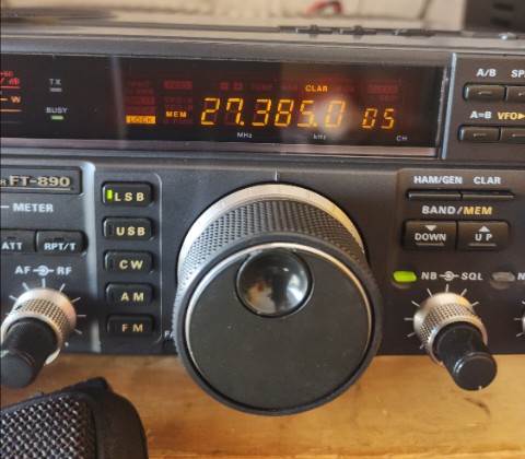

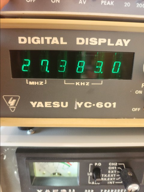

OK This is what i meant Look at the pic i waited until i got my ft-101e back from having it fully aligned with digital radio freq ends in 50 This is for SSB only on yaesu 101e The receive and transmit for lsb=27.3830 and USB= 27.3860 all figured out once i got the yc-601

Are you recalibrating your dial when going from AM to SSB? Check out page 10 of the instruction manual:
It looks like the VFO does the same thing no matter what mode you select. In other words, changing from AM to SSB does nothing to the VFO output (the thing with the vernier dial, unfortunately). It is the job of the individual oscillators on the mod/osc board to shift the frequency for SSB. Because of that, the vernier dial needs to be adjusted for each mode. When you got it tuned up at the shop, the dial was probably calibrated in AM. That same page explains how to calibrate it when switching modes.
In support of this theory, the digital display you have operates on that same VFO signal (that needs to be recalibrated for the mode change). There is a frequency counter option for the FT101 that samples the RF output, but the display you have samples the VFO output instead. So if the VFO vernier scale has not been recalibrated for the mode change, I could see that being an issue.
Reactions: Naysayer
That counter reads ONLY the VFO frequency.
But the VFO gets mixed with one of three carrier crystals to match the selected mode. That's one of two reasons for the calibrate knob. This lets you move the reading up or down the opposite amount the carrier crystal moves your frequency when changing modes.
The SECOND source of error is the band-select or "HFO" crystal. They are usually within a couple of kHz of what's marked on them. Likewise, that calibrate knob will compensate for this when changing bands.
But this display is only correct when you calibrate it again every time you change band or mode. It will only be valid this way, and changing band or mode will instantly introduce some error in what's displayed.
