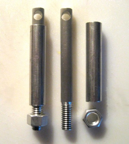

Question 2: I came across these gamma studs on eBay. States it fits MR 4 and “some” MR 6 antennas in the description. Again, I’ve done some digging and unable to figure out where the heck these go and/or if they can even be used on my MR 6.
Question 3: If I use small turn buckles for the guy tension on the Phillystran, will I be likely to get reflection and a high SWR?
NOTE: link for question 2 is here:
