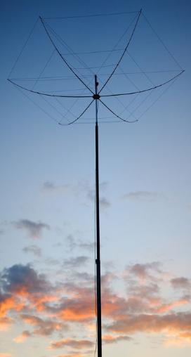

I forgot about Hex beams. Good choice for bands up to 20 meters with limited space and needing a lightweight antenna.
