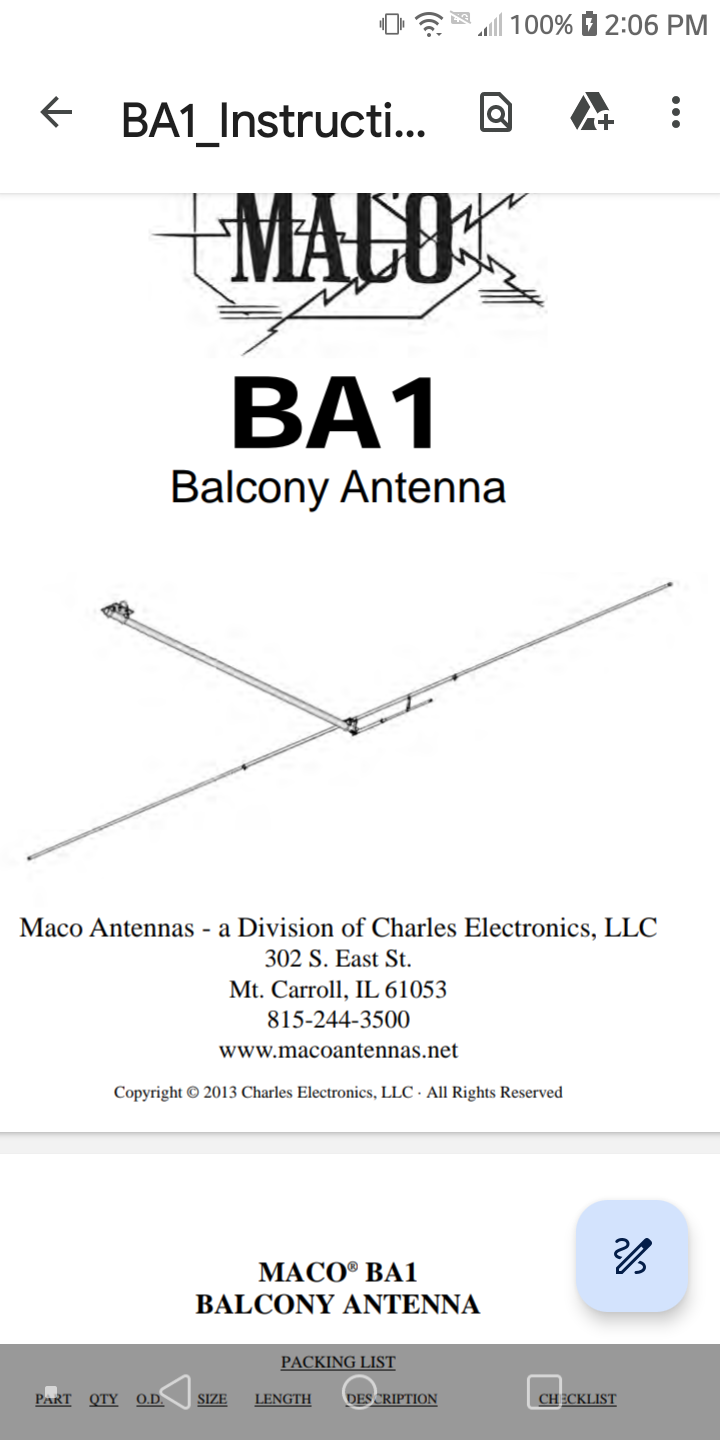

Simply put horizontal mounting is like this picture from the assembly manual.
Horizontal to the horizon.
And vertical mounting is vertical to the horizon.
Horizontal is directional and vertical is omnidirectional.
