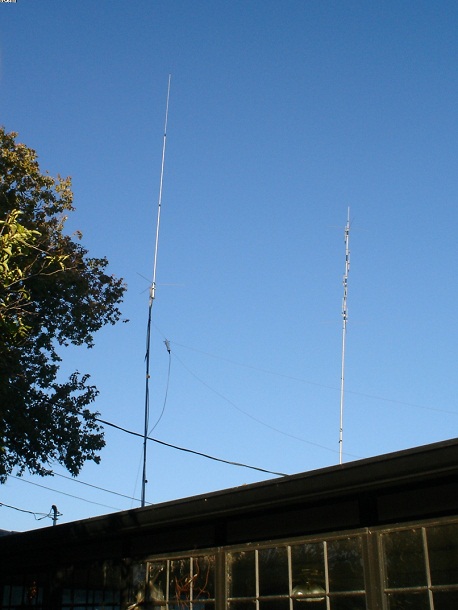

On 10 meters there is no down side less thsn 1% of HAMS use AM on 10 meters. DX is good right now on 10 meters you can work the world on 100 watts
You never know even on 2 meters what the DX gods will give you ....
