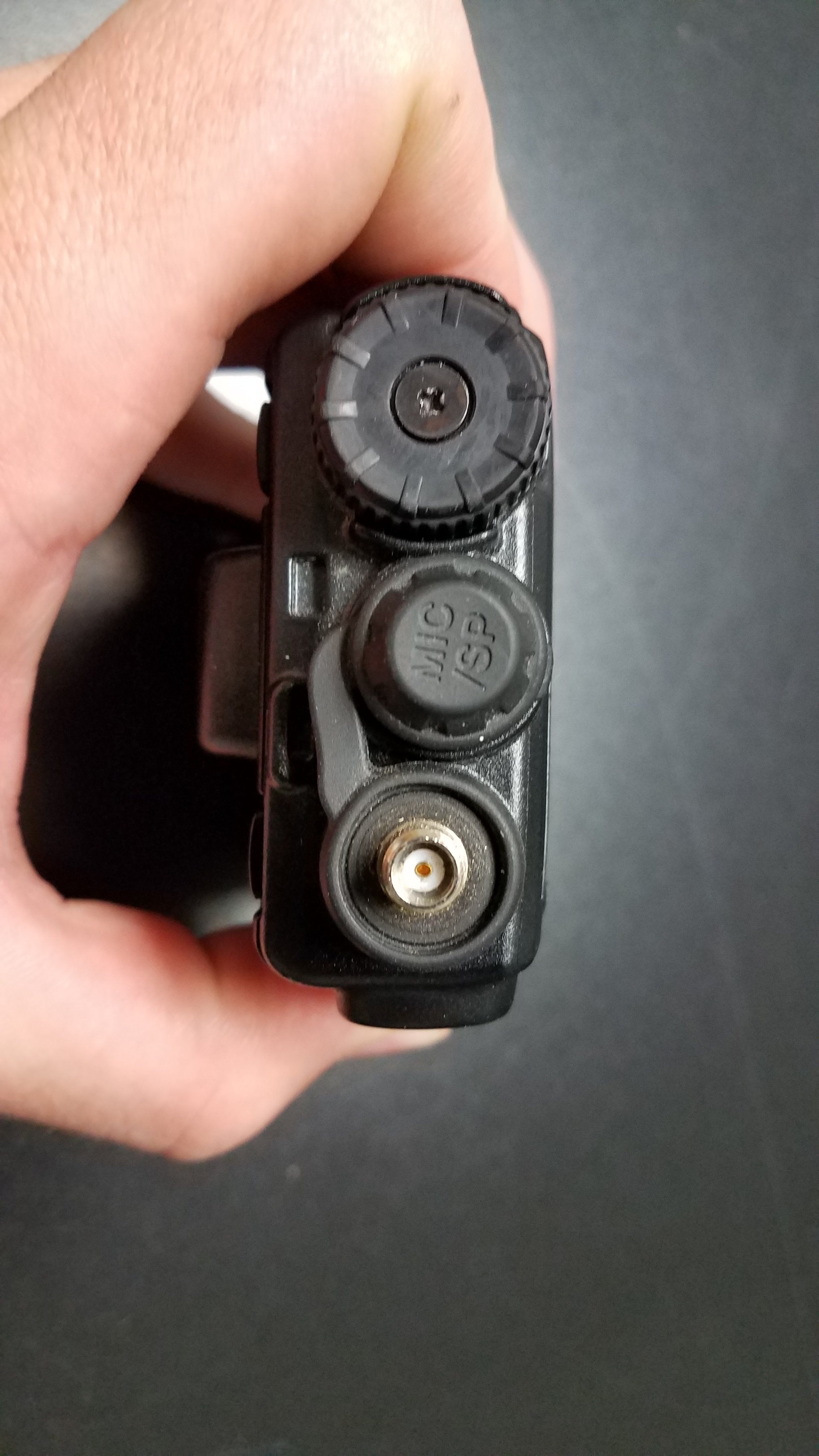

Hey guys I am new to HAM. I was wondering what the default antenna ports was called on Hand held radios. I believe its coax, but when I look up coax cables the connectors look quite large. So is there different size coax connectors like Type-1 or Type-2? I own a Yaesu VX-8DR "Witch I Love". Im asking this because I want to run an cable from the radio unit to my antenna. Like 3 Footer to put my antenna on the side of my bag through the pals webbing to hide it/ get it out they way.

That's an SMA connector. There are also hand helds with BNC connectors. Most Baofeng's use a female SMA, but looks like your Yaesu is a male. Tons of adapters out there to run coax to one, and it's best to use smaller, thin coax to your heavier stuff to avoid damaging the radio's SMA connector. You will probably need a barrel connector to put the two together.
