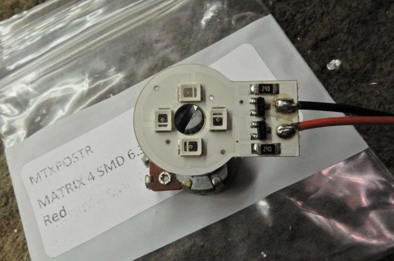

Here's the pinball-table "post light" with a 6mm control shaft. The hole is too small. Drilling it out would likely destroy the LEDs.
The company Comet Pinball doesn't post mechanical drawings of their stuff, so this is how we find out the size of the center hole.
Nothing ventured, nothing gained.
At least not this time.

My cheap chinese caliper says the hole is 4.5mm diameter.
I don't see a full 3/4 of a mm around the rim of the hole before it starts to cut into the plastic body of the LEDs.
