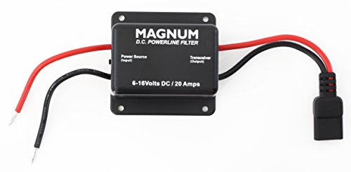

How about this filter....
Magnum XLF-20BP 20 Amp Common Mode DC Power Line Noise Filter
The word on filters of this sort is that voltage to the radio is reduced (without a great effect on noise).
I own one, but haven’t ever installed it.
