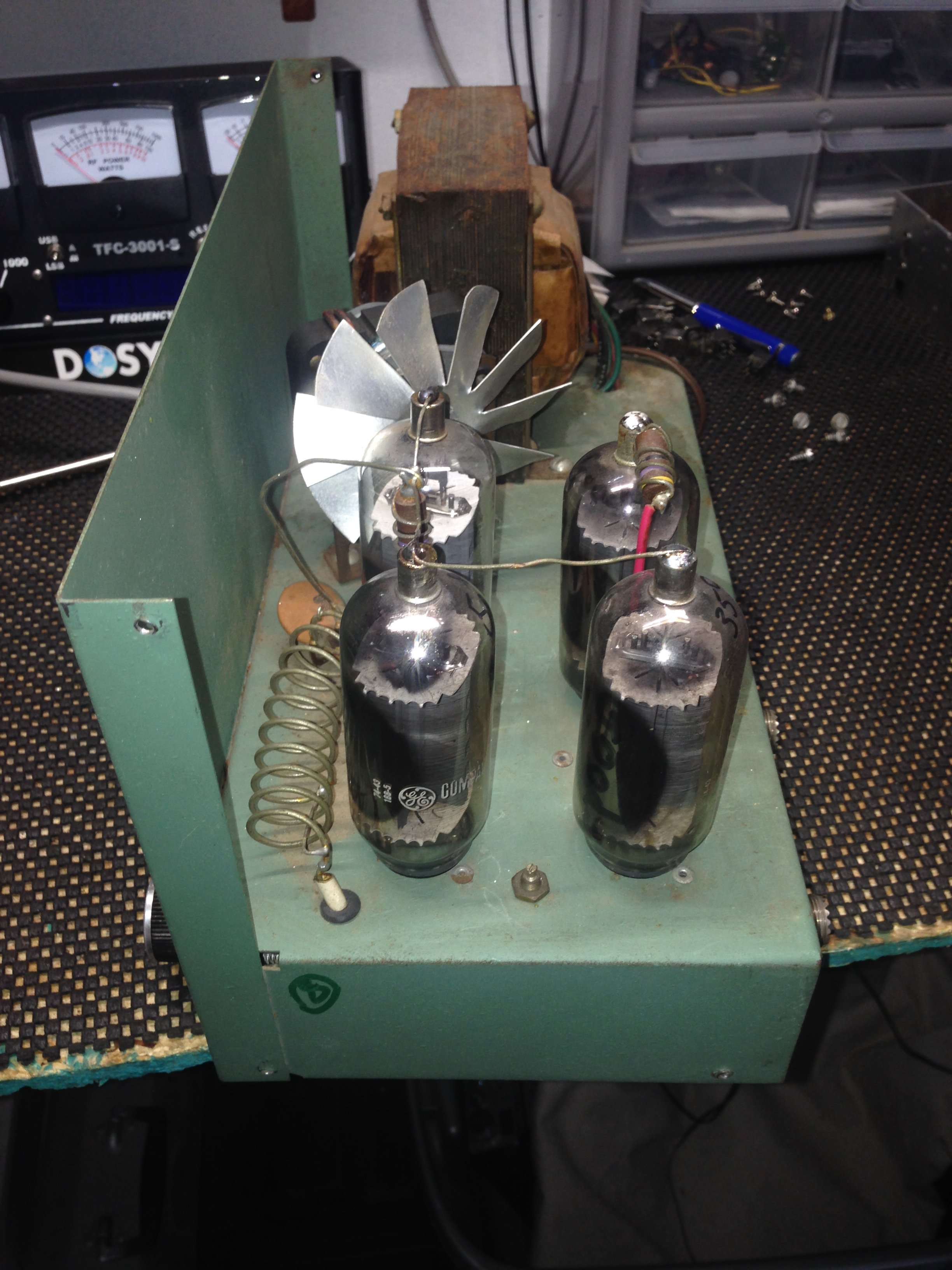

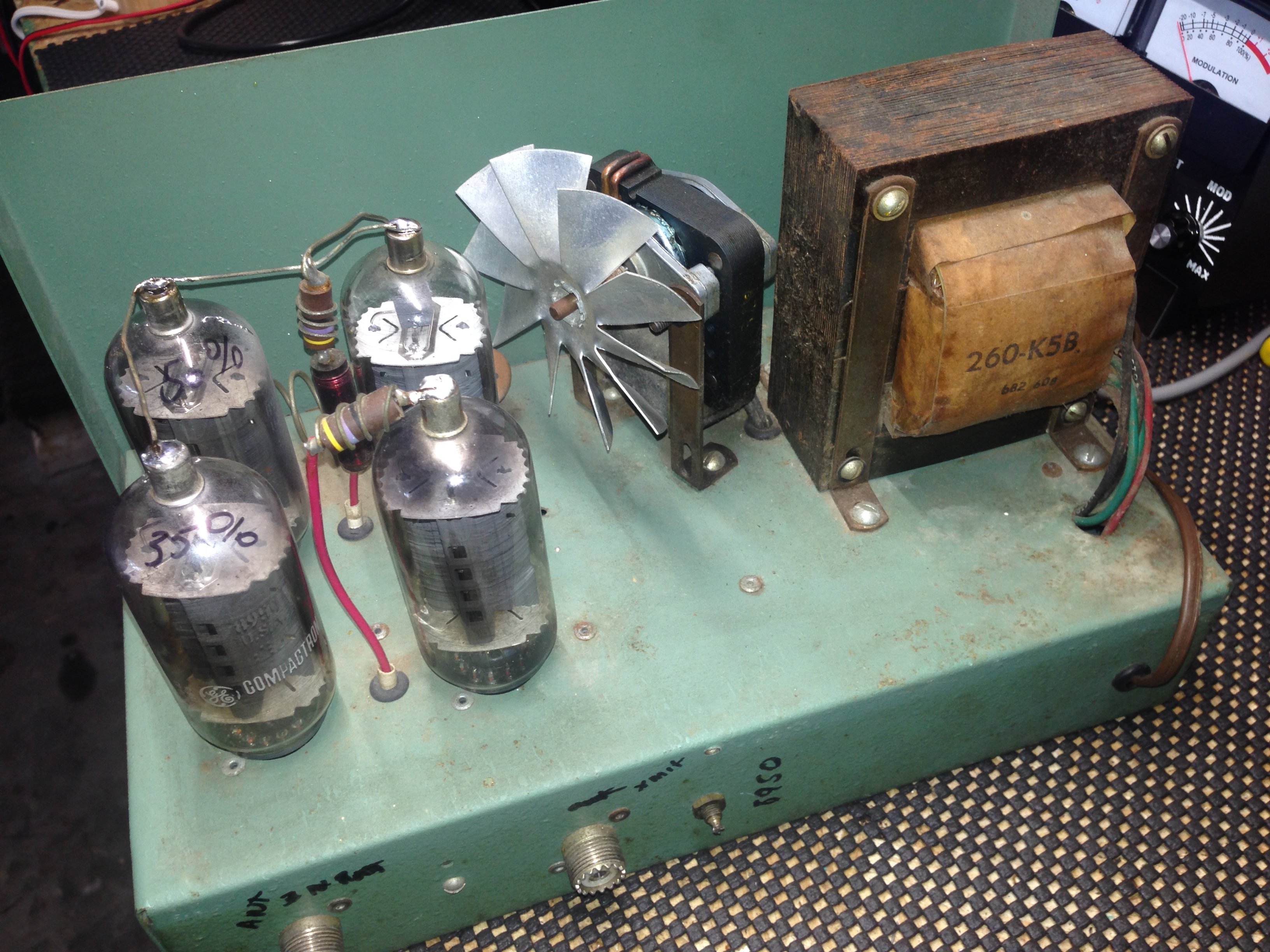

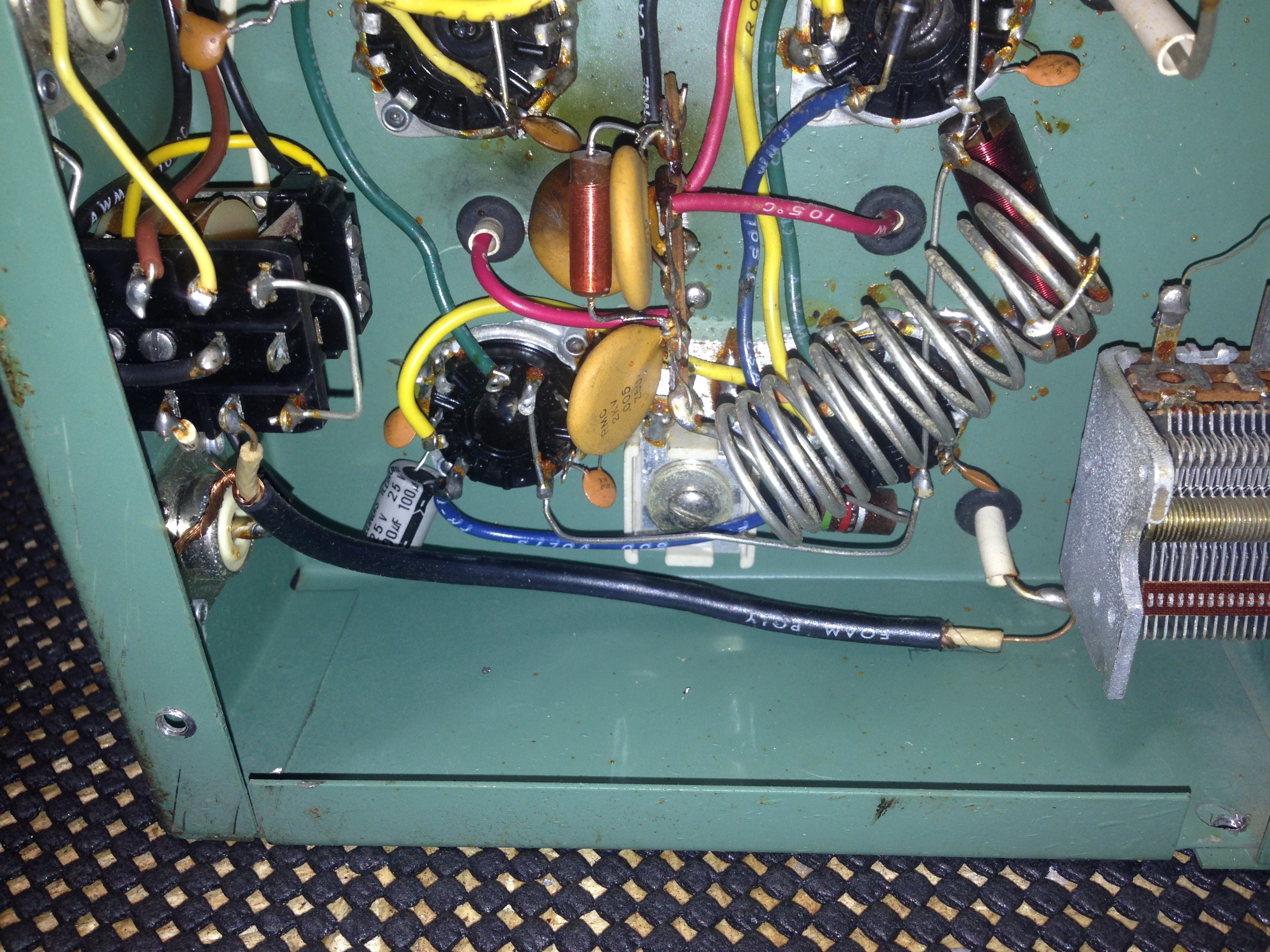

Hello all. I hope I'm posting this in the right forum. I am brand new to tube amplifiers. I've always run transistor amps and can get my way thru one of them decently. I moved to west Tennessee a while back and everyone here runs tubes. So when in Rome... ok so I bought a Maco 200 to learn on. Box still looks new! I had to recap it, as it had a bad hum over the air. After, audio was clean. But I had bad reflection. Swr was 1.2 with amp keyed on high and would swing to 1.7 or 2. Wasn't long one of the tubes was glowing. The plate I mean. And soon there after, shot sparks. Coincidentally, my swr dropped when that happened. Bought another 8950 and put it in. Let it cook, and keyed the amp to tune. Swr was back up. And after a while, it's plate would start glowing. There is a faint blue-ish light coming from inside of it too when I modulate. My question... I've got two tuning controls, I assume, one on the bottom back and one beside two of the final tubes. The one by the tubes will raise and lower the key and the one in the back doesn't really do much. What are their functions and how can I keep from popping these expensive tubes! Thanks in advance

The single biggest thing that would serve to settle down this model and make it behave had to do with the coax cable that runs from the Load control to the relay in the rear.
The shield on this coax is not connected in the factory setup. This turns that length of coax cable into a transmitting antenna.
INSIDE the amplifier. Causes a portion of your output power to "leak" back into the input of the driver tube. This causes RF feedback, the source of your unwanted 'extra' frequencies.
Simply adding a ground wire to the braid on that coax at each end has been shown to tame this amplifier at least some of the time. Ground it to the frame or the ground lug of the Load control at the front end, and to the "Antenna" socket at the rear end. Stripping 3/8 of an inch of the outer jacket to expose the braid at each end, then wrapping/soldering the stripped end of a hookup wire will let you ground the other end of the hookup wire. This will work as well as any method of grounding both ends of the coax braid.
Cheapest thing to try first, at least.
And if the clear plastic that insulates the center wire of that coax looks like it has been hot enough to soften and "sag", this will be trouble once it sags far enough to dead-short the cable's center wire to the outside shield braid layer.
You'll just need to replace that piece of coax altogether if this is the case. We got in the habit of using teflon-insulated coax for this purpose. Won't melt from the heat.
Just don't use foam-center insulated coax in this spot. It's even more liable to melt.

Could be AC getting into the plate of the tubes ? Take a few pics. top & bottom ?
