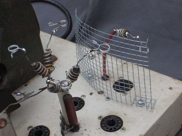

One thing that has helped stabilize twitchy Maco amplifiers is a shield around the driver tube.
Here is the same trick applied to a Maco 300. Much easier for this model. Only takes a flat piece of so-called "hardware cloth". Pretty sure the wires are spaced 5/16 inch on this one.
Wrapping a shield of this stuff around your single driver tube looks a bit clumsier to do. The plate-cap clip and parasitic choke would also have to be placed away from it. A short from either of those to your grounded-metal shield would be a bad idea. It doesn't have to wrap completely around the driver tube, but simply block the direct path between it and the three final tubes that surround it.
Might make a big improvement.

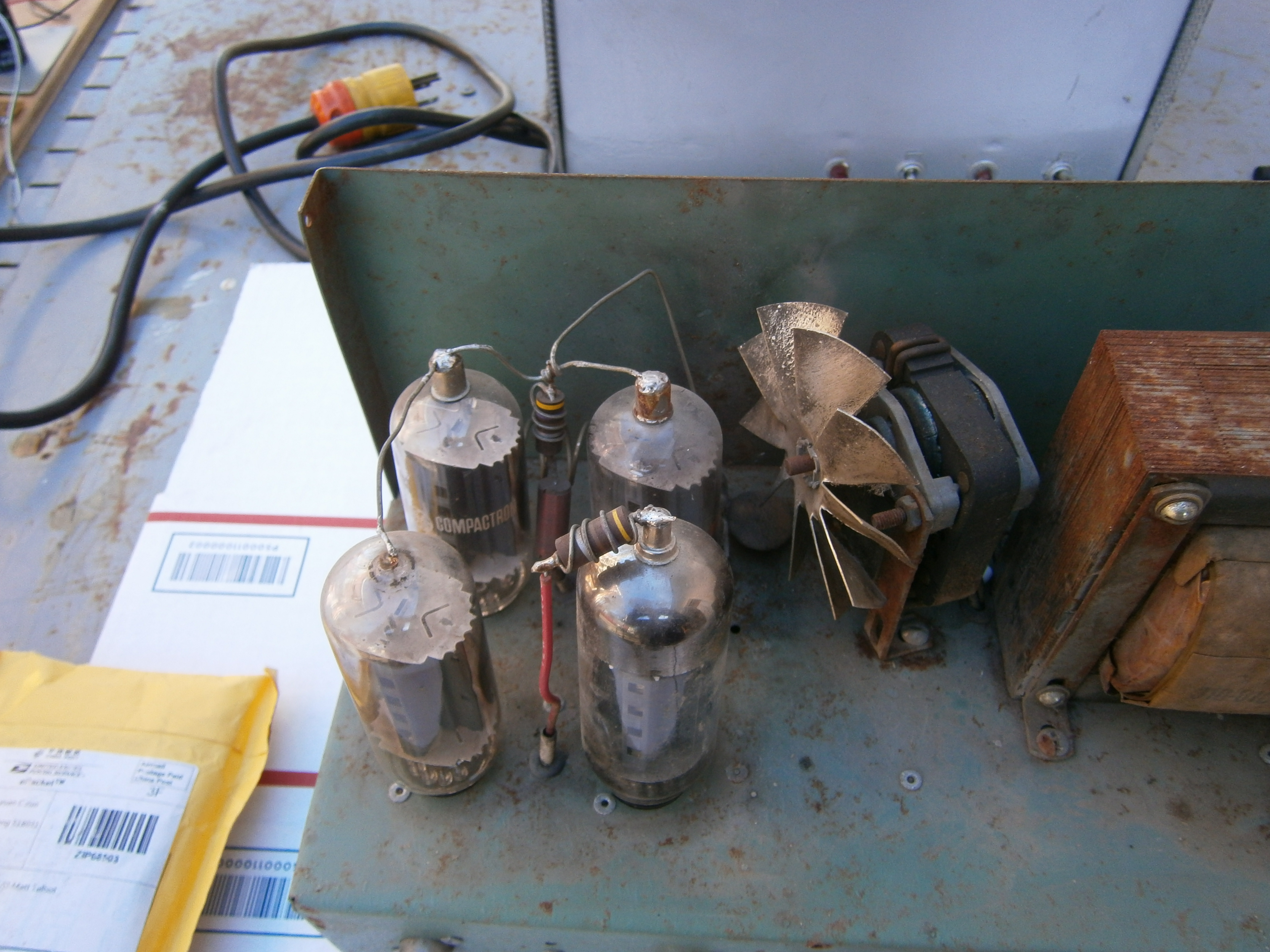

First thing that is apparent from the photo of the tops of the tubes.
Each vacuum tube must have its own parasitic suppressor.
That is the resistor connected to the anode/plate of the tube.
Not enough photos of the bottom. But. If I remember correctly.
The plate choke of the driver tube hangs down from the top cap "Anode"
just like on the finals. If this is the tube turning RED. Then I was right on that score
in a previous post. AC or better RF. RF is actually AC. But at a much higher frequency.
I guess. The plate choke of the driver tube could be in the chassis ? Well tomorrow
will find one of mine. With a complete Un-Golden Screw Driver-ed specimen.
Perhaps yours can be made to function properly.

Hi ! Thank U for ur recent purchase on the Maco 750 kit. It will be in the mail manana.
Finally found 1 of the 3 Maco 200.
Whoo. The last time used one was over 39 years ago LOL ! Did not find my first one.
It's
buried deeper in the garage in a box wrapped in plastic. This one. Picked it up a few
years ago at a garage sale/estate sale. $25.00. At least. two strong 80%8950's ! Am a
sucker for vintage tube gear at garage sales.
A lot of time has passed. Guess not a Newbi Golden Screwdriver anymore.
This box is CRUDE. Poor layout of tubes. Compared to the Palomar Skipper 300.
This is a poorly designed & implemented product electrically.
It is interesting how much it looks like yours !
After finishing the D&A 12 tuber promotion to Warrior. I will tackle these Maco 200's
This one had 1 6KD6 driving 3 8950. Neat "gimmick" with a diode to put approx 6.3
heater voltage unto the 6KD6 fillaments. The remodel of this unit will be.
1) Cutting out a new hole. Repositioning the driver.
2) Proper final tank coil. Possibly driver tank. Removal of the button variable capacitor.
3) 5-40pf small air dialectric variable capacitor. Like the Palomar Skipper.
Have several working Skippers. All I have to do is measure the Inductance of the tanks
on the Skipper. & roll my own. I will experiment by using 1/16 copper tubing that will be
plated with pure silver plumbing solder. Most likey the Iron in the Maco is not as Stout
as the Skipper. Skipper uses a separate heater/fillament tranny.
Parrasitic supressors on all anodes. & hose clamps. The clips on the tubes are just
garden variety hose clamps.
