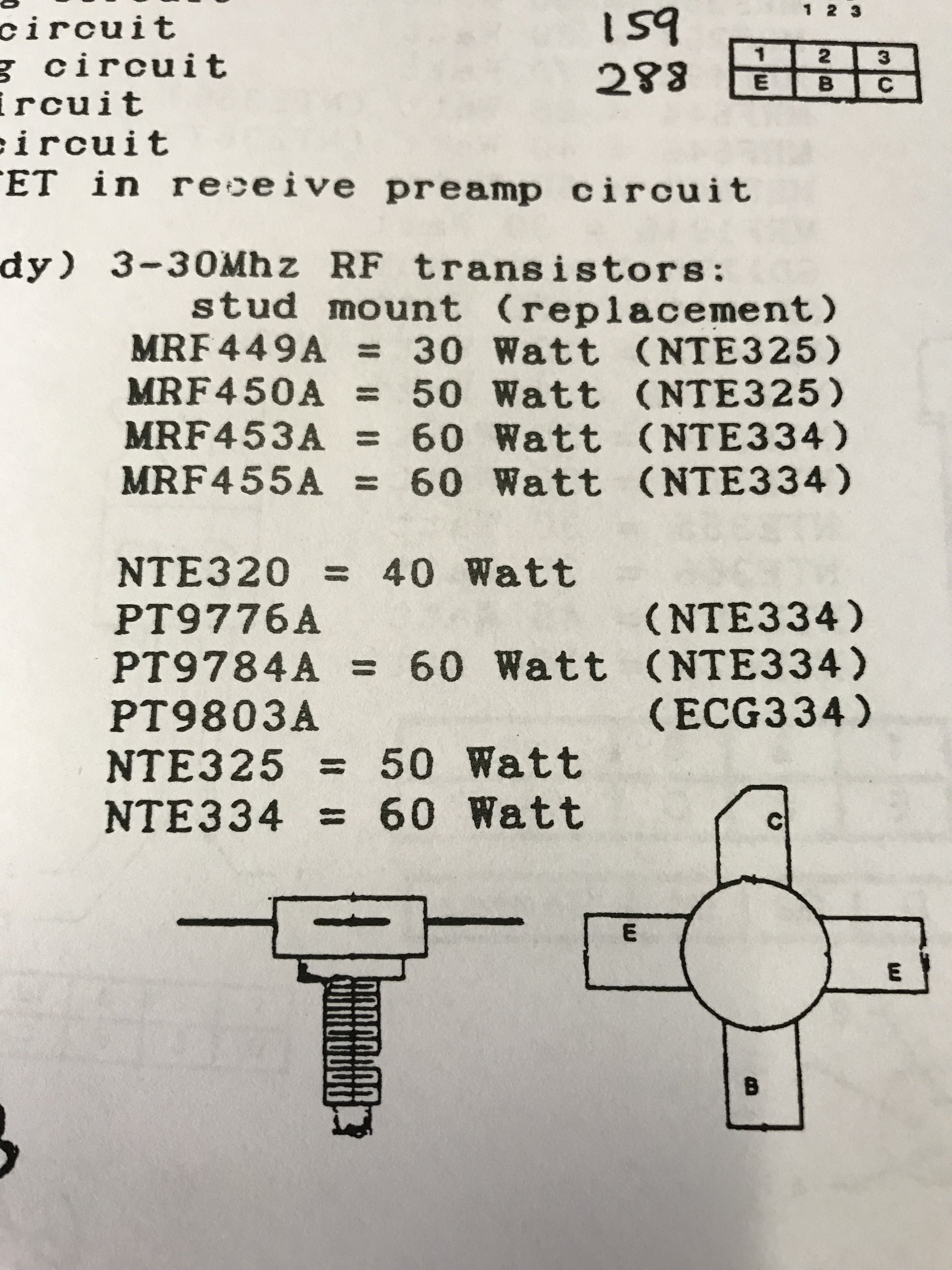

Oddball transitors.
I figured it may be a slim chance due to the age of the original part. But in the end, I guess a slim chance is better than no chance.
73’s
David
I just bought a similar amp that uses the same type for parts. It works just looks like hell so ill use them pills in my other one that needs them.
