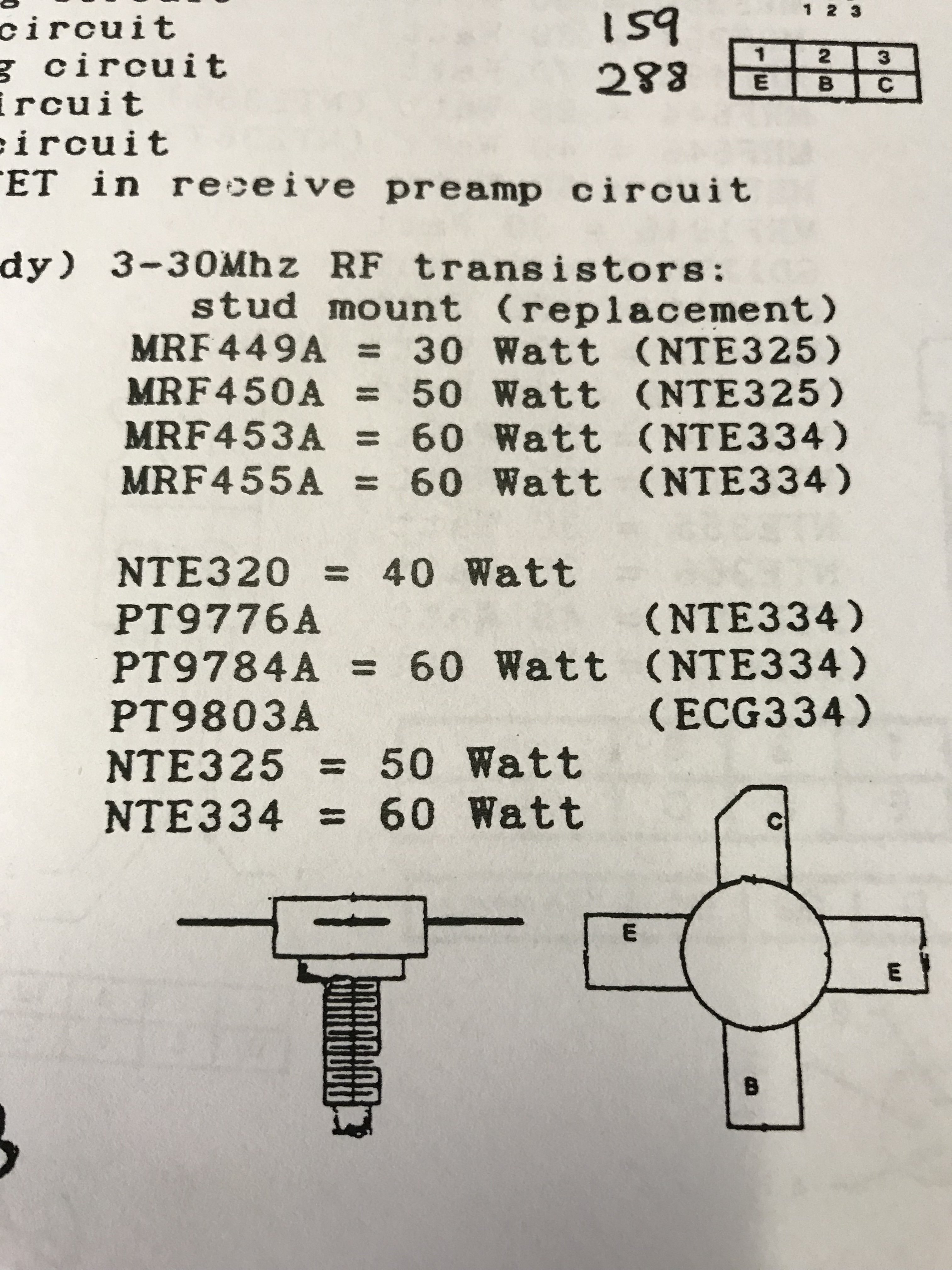

Mouser does indeed list the flange-mount MRF455. Not the same thing. A casual inspection of the circuit board will reveal that there is no way to make that part fit the circuit board. Not without gouging notches for the MRF455 mount flange.
The stud-mounted "A" part simply drops into the hole in the pc board.

Depending on board layout releaving the area for the flange and screw access may be a pain. This is the only reason to use the stud package. Electrically the non stud package is the same. Thermally the packages are different. correctly installed the stud mount package was to be a mild press fit in a coutersink with a nut/stud to retain it. I've only seen this spec used once i a Mill-Spec application. Still the flange mount, correctly installed has more surface area for dissipation. The stud mount has more possible area closer to the junction if countersunk.
Short answer ? mod for the flange mount BJT.

An older Book I have that can still be bought lists an NTE334 as a replacement for a MRF455A.
I cannot vouch for the accuracy of the information but the author of this manual has been in the business for years. May be worth digging into.
73’s
David
Reactions: Staybolt
NTE bought them and printed their own "cross-reference" number on parts for literally thousands of different components. When NTE can't get them any more they drop it from their catalog. The cross-reference guides live on long after NTE stops packaging a particular part and no longer has it available.
When the original-manufacturer's numbered parts become scarce, the NTE cross-reference "substitute" parts usually dry up as well.
As a rule, the NTE part will be the genuine Motorola part underneath the new number.
