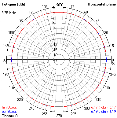

Anyway, some comparison models, starting with 80 meters.
Its not shown here, but peak gain for both is straight up... At this frequency, very comparable results.

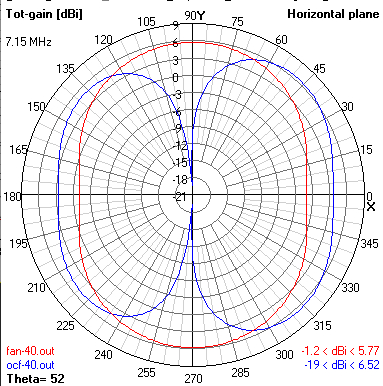

40m
Here we see a pattern form. The antenns are along the x axis, and the ocf feedpoint in to the left of the 0 point of said axis. The fan dipole's gain tends to be broadside of the antenna while the ocf dipole's peak gains are about 45 degrees out from the broadside pattern, with a deep null not quite broadside of said antenna.

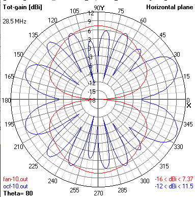

And finally 10m
The predictable fan dipole is more of the same, but the ocf is a real mess. Peak gain for the ocf is between 65 and 70 degrees off of broadside.
You could literally have these two antennas up side by side and have contacts on either that the other will have trouble pulling in. In some cases, one will get you more contacts, and in others the other one will, it simply depends on the antenna layout, and the direction said contacts are at.
In real world installs where I am limited by a few trees, I'de go with the ocf dipole. If I am using frequencies that are high enough that I can mount the antenna on a rotor, I would go with the fan dipole for the predictibility.
