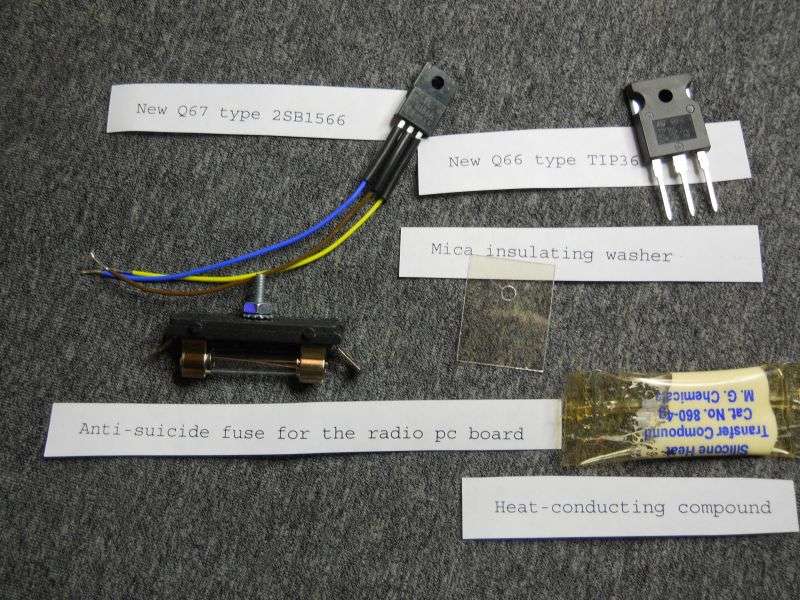

Got a PM here about a failed RCI2995DX radio. Typical shorted Q66. Sideband transmit is fine, but AM gets you a monster carrier with no audio. He replaced Q66, now nothing. No sideband, no AM at all. The transistor that drives Q66 is Q67, a surface-mount power transistor. When Q66 fails, the one driving it tends to get sideswiped and fail. Yeah, it's only rated at 2 Watts, but technically it's a power transistor. Trouble is, it's a pain to replace. Just removing it tends to damage the foil trace. We use a plastic power transistor and bolt it to the heat sink. Wires run to the pc board. My idiot light came on while I explained it to this fella when I realized it would make a reasonable fleabay item.
Haven't settled on a price. Gotta put ten of them together before I post it for sale.
This is how it mounts and wires up.
Can't leave out this detail.
Film at 11.

We replace Q67 using a TO-220 PNP transistor with the plastic mounting surface. Current choice is 2SB1566. I'm sure there are others, but I haven't researched it. Saves the trouble of putting an insulated washer under the new part. We put a teflon-insulated wire on the new part's leads. They will reach to Q66 and to the main circuit board and take the place of the croaked SMT part.
It mounts in a random extra hole in the heat sink near Q66. The brown wire (collector) and yellow wire (emitter) go into the gap under Q67.
The collector wire (brown) from the new Q67 lap-solders to the center pin (collector) of Q66. The emitter wire (yellow) goes to the base lead of Q66, the lead nearest the rear of the radio.
The blue wire from the base lead of the new Q67 will go to the component side of the main pc board.
It goes to the center leg (collector) of either Q65 or Q69. Can't remember which of those this one is.
So far this has done the job when both Q66 and Q67 both fail.
And when the foil under Q67 is damaged, you can't just replace the original part where the old one went.
Something we have adopted as standard policy when servicing this type radio is to install a separate fuse to protect the radio circuit board. You wouldn't hook up a 5-Amp mobile radio to a 30-Amp power supply with no fuse, right? But that's what the factory put inside this cabinet. A fuse for the circuit board could minimize the damage when Q66 fails, or when IRF520 final transistors fail as a short.
We call it cheap insurance.
The kit for this operation isn't up on Ebay yet as of 2/21/23, but that's the plan.
